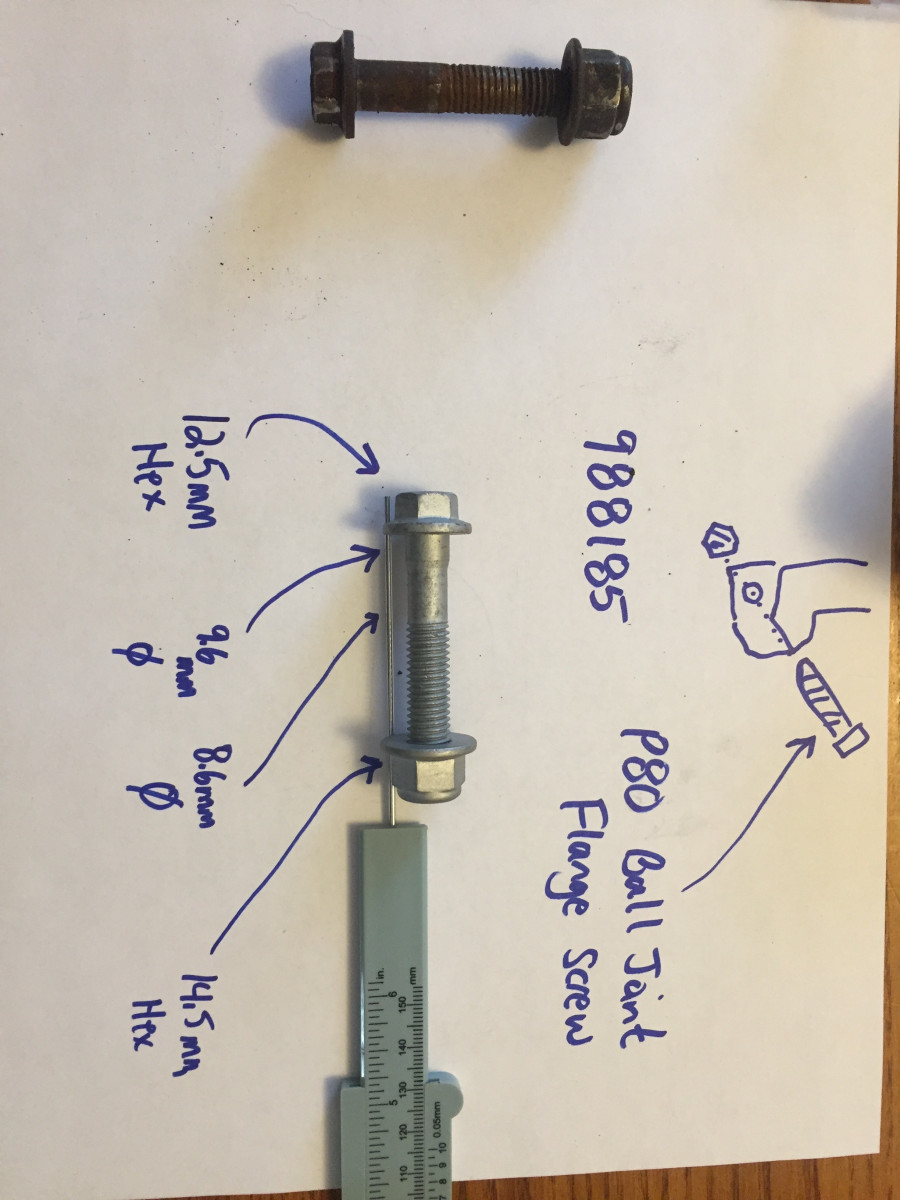

P80 ball joint nut/ bolt 988185 987891
- Posts: 36145
Here are the measurements on the Volvo piece, different than what I measured upthread

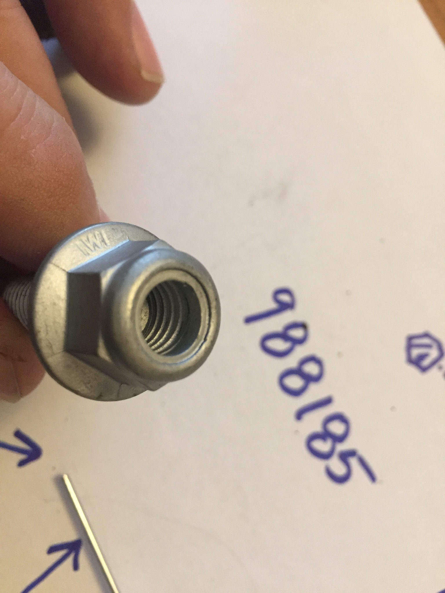

- Posts: 36145
Here’s the locking part of the nut that makes the nut single use.
