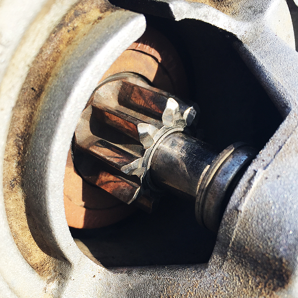

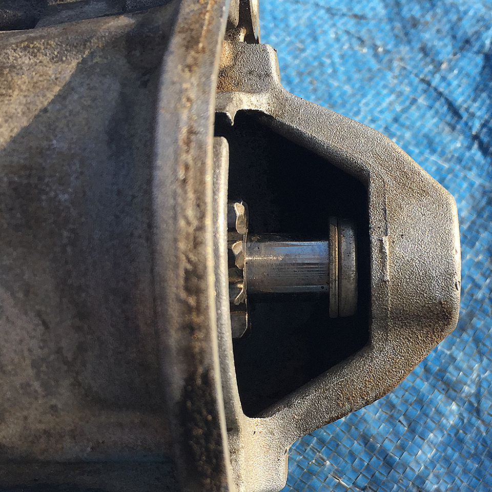

Two photos of starter motor pinion.

Did you apply grease on the shinny portion of the shaft? Is it accessible without removing it?
Posts: 36140
Joined: 17 Feb 2013, 17:54
Has thanked: 1609 times
Been thanked: 4064 times
You will have to remove the starter to lube that shaft; it's buried in the flywheel housing.

Steve is right.
The install of starter is such that the visible gear in the photo faces away -- towards the bulkhead -- and it slides into the engine opening where the flywheel sits an inch inside -- like pencil in a sharpener.
The starter motor must be removed for servicing. Do not remove the starter from the bracket mount, instead unscrew the mount itself from the block. You can see the one mounting screw from the spaces between intake manifold.
The gear would finger rotate only clockwise with ample resistance, but won't slide over the shaft with a pull -- that is good. I sanded the rust spots on casing and painted with high temp stuff for some longevity. I liked the wight of it, heavy -- the protective casing was rock solid.
I recommend this service, but brush clean, remove all the dirt and spray brake clean before putting a wrench on it. No force is required, nor you want to arm wrestle -- once unscrewed rotate it out. Watch your wrist and elbow for connection, sensors, hoses, and wires.
It will hurt your back a little, take few breaks in-between to help yourself.
Again, a much quieter and softer sound of start.
