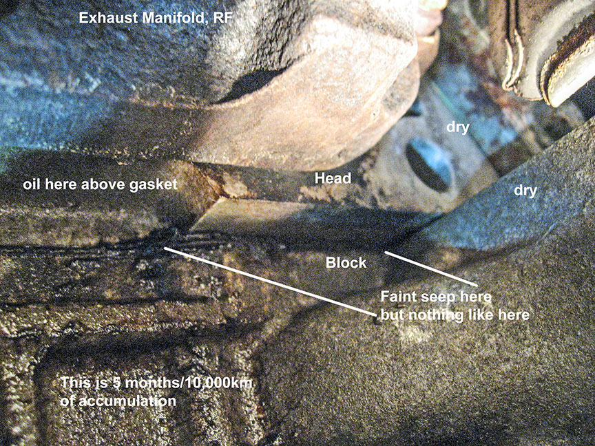

Not getting better with time. This is about 10K km/ 5 months of accumulated oil spillage - actual amount less than 1/2 litre.
This is not coming from the top seal, timing cover or cam seals. Probably not PCV - engine vacuum tests OK. No apparent evidence of oil uphill from the block. It seems to be a leaking head gasket. Is there anything else it could be? Something cheaper to repair? Yeah, I know, it could be a cracked head or block, too. btw, my post title is incorrect - the leak is actually front/right side of engine ie: corner nearest the right side of the car (passenger NA model)(front) and side nearest the firewall (right).
- Oil-Leak_0328.jpg (141.62 KiB) Viewed 3313 times

More photos of the crime scene.
If the oil were finding its way along the head gasket seam from the exhaust cam front then there would likely be a lot more drip & seep closer to the front of the engine and not as much where it is, right?
What's curious here (to me) is there appears to be a bit of oil uphill from the head gasket. Just wicking, maybe?

Update May 31, 2016: Still no definitive diagnosis. The engine is still seeping oil from the same two spots or finding its way to the same two spots before running down the block. No oil appearing anywhere else. The seep doesn't seem to be getting worse or better. 1,500km since the last oil change and no discernable loss of oil on the dipstick. No loss of coolant and no contamination visible in the oil or coolant. No steam, no smoke, running fine so none of the classic symptoms of a blown head gasket (yet?). At least one mechanic said it's almost impossible for the head gasket to leak oil and not coolant which seems logical. The only place oil is under pressure past the head gasket is through the journal at the left front corner of the engine (NA passenger's side closest to the headlights) so for oil to just seep past a head gasket is very odd. Any other good guesses as to what it might be other than the obvious $3000 answer?
