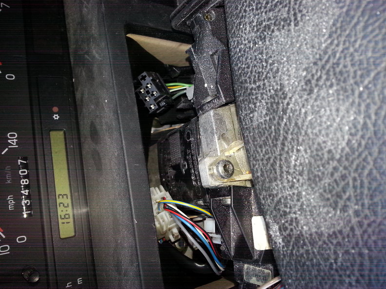

Post a pic of the black harness at the steering column.

zandershope_

These cars are wired for most all accessories at the factory,
even if they don't ship with all the bells and whistles. That
connector looks a lot like one that would plug into a dash
switch for an accessory that you don't have.
I'm still thinkin' bad ground at the headlight and turn signal
grounding point or maybe some nasty leftovers from a poorly
installed/removed aftermarket system.

Who ever had it before us had a system in it theres a power wire connected to the battery but i took the fuse out of it
