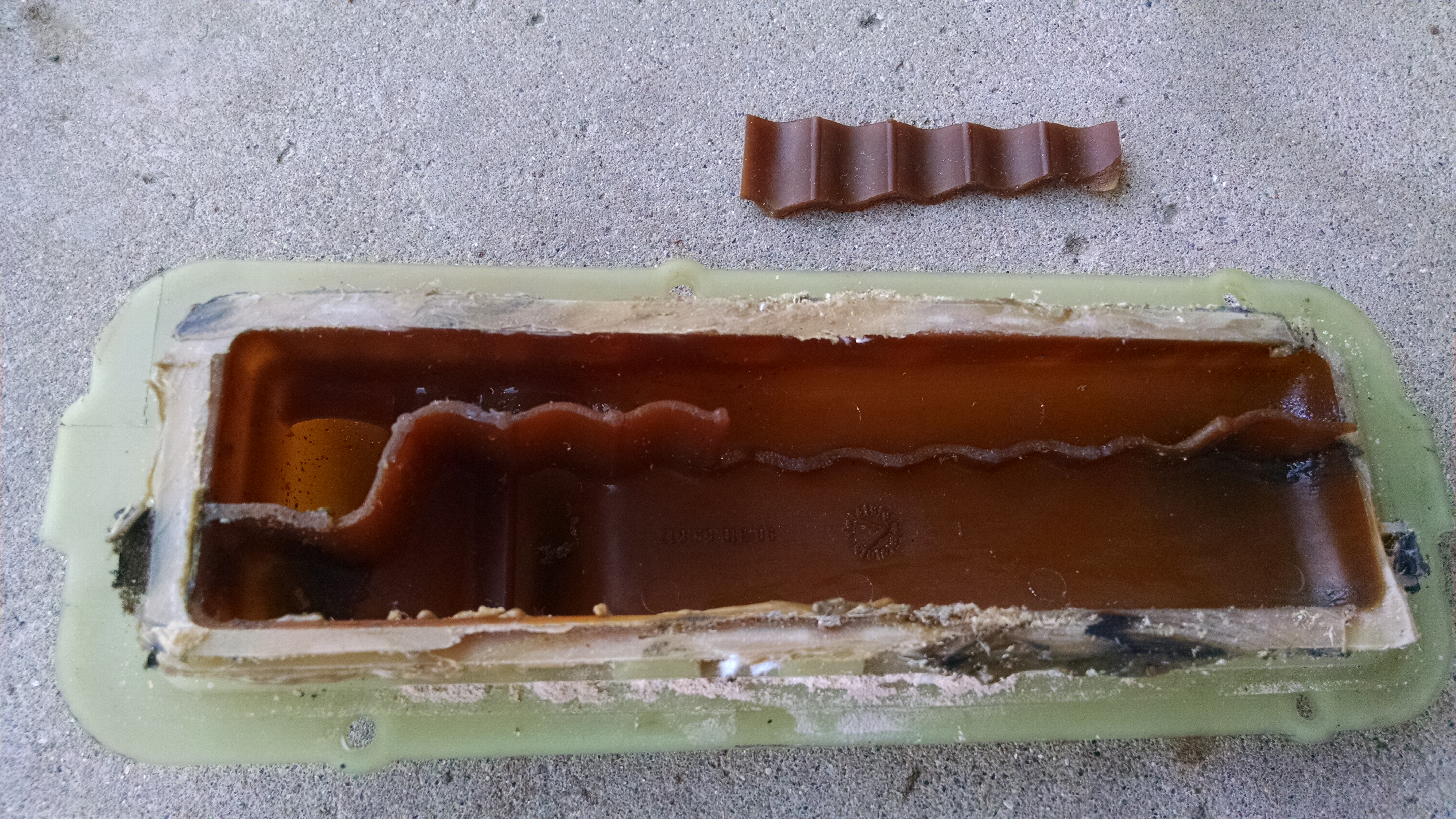

Installed the core tonight. It definitely seems to have solved the problem! I have good heat now, just in time for winter.
On a side note: the air side of the old core was perfectly clean, not even a spec of dust on it. From this I can only assume the division wall inside the coolant end is rotted away. Makes sense now that I think about it... Running the engine RPM up gave me heat for as long as I kept it up. This must have increased flow through the core and forced a little coolant up through the tubes. Then when flow returned to being lower, the coolant would just flow in and back out through the rotted wall, bypassing the tubes. I intend to cut the old core open when I can catch a little spare time to confirm this...
Thanks again for the help!
Spenser

Cool...I mean...hot! Will be interesting to see the guts of a core and see the wall problem in the flesh.
