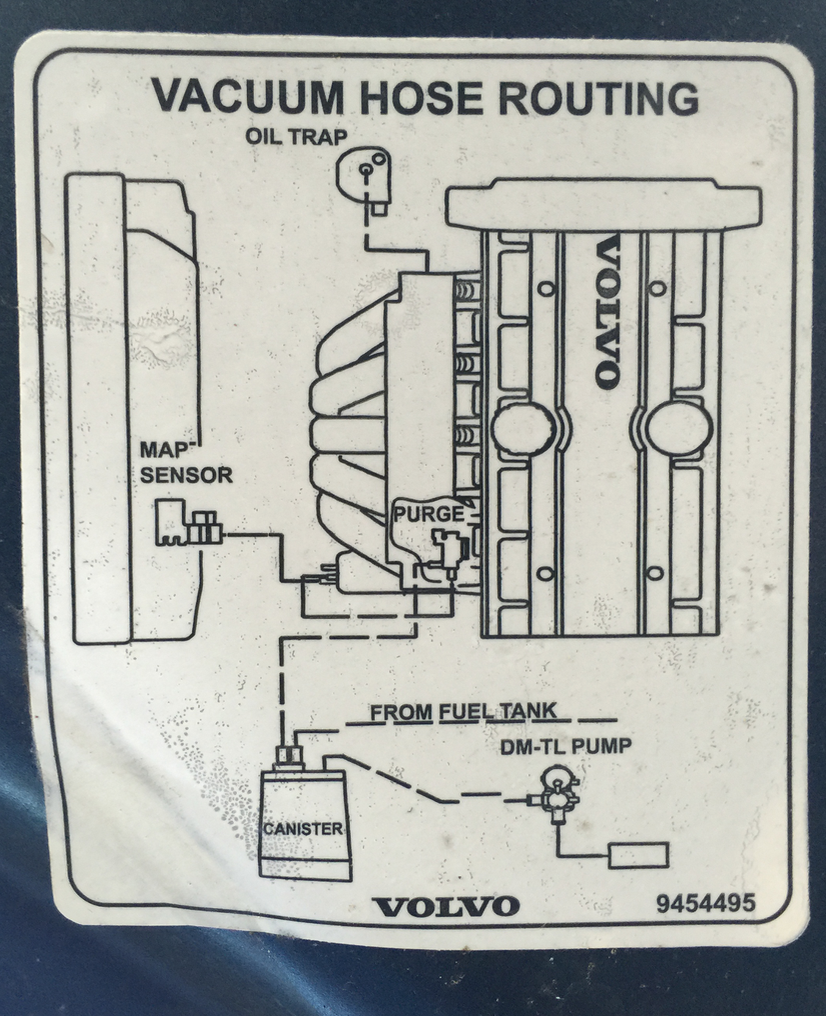

Snap a pic of the diagram under the hood and post - it will look like this ...mine was under hood - right near driver door on lowest part of hood
Yea, I saw a sticker like that at the bottom center of the hood. It has to be from the intake to the oil trap. I was in there feeling around again trying to follow the hose with my had, and it popped the other end off also. But by the looks of it, its pretty dry rotted and needs replaced anyways. Looks to be about 4 or 5mm internal diameter maybe and about 8" long.
Going to go to the local auto parts and look for a suitable replacement. Now, can anyone tell me where the intake hookup is. I cant feel it and I dont know exactly where it goes.

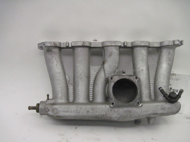

Most likely that like is a replacement line used to connect the port from the underside passenger front side of the intake manifold (bottom side) to the heated oil trap line that runs from the oil trap box to the PTC. You may have (not sure) blown it off with the pressure situation you created.
Start by opening hood, feel under intake on passenger side front for large bolt. Connection is on opposite side facing the back. The only other line that size fits on the driver side . There is a little brass connector facing the engine. It is on the backside of the intake tube that goes left to right and connects all five runners. Open hood, place hand on driver side front of manifold. Roll hand to backside and find brass fitting. Usually easily found. Its the other side that's tricky as it tucked over the power steering pump.
Here is a pic to help
