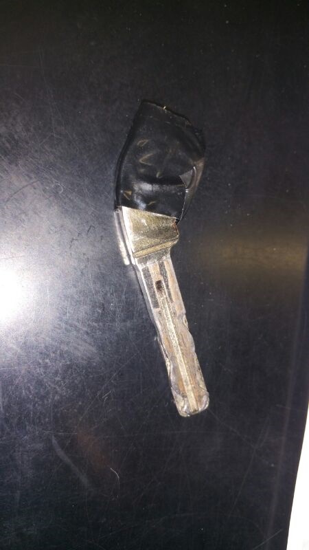

The photo was provided by Doublebug. I went the new keyhead/old blade route. I guess drill size will become apparent once you have a new transponder chip in your hand.
When a new keyhead arrives you can practise the assembly multiple times without glue. I can post ùp a video on the assembly as it will save some time working it out. The factory keyheads are so well made that they will be demolished in order to remove the blade; there is no saving them. In my case I taped the transponder to the old blade to do the programming, then dealt with keyhead assembly later.
By the way you will likely lose the old transponder codes on the CEM so it's best to order 2 keyheads or 2 transponders so you can have 2 remotes as per before this problem.
You can have as many keyheads as you like actually. The remote board's function is just to unlock doors......so you can have spare keys just for starting if you want to have more blades cut at a locksmith.

A 'How-to' when you get time would be awesome for me and any others who may be crazy enough to try this. We do still have one good key and transponder. I'll order the replacements today.
I apologise though for still being dim, but if you drill the old transponder out of the original, why do you need to replace/break open the original at all? Is it because the drilling is not successful in getting the transponder out, so you have to just destroy the old part to remove the key and then build up the 'replacement' either way?
Many thanks for your help as I know you are a busy man!

Old transponder cannot be reprogrammed. It can be used only with car it is programmed for. Plus Immo codes also should be the same as in time of programming. So when info is lost or dealer cannot get immo reloaded with original codes the only way not spending many $$ is to program new transponder. So old one should be removed or programming of the new one will fail. You need to be sure that old one is broken and there is enough place to put a new one.scot850 wrote:I apologise though for still being dim, but if you drill the old transponder out of the original, why do you need to replace/break open the original at all?
If you have questions about Volvo firmware ask me. I may know an answer

Hi Neil. I would always have a plan B in case drilling doesn't work or damages the keyhead, hence the keyhead with transponder chip from that seller.
As I have never done the drilling method I can't say it will work for all. If you have a spare keyhead you just simply demolish the keyhead, remove the blade and build it into a new assembly.
One thing is for certain though; original Volvo plastic is better quality than anything from China at the moment.
Yes as Henry mentions one of the aims is to remove the old transponder and/or have it as far as possible from the ignition barrel as possible during programming of the new transponder.
Let me know on this thread when the keyheads arrive and I'll try to post up a video on reassembly.
