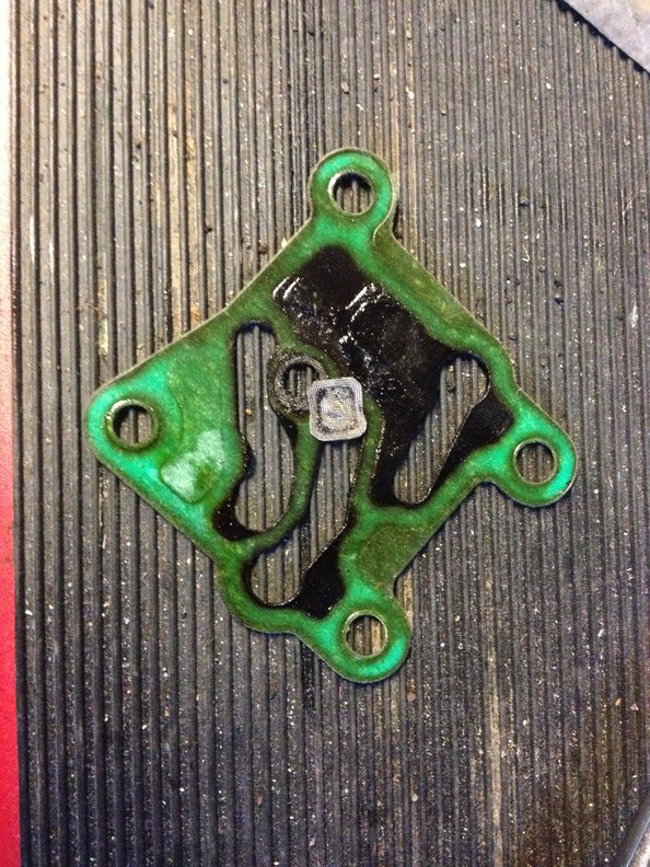

1. Have you serviced your PCV system?Madijain- wrote:P0016. Correct me if I'm wrong but thats the Crankshaft Positioning Sensor Bank 1 Sensor A?
2. What oil are you running in your car?
I have 2 2007 XC70s - one I have owned since new (188,000 miles - #1) and the second I purchased at 129,000 (#2). #1 was factory maintained up to 100,000. We used Castrol conventional in the car and the PCV system failed completely by 120,000 miles.
I purchased #2 in November of 2015 and it was a mess, with multiple codes and multiple oil leaks. The car had originally been serviced with Castrol conventional, then switched to Mobil 1 and then back again to conventional oil. The PCV system was completely blocked.
In both cases, replacing the PCV system fixed most of my problems.
With your car, I would start by pulling the CVVT solenoids and checking for deposits/clogged screen. P0016 is intake I believe. The solenoids are located on the top of the motor, front (passenger) side, right above the CVVT timing gears. You have to remove the front top cover (2 torx ?) and 2 clips. The solenoids are held on with 4 cap screws (10mm I believe). You can unclip the wiring harness/plug and take a look and report back. Depending on maintenance, you may find a clogged screen in the gasket, which will impede, but not stop the flow of oil to the solenoid, which controls the CVVT. As I understand it, the CVVT circuit is mostly used as a means of smoothing out the idle/emissions during warm up, so a malfunctioning solenoid can make the car run poorly.
Here was mine out of #1 - threw the same code. The screen was blocked and it came off the gasket when I tried to clean the debris. I replaced the gasket and the code went away after about 80 miles.
More importantly, if you find a lot of sludge in the motor, I would start evaluating the PCV system and probably replace it before you have more related troubles and also switch to a good synthetic motor oil and more frequent oil changes to start cleaning up that motor.

VIDA/DiCE shows two specific timing codes if it can't adjust VVT. I forgot which ones, but they differ from failing CPS (which often is not reported).Pittsjock wrote:Here was mine out of #1 - threw the same code. The screen was blocked and it came off the gasket when I tried to clean the debris. I replaced the gasket and the code went away after about 80 miles.
