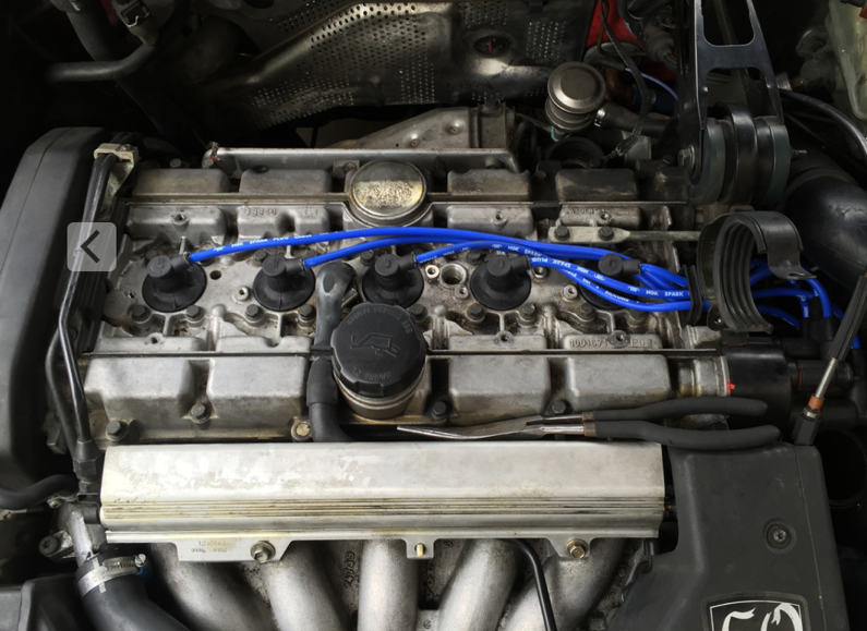

Wondering if you were able to get this figured out. My car recently started to do the exact same ting with the same code. I changed the plug wires and checked the cap and plugs. The cap and rotor looked fine and the plug in #5 didn't look wet, but I regapped it and replaced it. A trick I tried was to swap plugs on cylinder #5 (misfiring) with a plug from another cylinder to see if the misfire moved with the cylinder, indicating a plug issue. Well, I regret to report that it didn't work. I am still getting the P0305.adbalt wrote:Just wanted to give an update. Took me awhile to get back at it. I recently changed the oil filler cap and that solved the problem of the oil leaking onto the top of the plug wells. I changed the distributor cap, plugs, and wires. Although the car runs great it still sets a P0305 code. Not sure why but for now I'm going to continue to drive. Only issue other than the code being set off is a rough idle when stopped. Not sure if the code and rough idle are related. Anyway thanks for everyones help and any ideas feel free to let me know.

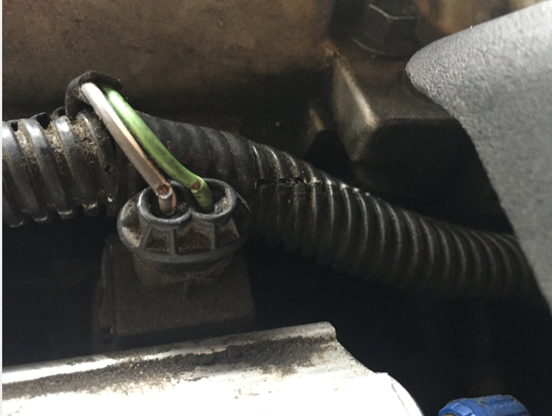

I did notice damage on the wiring harness leading to plug #5. I could see the copper as the insulation had been rubbed through. I taped it up with some electrical tape, but it wasn't the problem. The code came back.
I'm scratching my head a bit. If it's a head gasket or valve issue, its gets real tricky as I don't know if I have the patience or time to do this myself. At the cost of a head re-build, I am not sure it's worth it on a 245K mile car. I'm going to have my daughter drive it a bit more and then I'll do the compression test in the near future. We will see how it goes.
