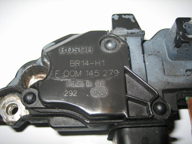

I ended by putting a 05-09 alternator and swapped the 03-04 regulator

Updating this, I kept the 05-09 alternator (came off a 2005 model) completely with the 2005 regulator. Interestingly everything works fine on a 2004. The regulator was changed from 2005 on with a modified internal design which seems to work on 2003-2004 engines.

Oragex, I have the same alternator, Bosch 8676498/0 124 525 029/140A, on my 2004 S60 2.5T. Since the alternator seller on Amazon does not ship to Australia, I want to buy a voltage regulator from Fcp Euro to see if it fixed my problem. Can you tell me the voltage regulator that works on your car so I can order the same one from Fcp Euro?

This is the original regulator that came off my 2003 alternator. Note my car is a 2003 n/a automatic with 140A alternator (I have read that the alternator depends on the transmission type, not sure if it's true).
The paper in the link seems to indicate that regulator #8637851 is the same as #F 00M 145279
