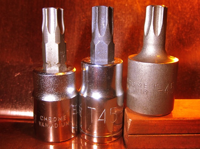

There are many different ways of loosening the T45 bolt... I just wanted to offer up one method that has worked for me.
T45 torx bits
T45 torx bits
The short T45 on the far right is from a kit of three (T40, T45, T50) available at HF for $4.

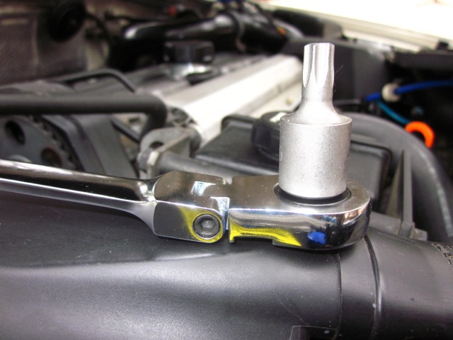

HF T45 'short bit' on slim HF ratchet
The slim HF ratchet with a 'short' T45 bit works pretty well. I put a small pry bar behind the ratchet to press and hold the bit firmly in the T45 bolt.

I was at HF, asked for that type and we could not find them, I'll try looking it up online and get an
item number to try again. I have been using a pry bar but it is just difficult to get it all in there.
The T45 is not going in very deep, seems like only 1/8" or so.
Thanks very much!

Be really careful with the T45, you don't want to strip out the head.
I use a pry bar to lever in the torx, really crank it in there, then the pipe to turn it. It should not be very tight ... keep at it!
