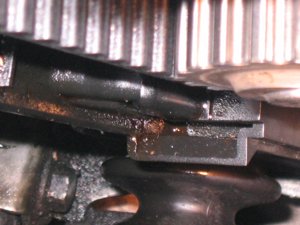

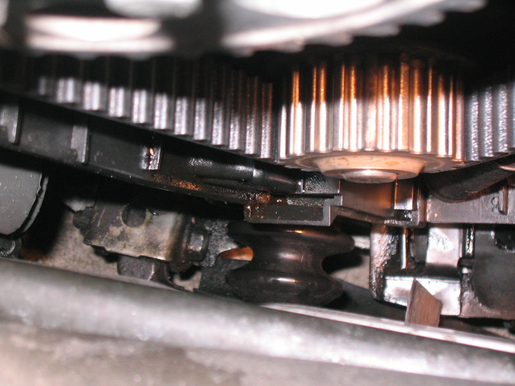

Here's two photos of "coolant on the shelf" mentioned above:
Is there a "lower weep hole"?
