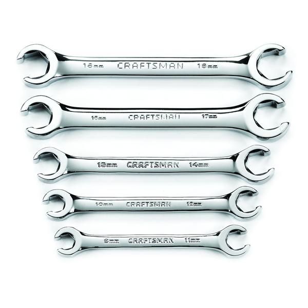

If you're not using a flare wrench in order to save money (what other reason could there possibly be??), then you probably don't want to buy a flare tool ...
I have Craftsman flare nut wrenches, moderately priced and have been very good to me on rusty brake lines.
These http://www.sears.com/craftsman-5-pc-fla ... ockType=G1

I own the exact same set, sooo worth the money.
Why struggle with vise grips and risk messing up a fitting?
