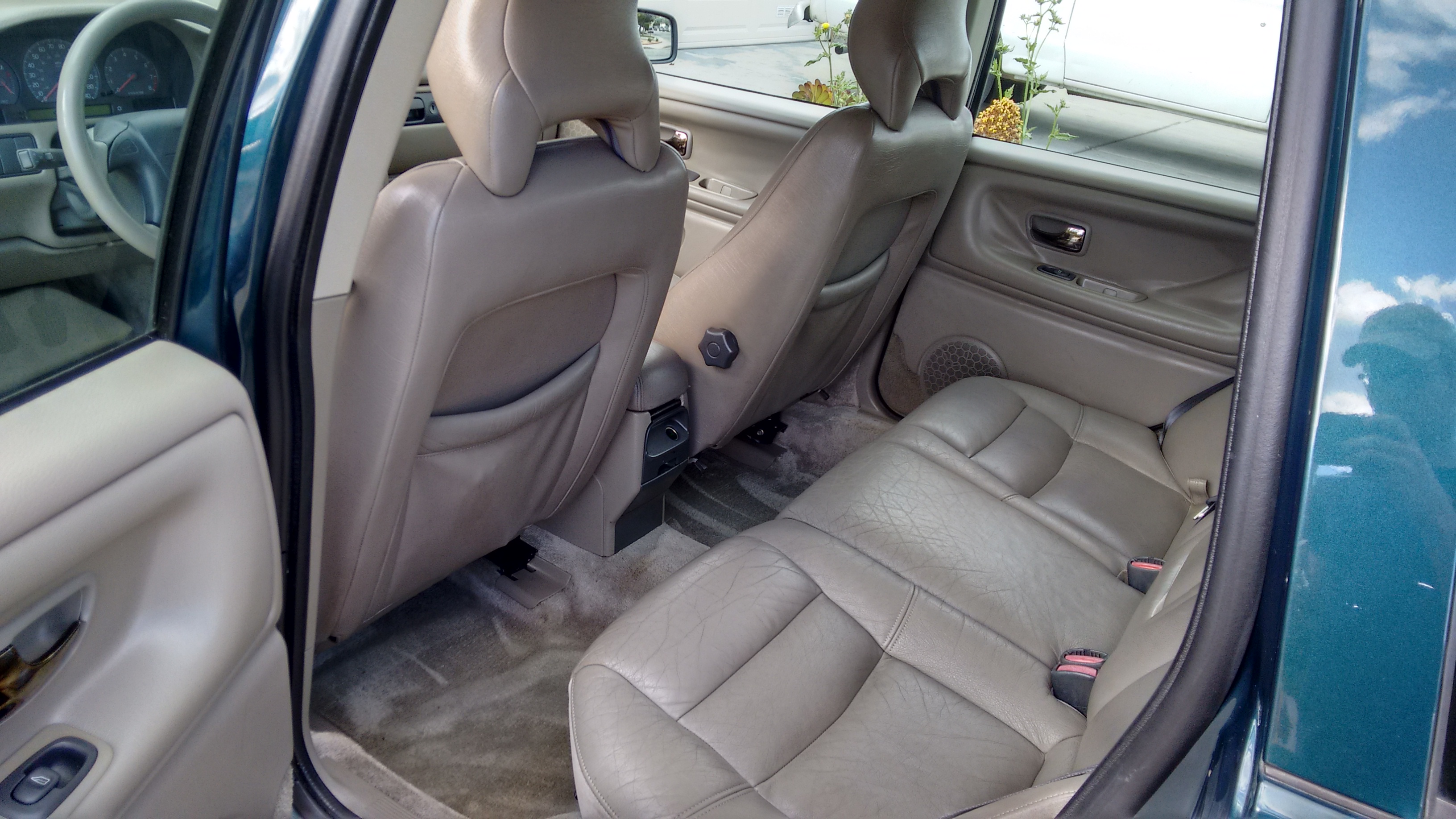

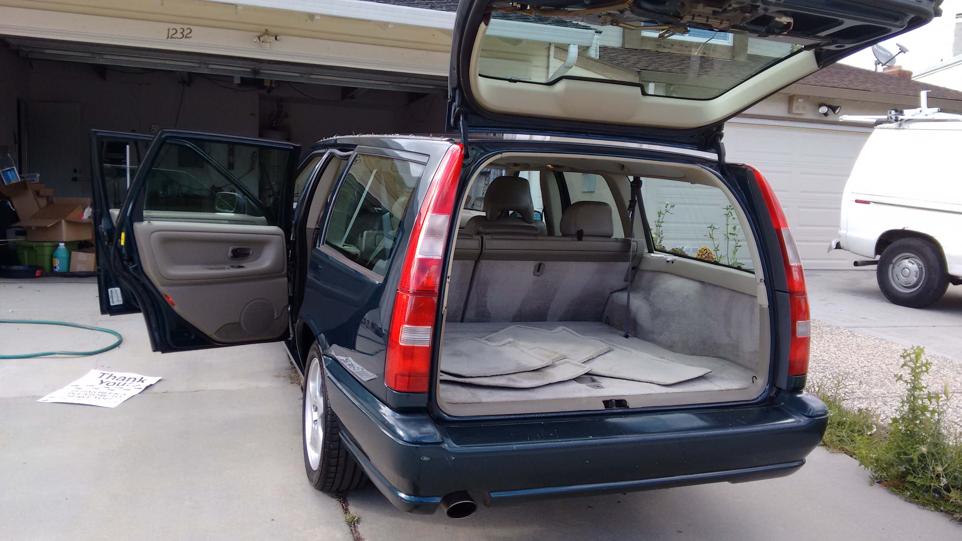

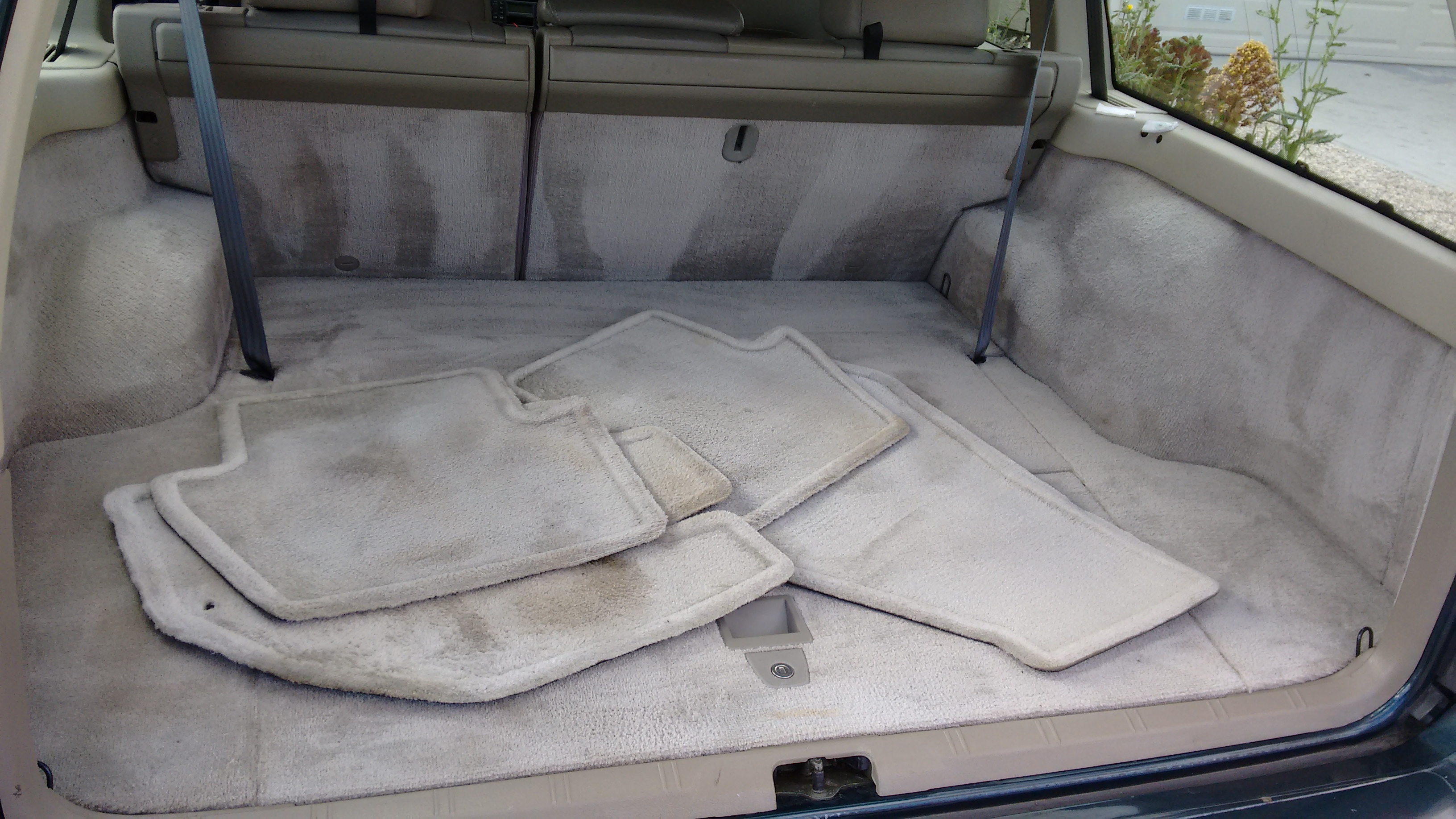

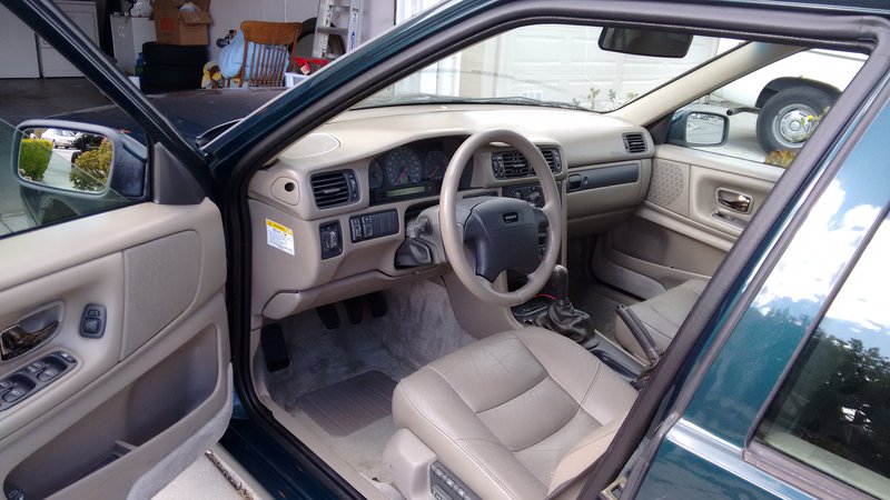

I had the V70 detailed today at a place in my neighborhood. I had them focus on shampooing the carpets. They also did a once-over of the interior and exterior panels. I think it came out pretty well. (I wish I had some "before" pictures to show the difference.)
After:
