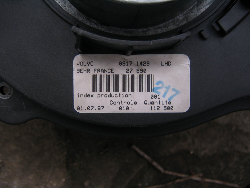

OP, can you post a pic of the blower motor on your car?

Sure. Perhaps tomorrow.erikv11 wrote:OP, can you post a pic of the blower motor on your car?

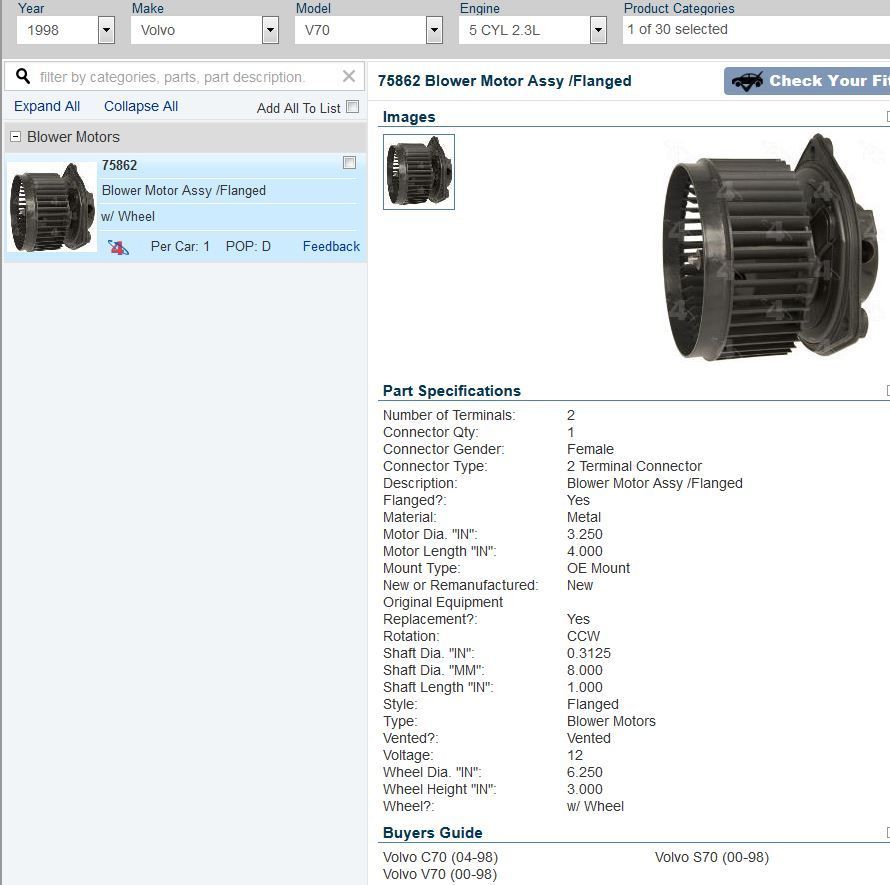

Took the motor to a local old-school shop that has catalogs & lots of AC/Delco stuff, but the number didn't come up. So the guy thumbed through a 4-Seasons catalog, looking for something close. Turns out they have a matchfor a NEW assembly:
Amazon sells them here from Midwest Auto: 4-Seasons Blower for $69.

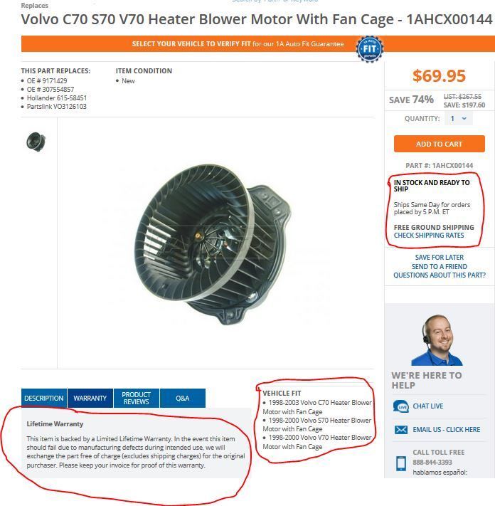

Also found this from 1A Auto. Looks like the same part, but with a lifetime warranty.
I like the new construction, lifetime warranty and reasonable price. Not sure where they're made however.

1A Auto imports these from overseas, has them made for them. I have 60days to return it for a full refund. After that, it's new part....for life! At least they're willing to back their imports with a lifetime warranty....beats 30 days!
AutohausAZ's URO motor is $121 with a 24-month warranty.
I didn't like what I read on Midwest Auto's fine print. Rather restrictive to say the least.

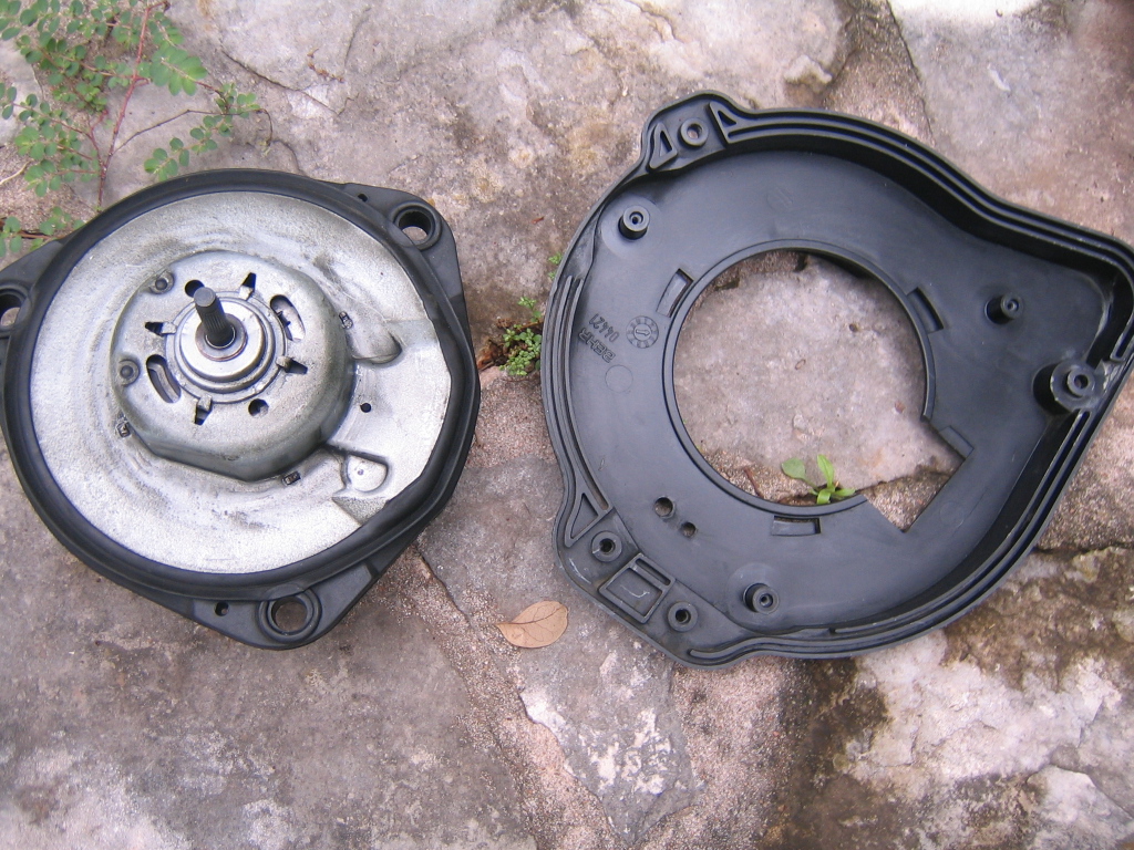

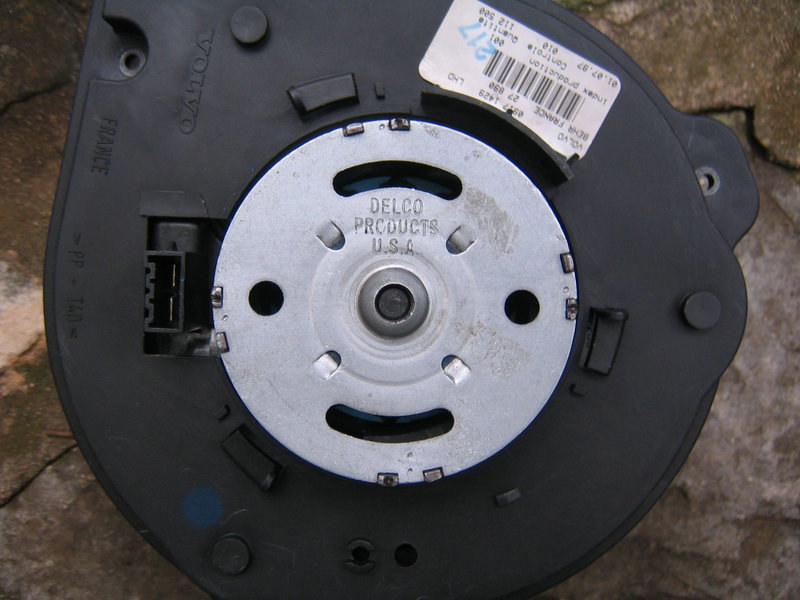

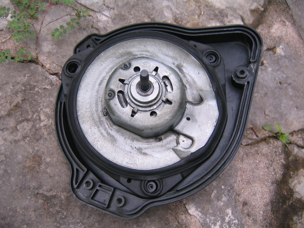

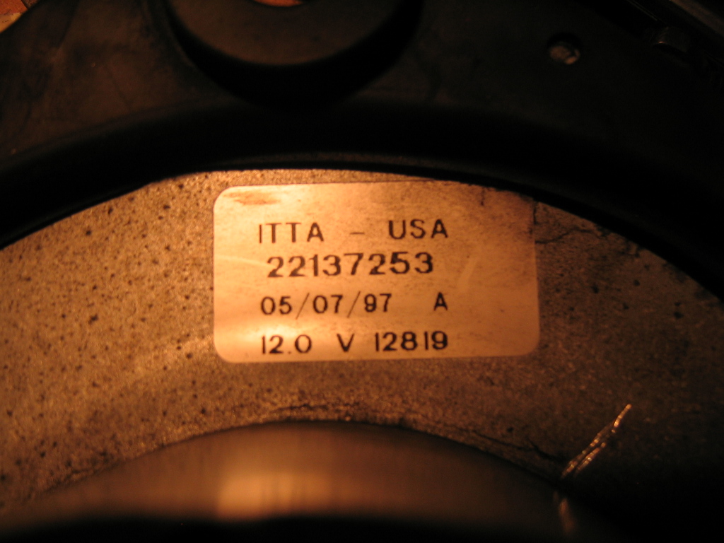

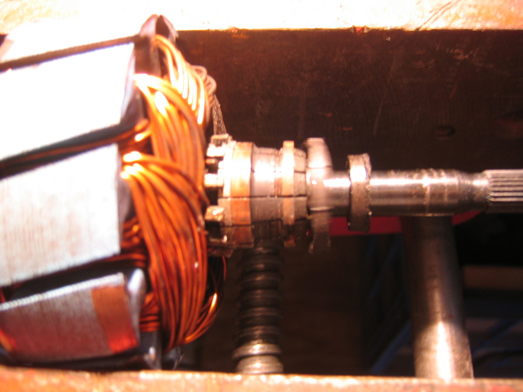

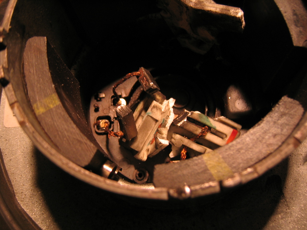

Here are the requested photos:
Notice that the commutator has been severely reduced in diameter where the brushes made contact. Compare & contrast to the untouched copper just to the left. This one is Tango Uniform. Here you can see just how short the brushes are. This motor finally failed on Sat. I pulled it today, applied power from my bench supply and it wouldn't spin. Measured winding resistance through the outside terminals at 70 Ohms. Way too high. It hung in there for 19yrs though...being nearly constantly on in CenTx Heat & Humidity! So I can't fault the motor, nor Delco at all. It's just flat worn out from use.
Local shop with the 4-Seasons catalog didn't have this one in stock and said it was a "special order".
