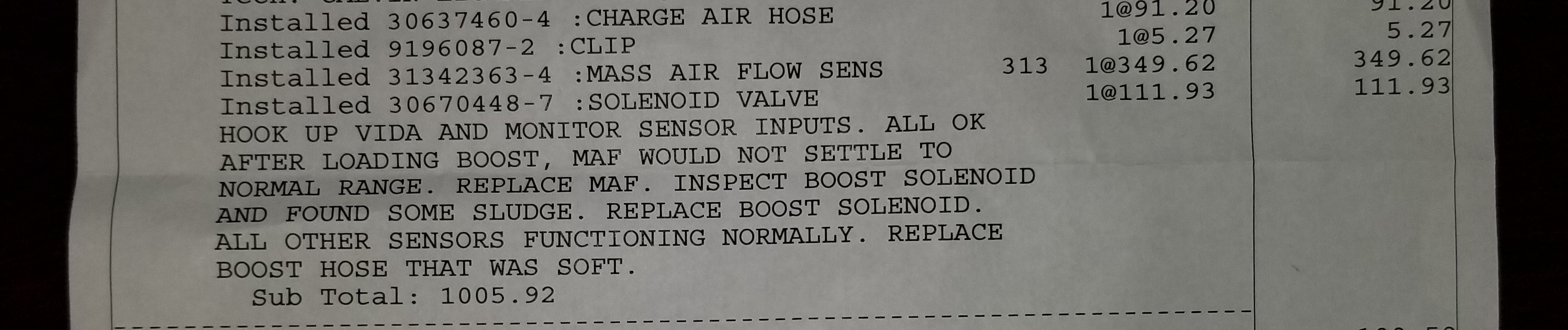

850 does not have a ETM like my car and OP's car. If the Old TB cars like the 850 are completely different. The ETM is expensive to replace, so why risk damaging a working one with Seafoam?Sommerfeldt wrote: 23 Apr 2020, 05:02 There's a lot of very rigid opinions going on here, without much sources in sight.
As for performance, I'd expect better response (my 850 reacted well to a clean TB), and if your MAF is going, you'll have other symptoms than, or in addition to, sluggishness, contrary to what June says.
- S
The ETM has a cleaning procedure specified by Volvo that will safely clean it and it does not include Seafoam.
Here is the section of the bill for the MAF. During the time it had issue the car was fine on one take off, then sluggish the next, also I forgot to mention when it was acting sluggish the transmission would stumble and I was getting like 12 mpg. June

OP has also been warned several times that the ETM can be somewhat sensitive, though my understanding is that this is mostly in regards to degreasers (water based being the worst?), which Seafoam isn't. Spraying it through the TB while the engine is running will also not deposit or soak the TB or components in it.
If the MAF doesn't work right, it leads to a lot of symptoms. Mostly the engine will run rich, since that's the safe way for it to handle a missing MAF input, or input that doesn't make sense. So you'll have all the things that come with running rich, though your transmission issue was likely your engine stumbling, not the tranny.June wrote: 23 Apr 2020, 10:36 Here is the section of the bill for the MAF. During the time it had issue the car was fine on one take off, then sluggish the next, also I forgot to mention when it was acting sluggish the transmission would stumble and I was getting like 12 mpg. June
Also... a new Bosch MAF for your car should be about 110-130 USD, shouldn't it? Not 350...
