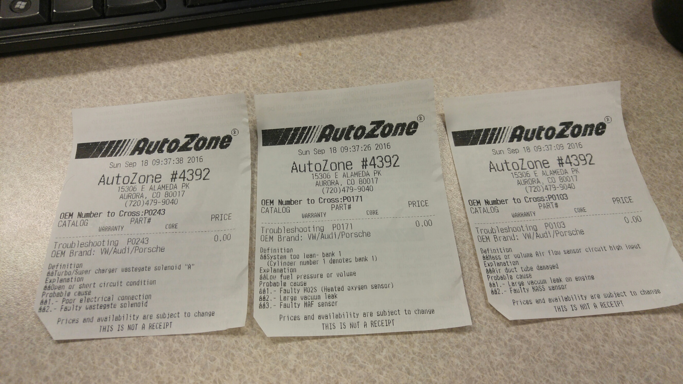

DavidB
Posts: 16
Joined: 11 September 2016
Year and Model: 1997 850
Location: Aurora
Post by DavidB »

Post by tryingbe »
Bad MAF sensor or vacuum leak for P0171 and P0103.
Look for torn hoses, loose hose clamps, broken vacuum lines, etc.
