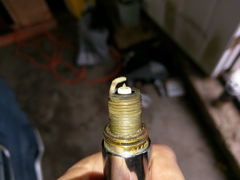

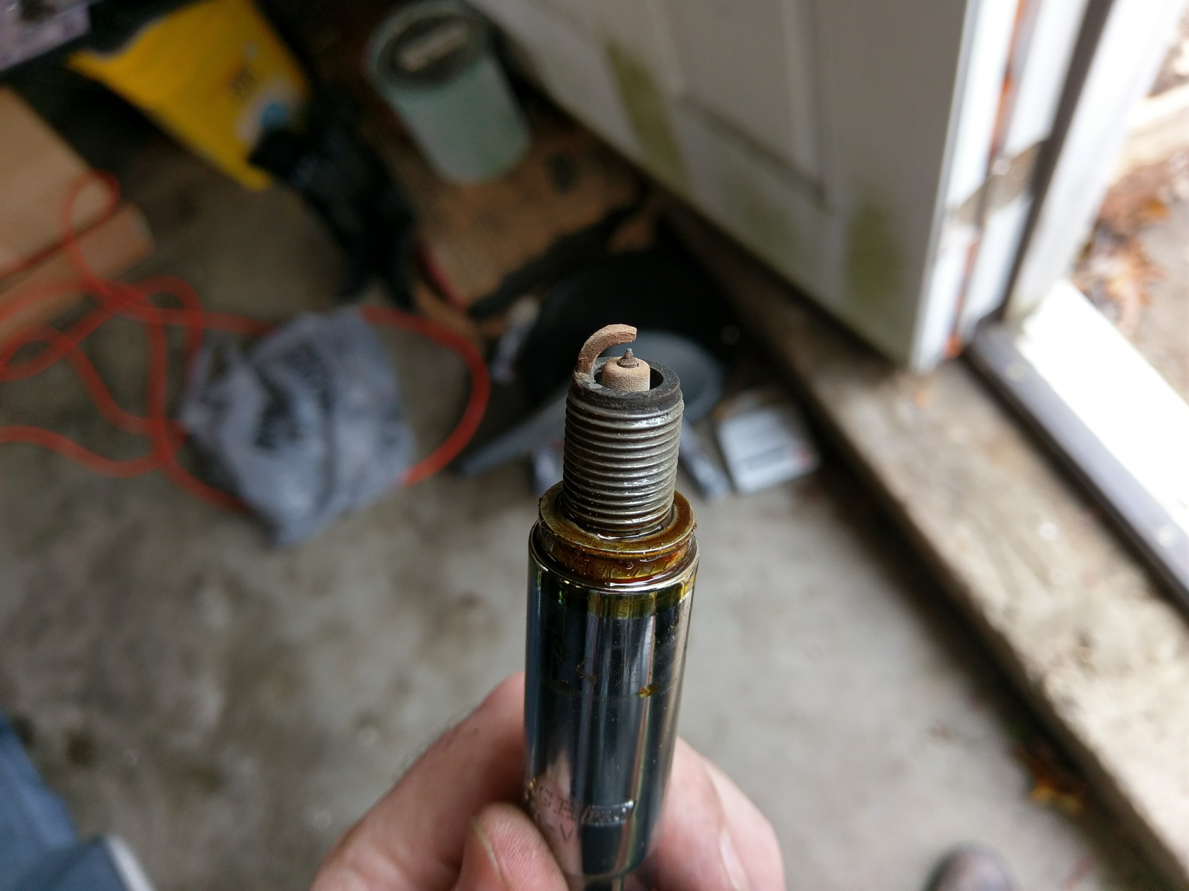

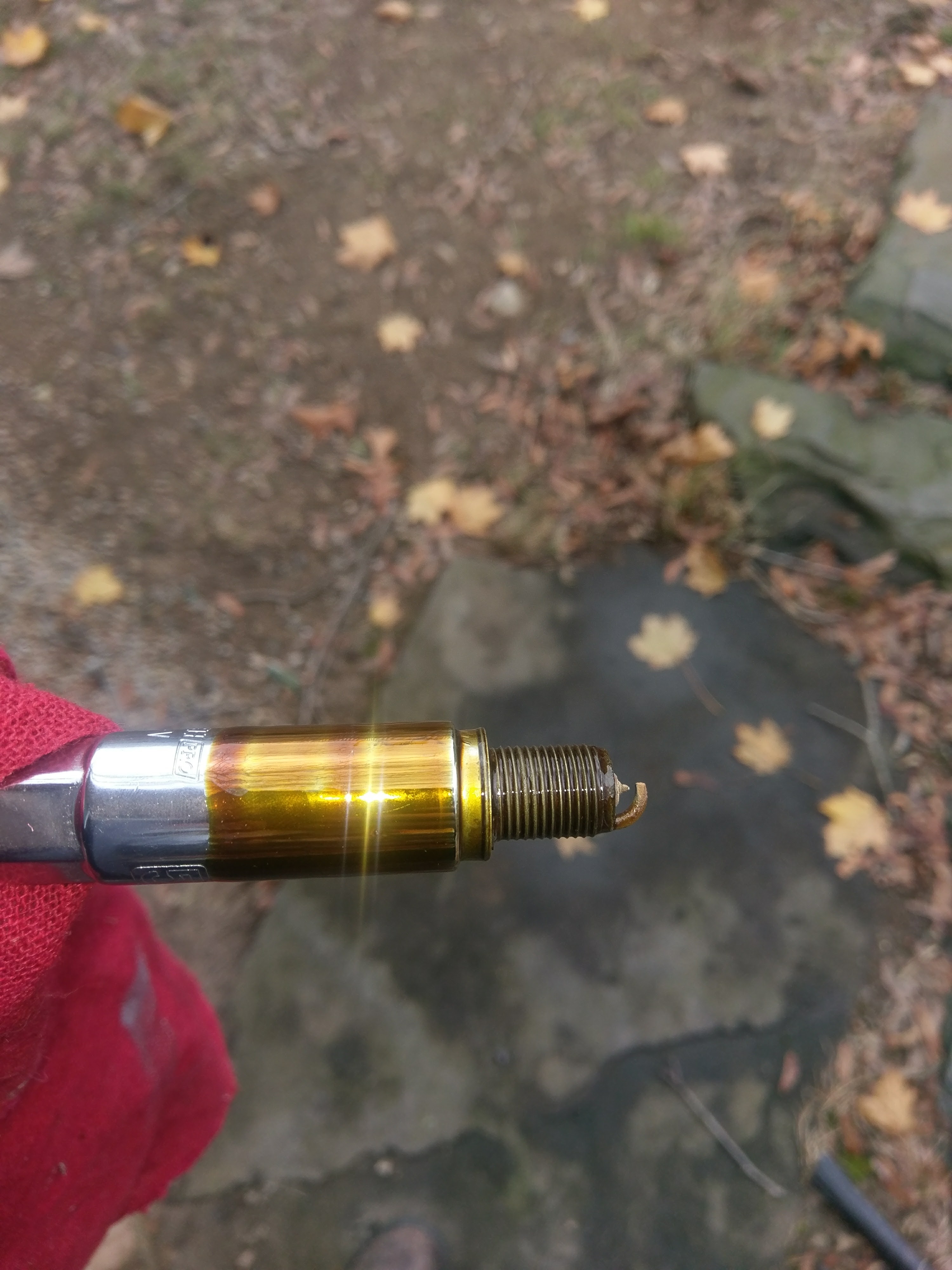

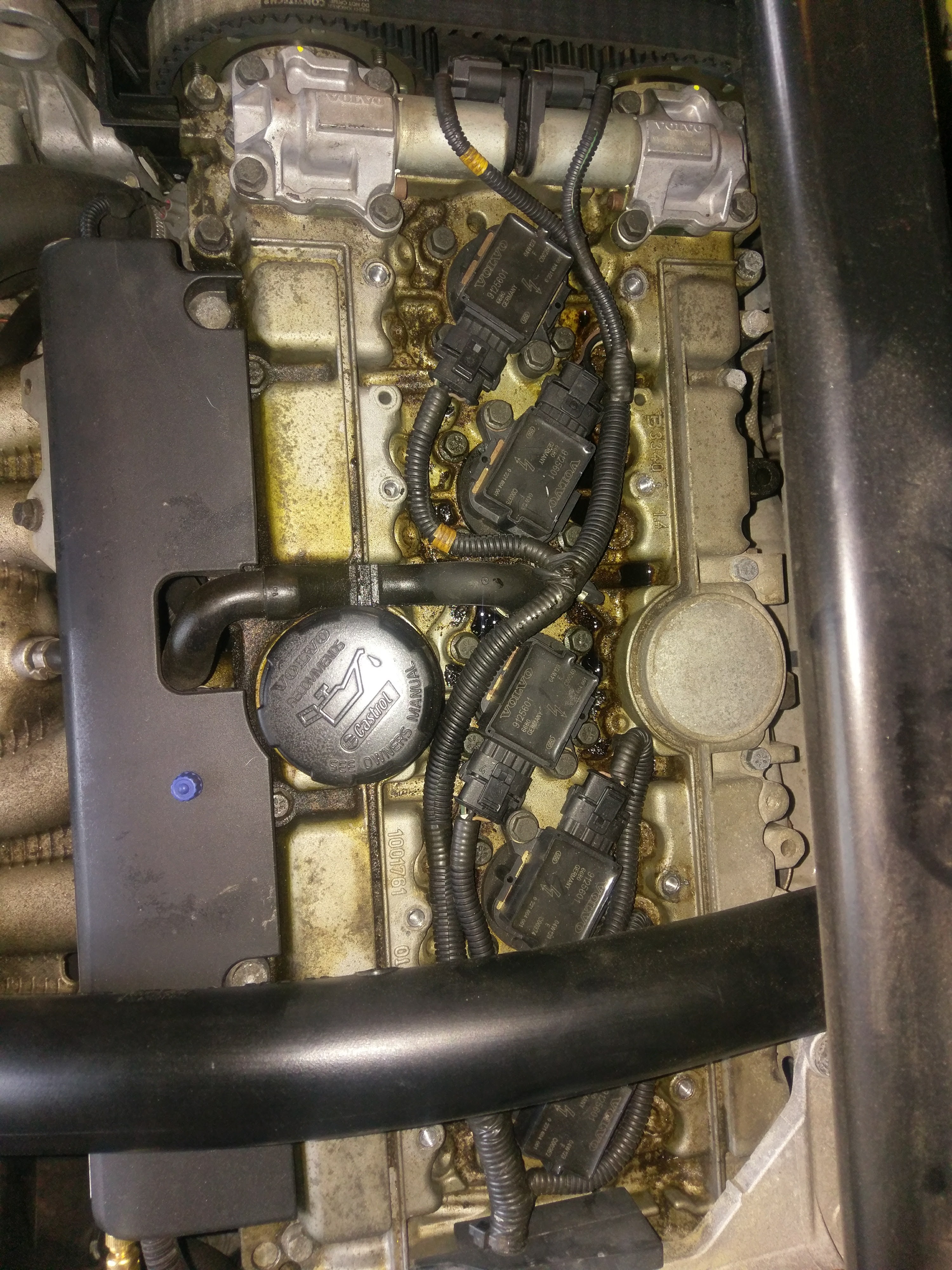

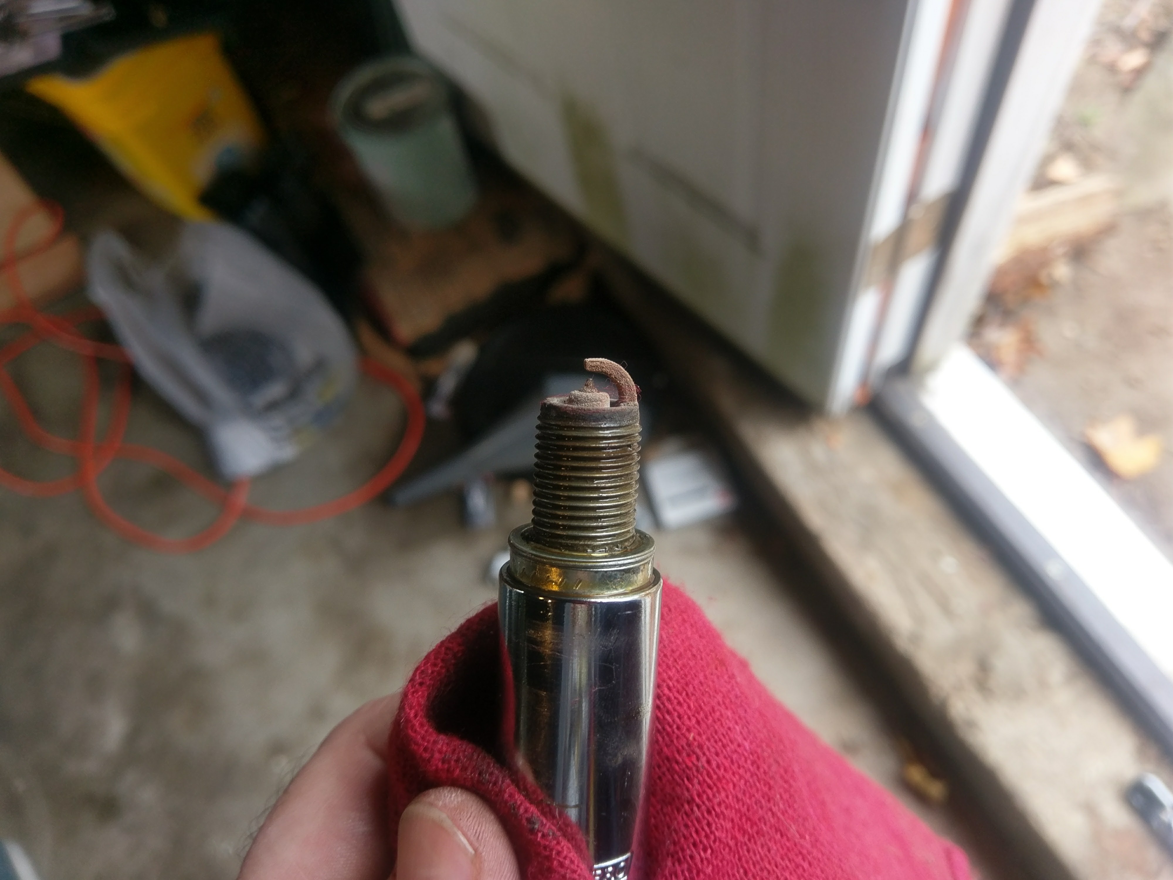

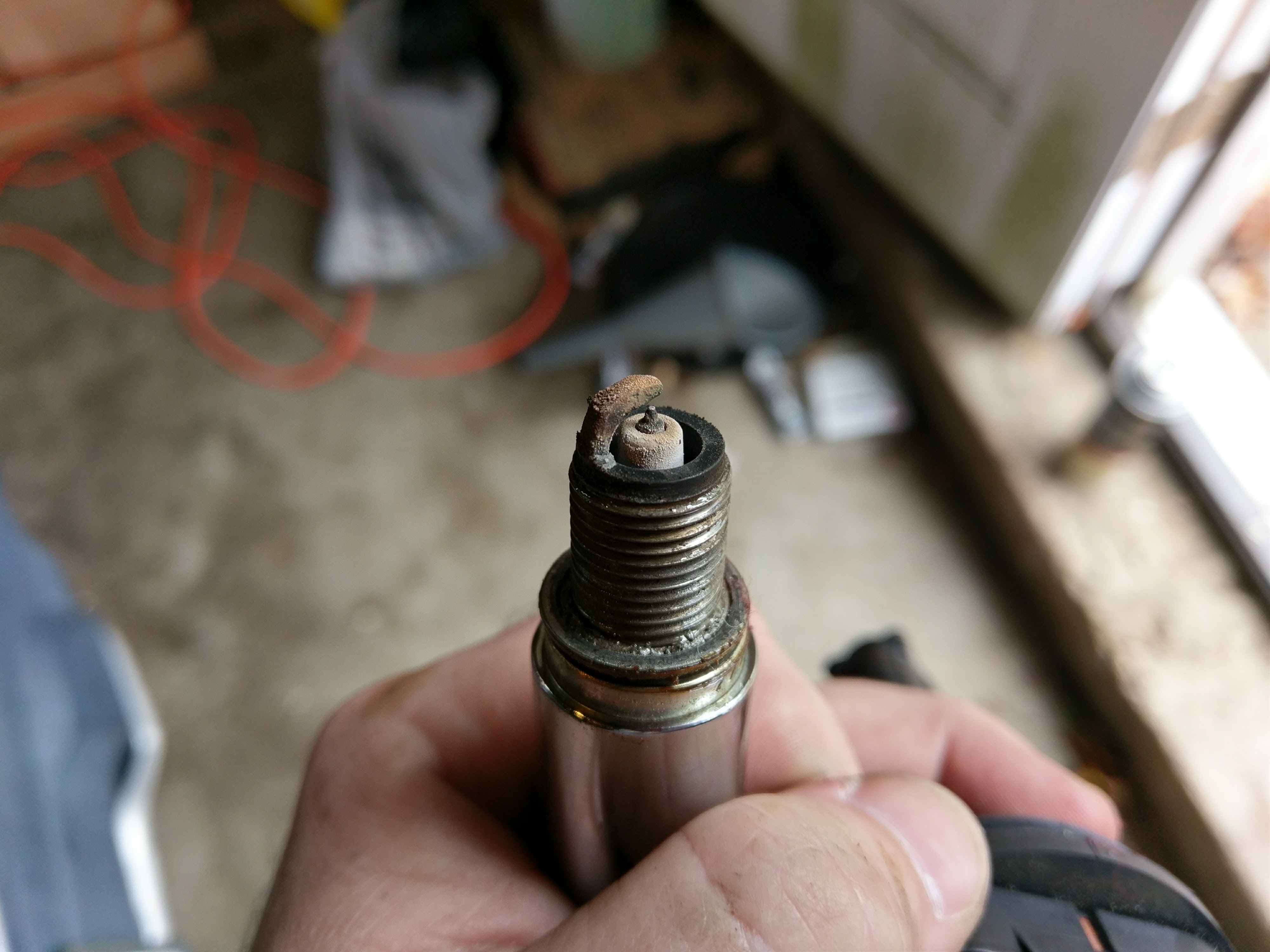

I got to work today to change the plugs and inspect the coils.
The removed plugs were NGK double iridium, and seemed tired but serviceable. The gaps had opened to about .043, which is pretty darn big compared to the specified .028. The only really remarkable finding was that the #3 plug hole had filled with oil. I was not happy with the condition of the coilpack on that cylinder, and sadly it tore as I was cleaning it. I don't have a replacement on hand at the moment, so I cleaned it as best I could and re-installed - for now...
That flooded plug hole was probably misfiring, and the engine did seem to run quite a bit better with the new plugs. The plugs were definitely a worthwhile investment of time.

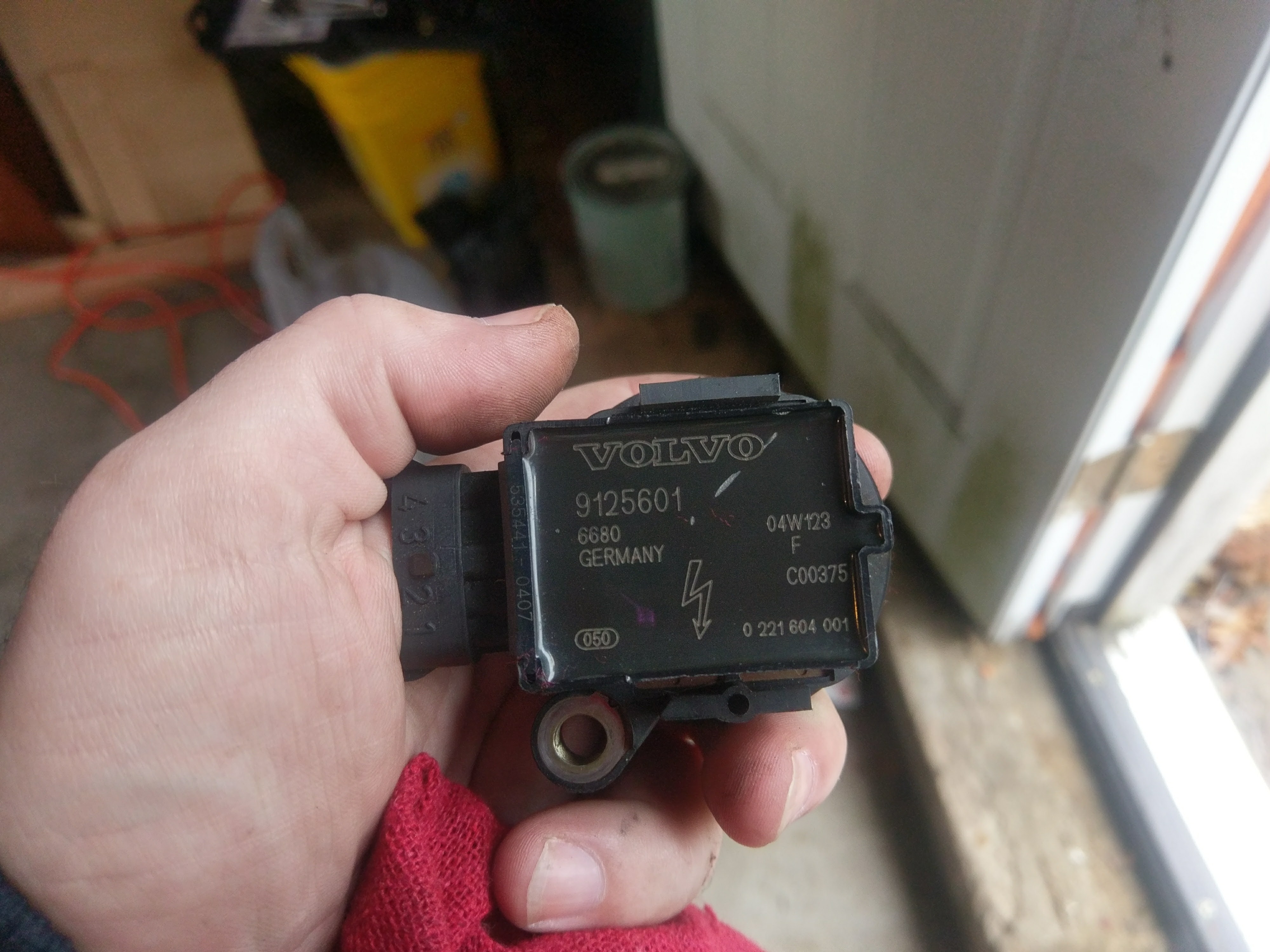

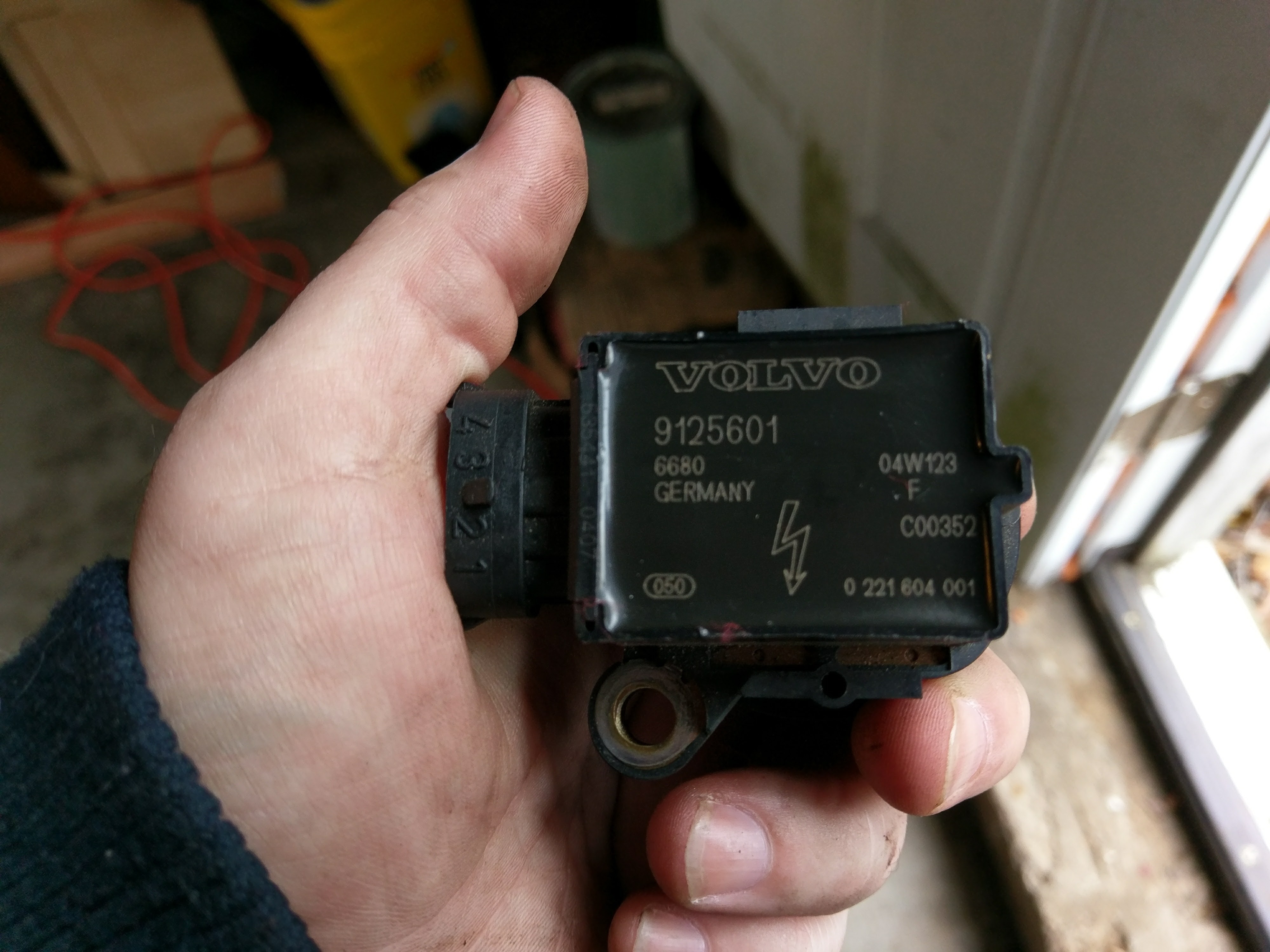

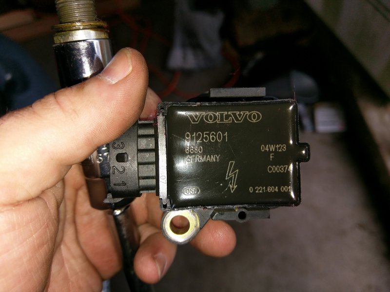

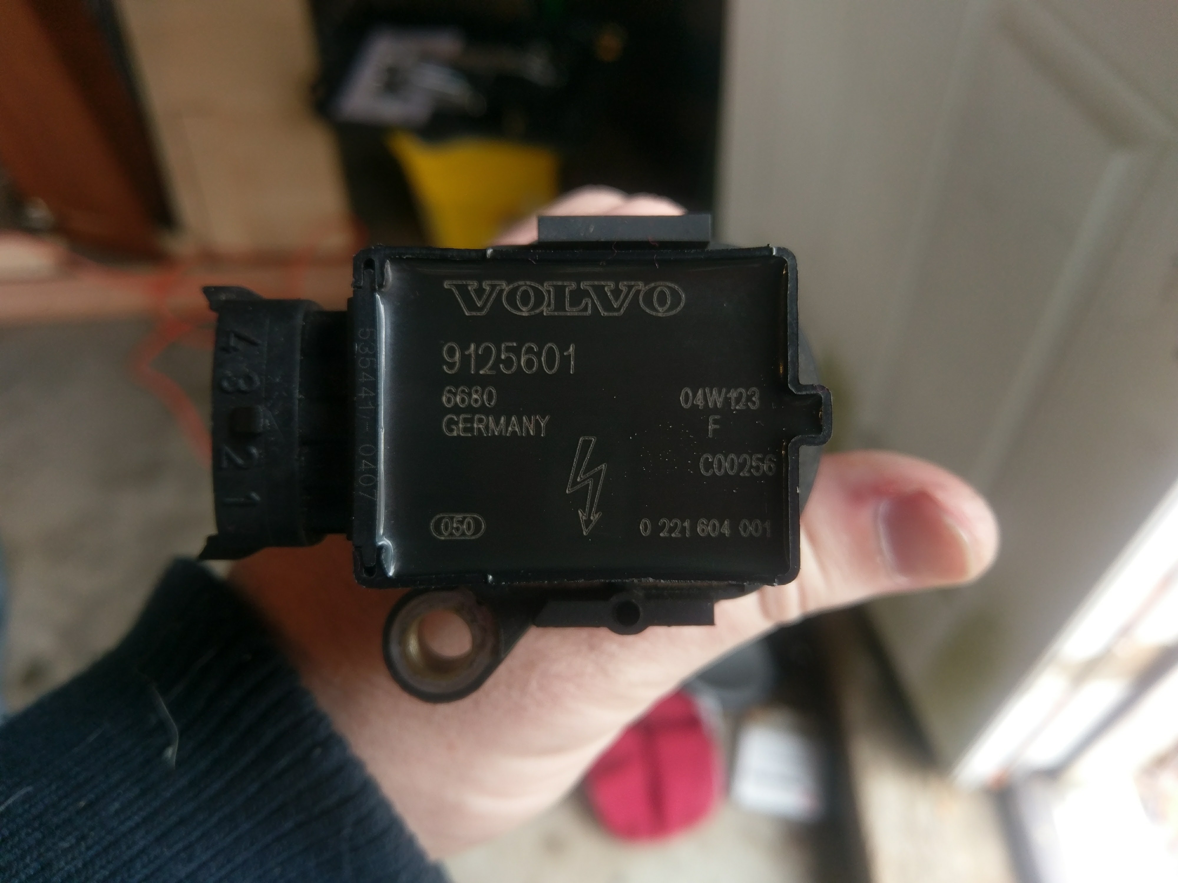

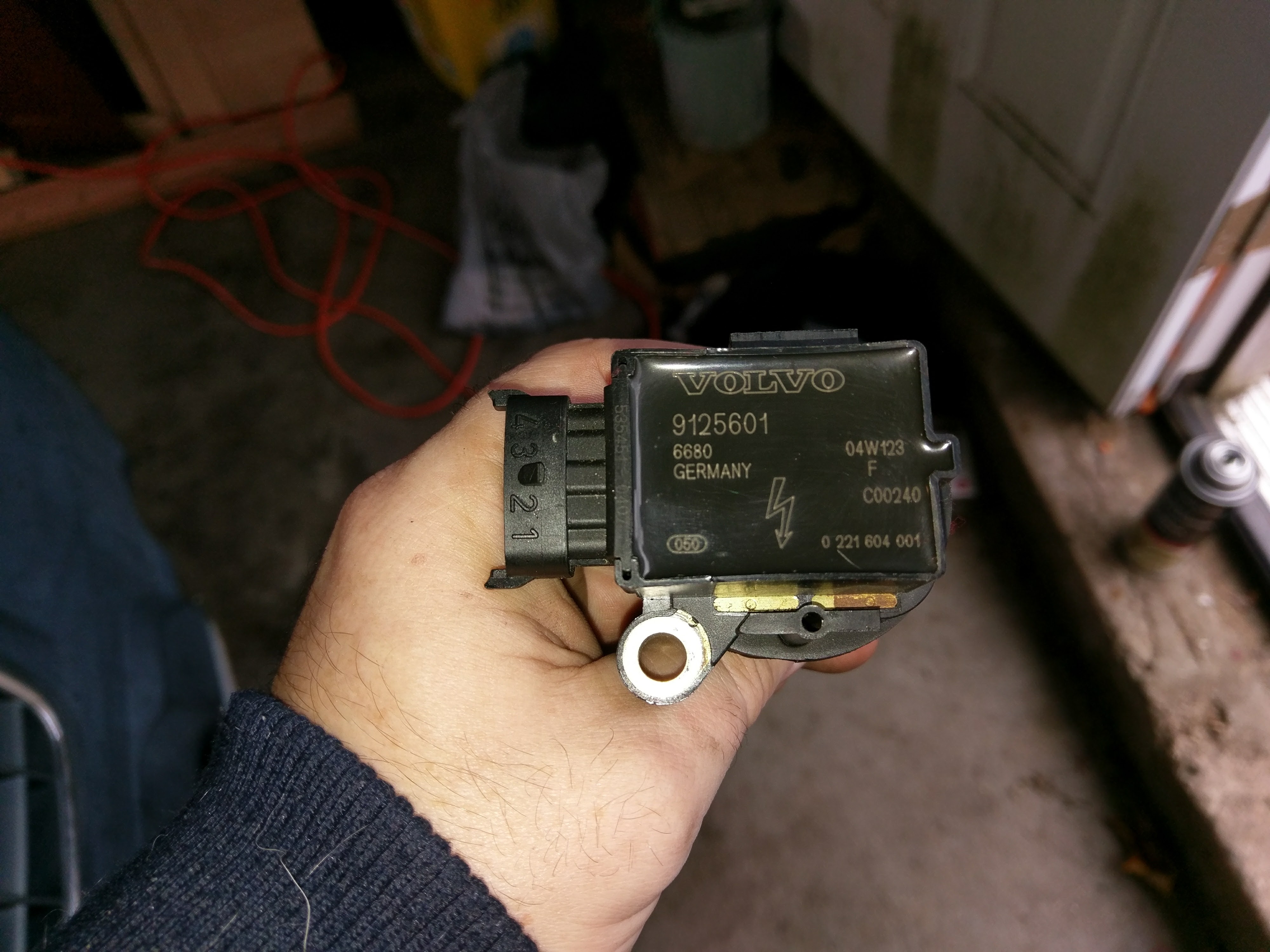

I have no idea how to read date code on the coils. The pictures are attached. I would appreciate any input.

Nice clear photos. These belong as the gold standard for posts!
Those plugs are worn out, so replacing them is good. The date codes on Bosch stuff. Are year plus a toggling month ( I've forgotten the code) but those are original 2003 ( MY 2004) coils so replace the one that one oil soaked as a start. Let's defer the vibration until you get that part. The vibration is still going away when you lift, right?

I had hard starting and vibration in my 04 XC70 at c. 165 K miles. Replaced plugs with genuine Volvo and all coil packs with Bosch. Ran like a top afterward. You're right on schedule for a complete replacement. You can replace a coil at a time if cash is tight, but I tend to do them all at once for peace of mind.
And Steve is right. The date code starts with year '04 and W = week, so I am thinking 12th week of '04, or end of March. Definitely OE. They don't owe you anything. You'll be amazed at the difference on replacement.
