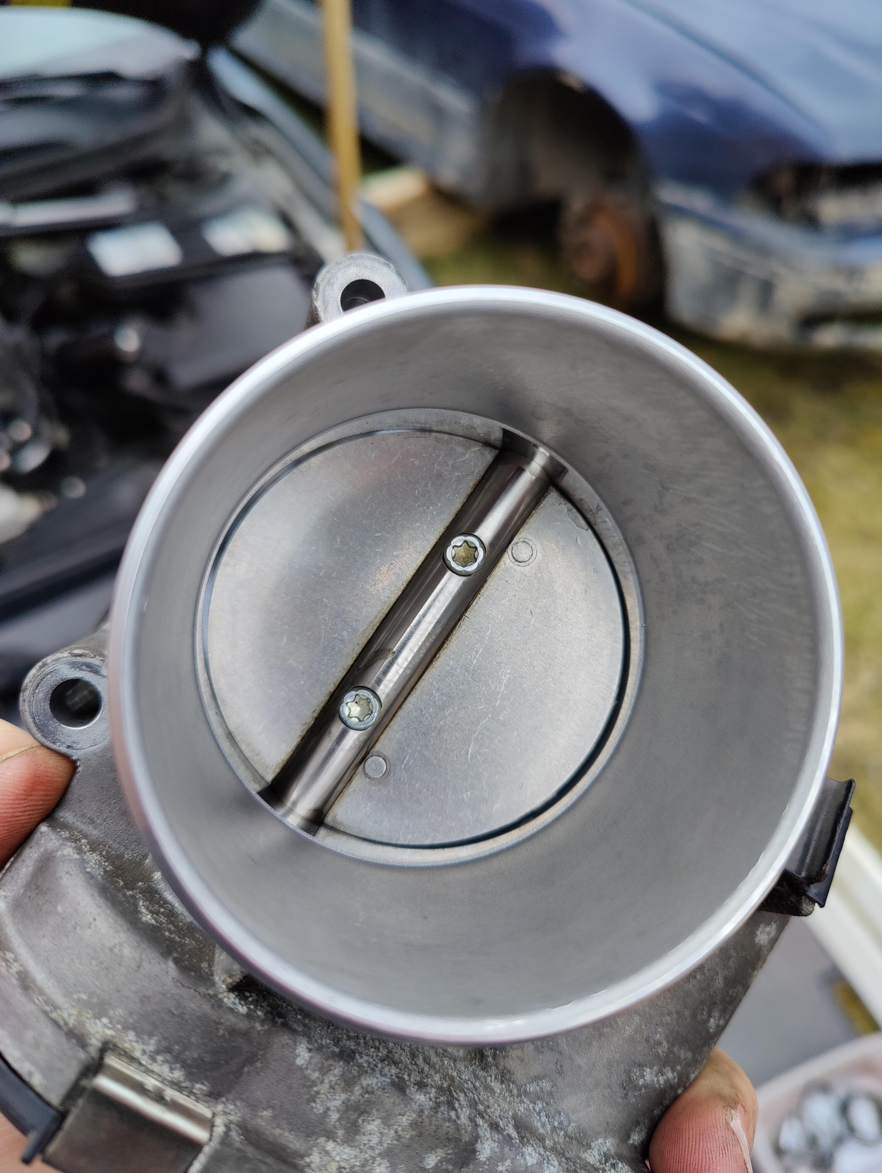

I had loping when idle on my 04 Volvo XC70 with 173k miles. It wasn't very serious like in viewtopic.php?f=9&t=97408. No RPM change nor engine codes, but it was enough to annoy tf out of me. Would notice it most whenever I stop at traffic lights. It had some hesitation as well.
I cleaned the throttle body up WITHOUT removing it. I didn't have a gasket so I thought let me try cleaning it in place. Most useful tool was a mirror that I put underneath it to help me with spraying. Worked like magic! It was so dark in color from carbon deposits from the inside before spraying the cleaner. It became so clean after spraying. I then shoved a wrench wrapped with a piece of cloth into it so I get to clean the other side of the flap.
After starting my car, the loping was GONE! Worked like magic! It's been annoying me for years, wish I had done this earlier.
Thanks for the helpful comments from everyone!

Post by hajjat »
Oh wow it looks so clean now, very satisfying!
