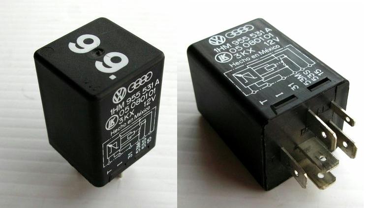

And the original 99 relays are better quality than the Kaehler ones, and program slightly differently (i.e. as per the IPD instructions).

skloon wrote:they must be popular with the vw folks too as they always seem to be missing at pick n pull
Hi,
Well that could mean that they dont last very long so the owners have to go looking for new ones too.
If i knew how this thing worked i could modify the one i have now and put a simple 'knob' on the dash to adjust the delay, but this relay has 6 terminals not the usual 4 and so i dont know what those other two contacts are for.
A simple SPST relay has 2 terminals for the coil and 2 terminals for the switch, and a simple SPDT relay has 2 terminals for the coil and 3 terminals for the DT switch, but since this has 6 terminals it's unclear what those extra 2 or that extra 1 is doing. If anyone knows how this works that would be great.

Hello,
Thanks, but where do you see the arrow?

There's no arrow in that picture, that's the point. It is a picture of a 196 relay.
Here's a 99 relay, with the arrow:
