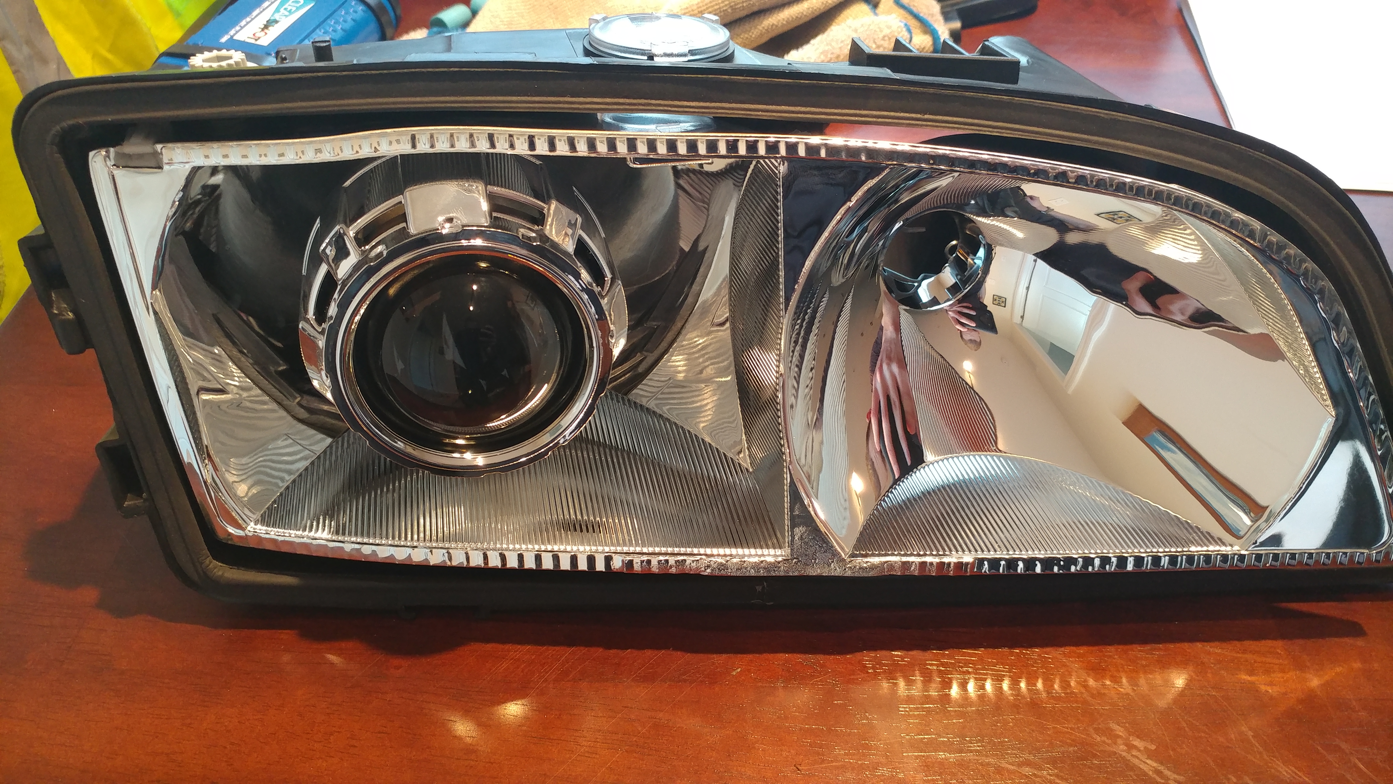

DIY: x70 Projector Retrofit
Improve Headlight Output with Projectors

I should probably post some updated pics - I think picture 12 was taken back when I still had fluted lenses (prior to all the sanding). I also haven't really dialed down my aim perfectly yet. I'll try to get these in the next week or so maybe taken from lightly further back so you can get a good idea for the beam pattern.
I did some research into these h1 projectors and you will notice that very close up there is a lower "semi circle of light" but then once you get maybe 5 feet out the light is all on the ground. This is the same on all projectors h1 mini "classic projectors" due to the shape of the reflector bowl. If up close (less than 5 feet) your light wont be touching the ground yet and you will see the lower semi circle in the pattern. Doesn't really bother me although there are thing you can do like foreground limiters to fix this issue. You could also buy the newer Morimoto mini h1 7.0's which have that flatter pancake reflector to eliminate that issue.
After driving around with these I am still very happy with them. I have seen the one amazon reviews about the reflector getting eaten by UV.. I guess only time will tell. I took the cheap projectors as I wasn't sure if it was going to work in the first place and did not want to invest a lot, I also felt after looking at pictures for multiple brands they seemed to be designed all equal (just the h1 classic). Pretty sure all the non morimoto ones are just the rejects that didn't quite make QA for some reason. Either way now that I'm with this setup, throwing in a new expensive projector would not require a lot of effort.
I may spend some time in the future tuning these projectors with bending the cutoff shield and spacing the lens to get optimal coverage. Sound more like a summertime kind of job though.

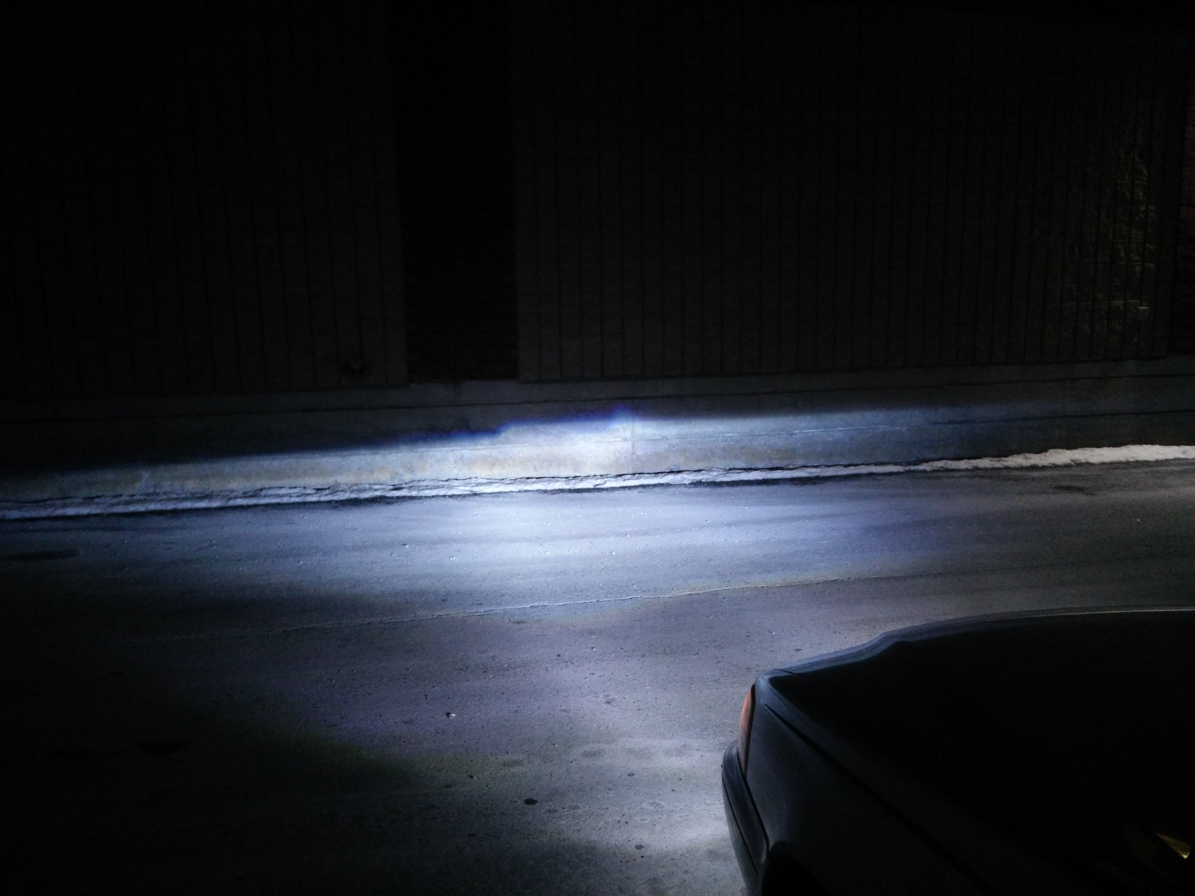

OP-great job, looks well-done, now just the test of time! Try a picture against a wall from about 30-35 feet. thay will give us a good idea of where the light really goes in traffic. ( Now I have some use for my 2 sets of spare housings with tan "refelectors"

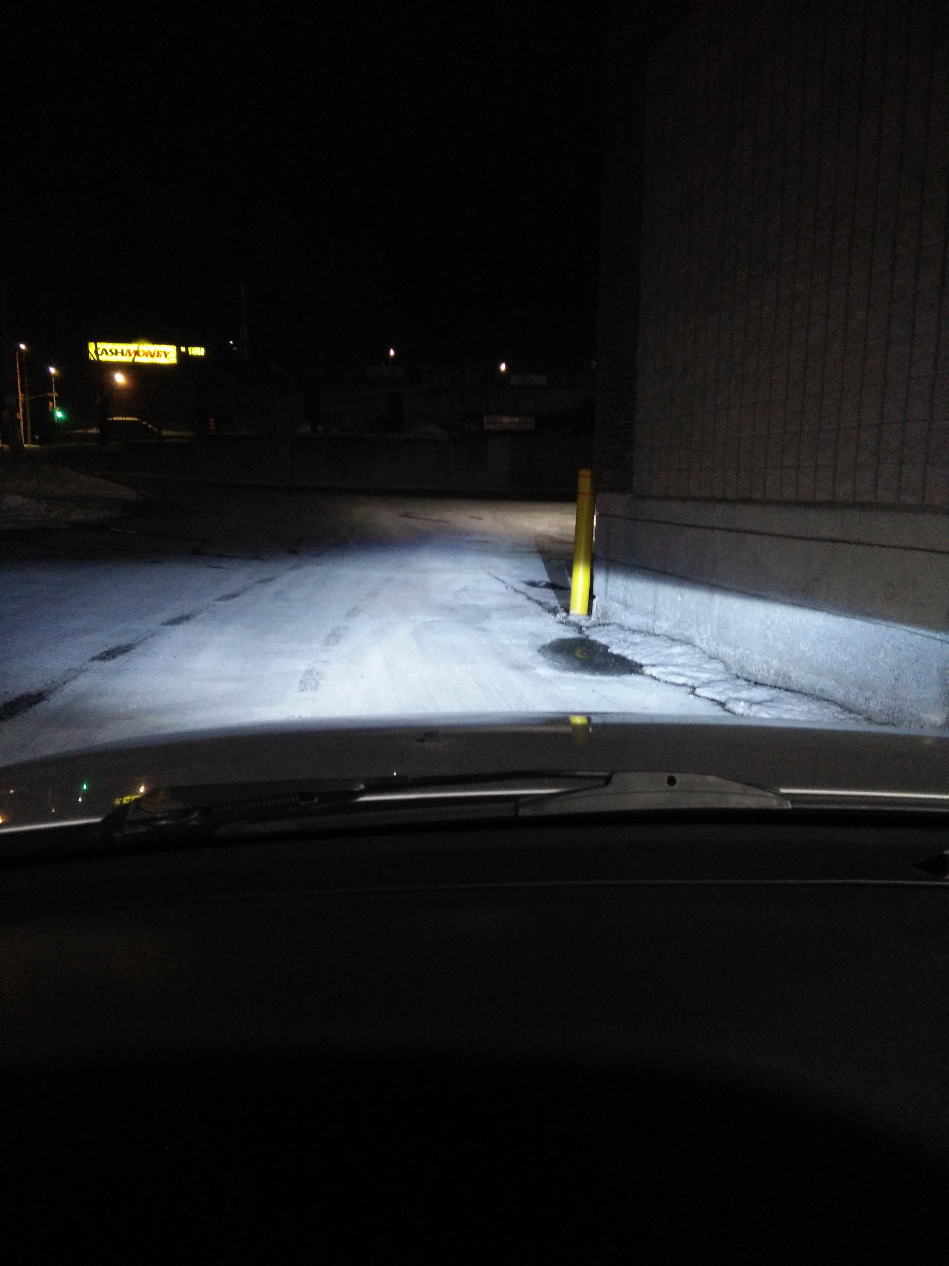

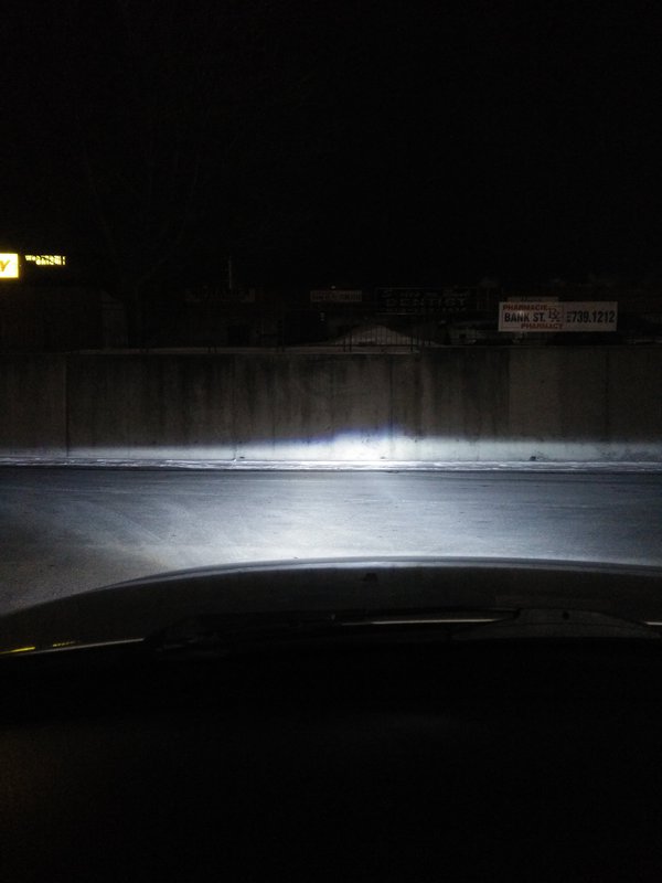

Here's some output shots. My aim is not 100% yet still playing around with it but it gives you an idea to the level of lighting. Its great! Even If these wear out and I need to upgrade to the morimotos I will definitely do it. Keep in mind these are all not level surfaces, theres not really a lot of good spots around here with all the snowbanks atm.

Thanks for the updated pictures. Are those pictures taken with the fog lights on?

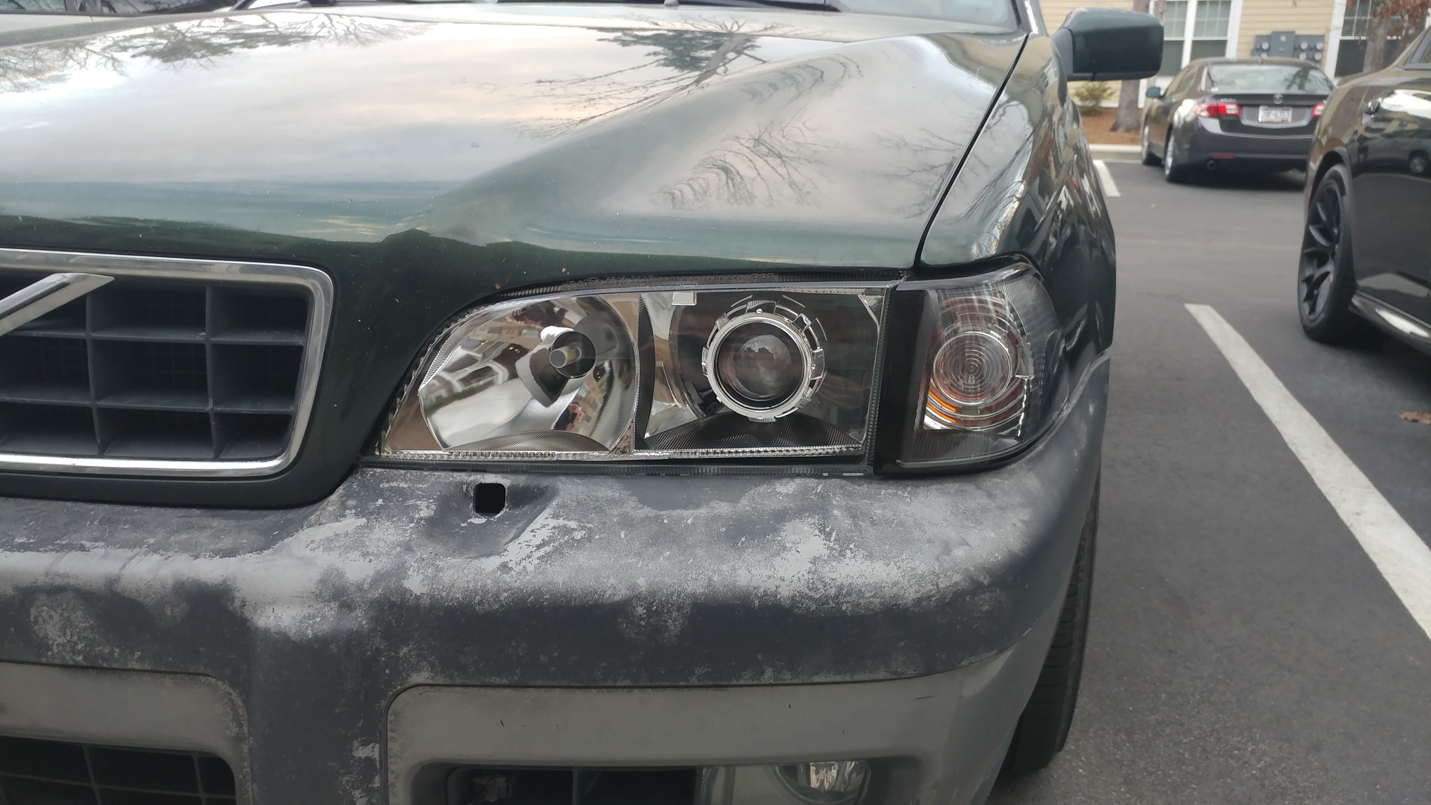

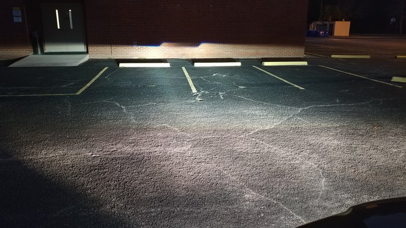

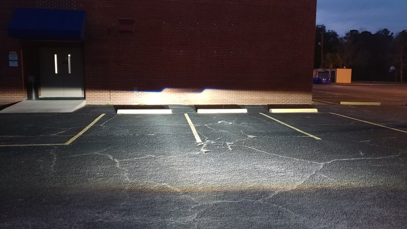

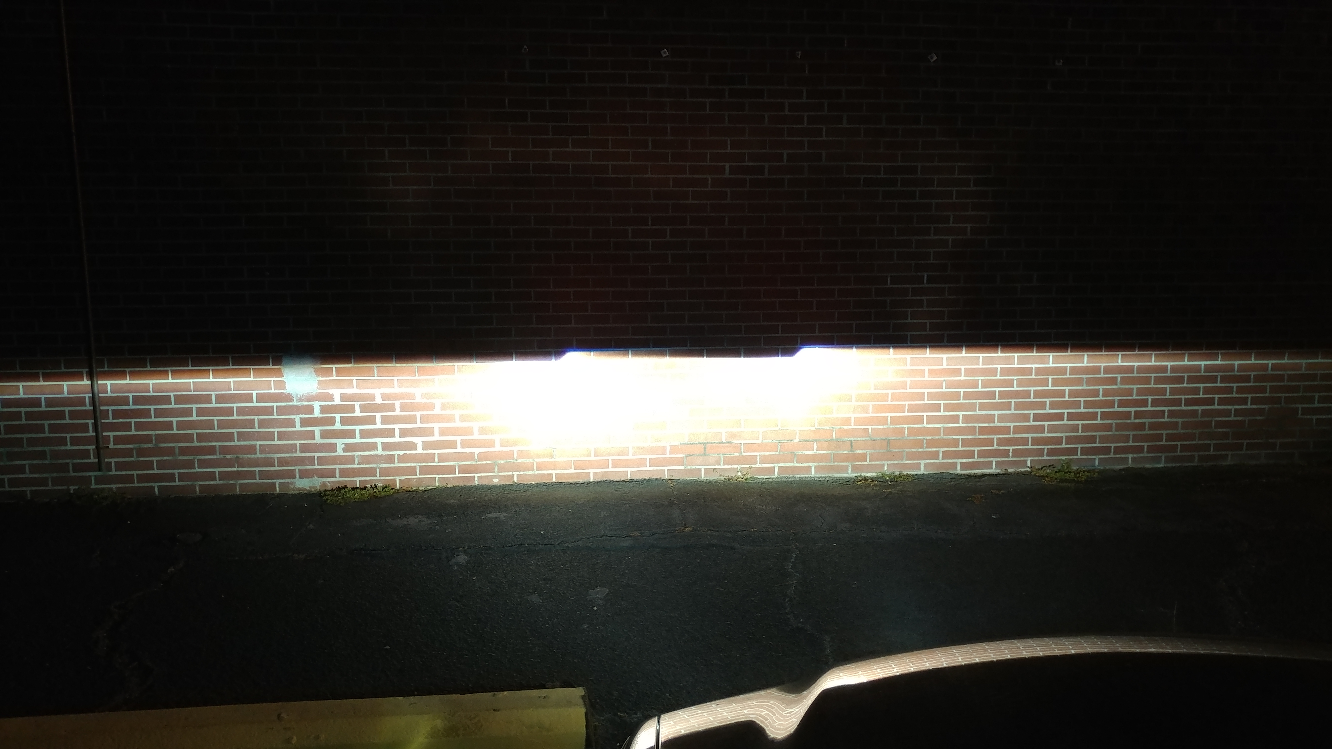

Darkfleet, your thread inspired me to do a retrofit! I still need to tweak them a bit, but here are my results from today's install.
I bought new aftermarket OEM-style headlamps from IPD.
Installed... and yes, painting the trim is on my to-do list.
Low beam only (35w 4500K HIDs)
Low beam + halogen fogs
Up close cutoff. Holy lumens batman!
