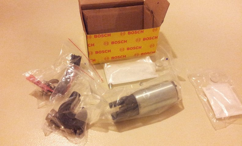

I wanted to see how complex the P2 fuel assembly is after being quoted over $380 locally for a Bosch 30761743 which includes the sender and the pump as one unit. I didn't want to wait 10 days for a pump assembly from Tasca (just over $209USD which is not a bad deal at all) so I decided to see how different a P80 (Gen 1) pump is. I found a seller locally selling Bosch pump 0986 580 979 to suit P80s for $78 AUD. The ad claimed it suits C70s up to 2002 with the B5244T engine so it must have similar specs.
PARTS/TOOLS REQUIRED:
1) Hammer (my favourite tool)
2) 25cm (9 inches of submersible fuel hose)
3) Bosch pump 0986 580 979 comes with 2 X quality clamps (other parts in the fitting kit won't be needed)

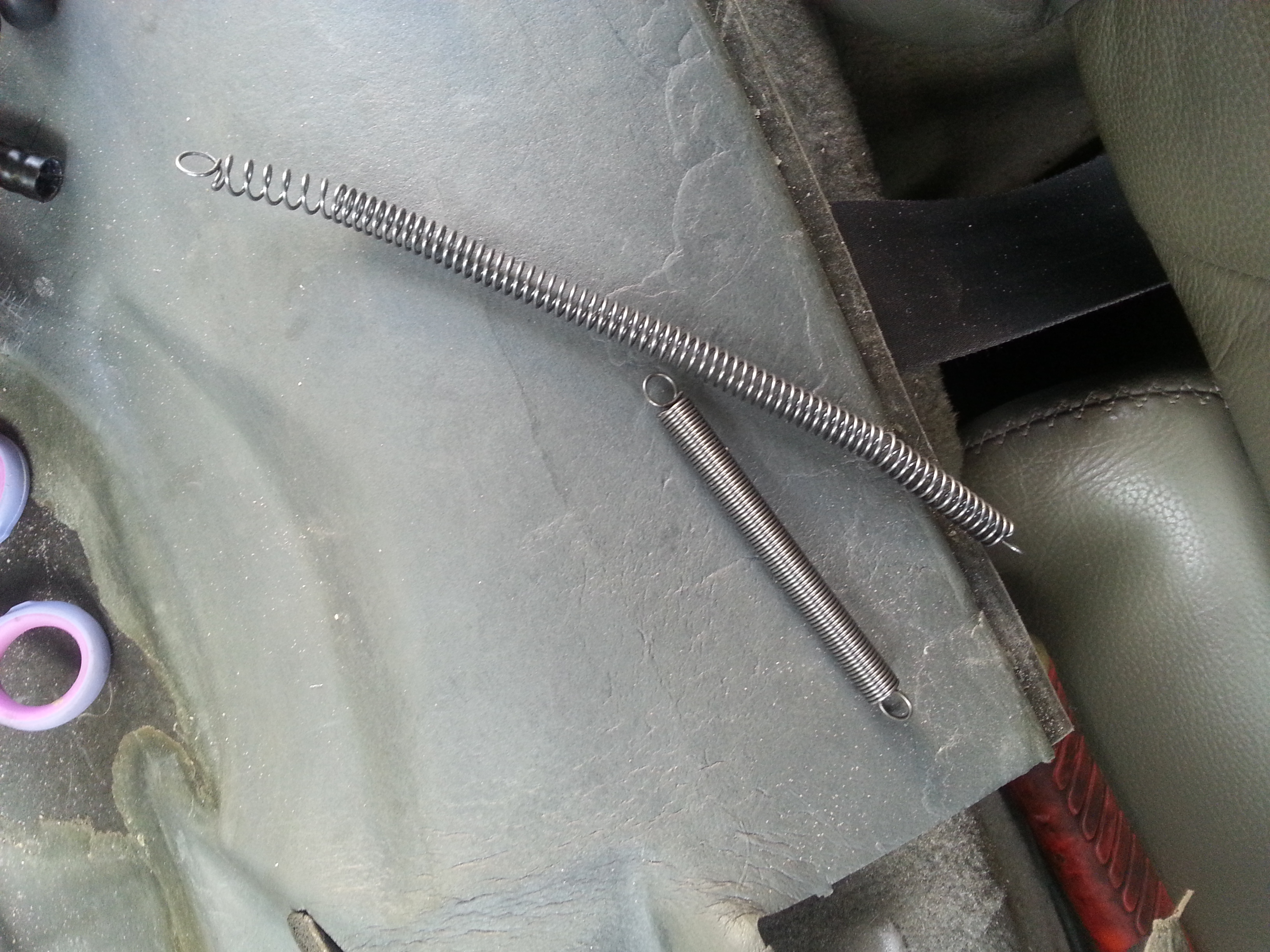

6) High tensile spring 8.6mm wide to be inserted into submersible fuel hose (one of these can be stretched for 2 installations)

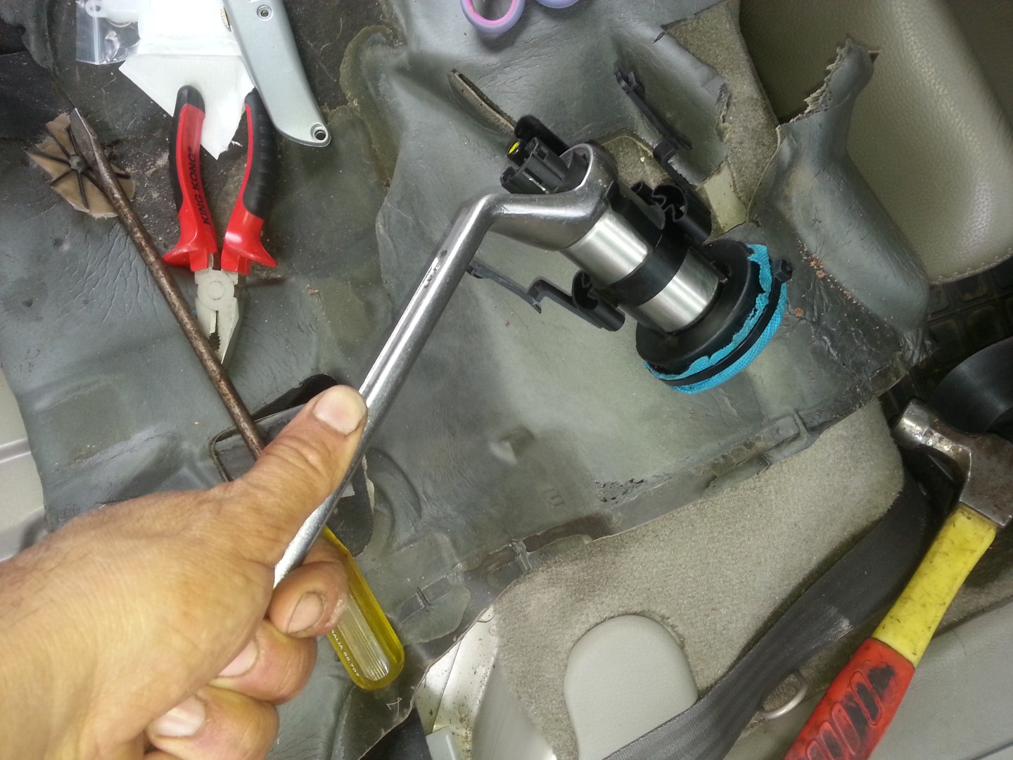

15) 32mm ring spanner or ring socket (to locate pump back onto old gauze filter housing)

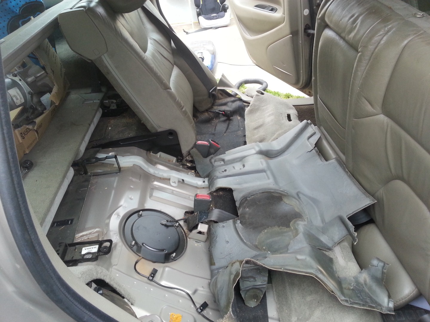

Of course I removed the seat cushions first by folding them forward and releasing the red clips. Then I pried on the narrow board between the seat backrests and the luggage boards. There are clips that just require prying here. If you don't have the 7 seat option just lift the luggage board up and slide it closer to the tailgate.
Another important step is to disconnect the battery as the connector to the back seat will trigger an SRS code.
The new Bosch fuel pump for P80 series
20141009_211530 %28Large%29.jpg (70.72 KiB) Viewed 1297 times
Remove the carpet keepers X 2.  I used a large flat blade to coerce them
Pull on this bolster and it will eventually come out

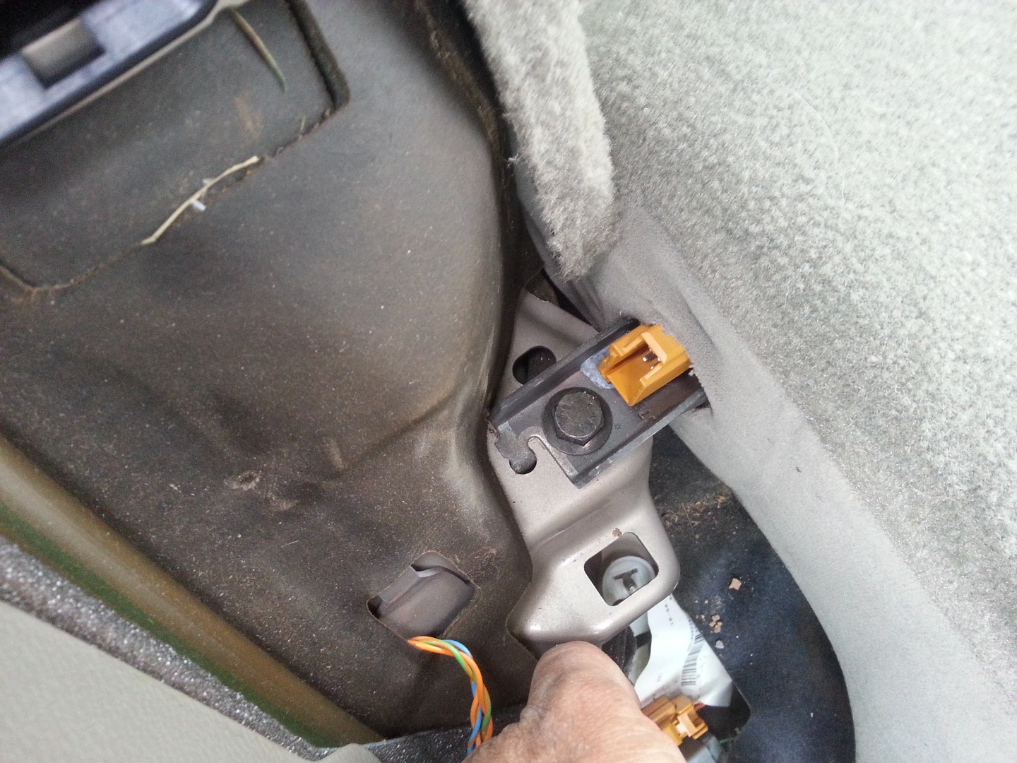

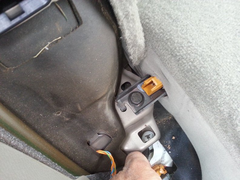

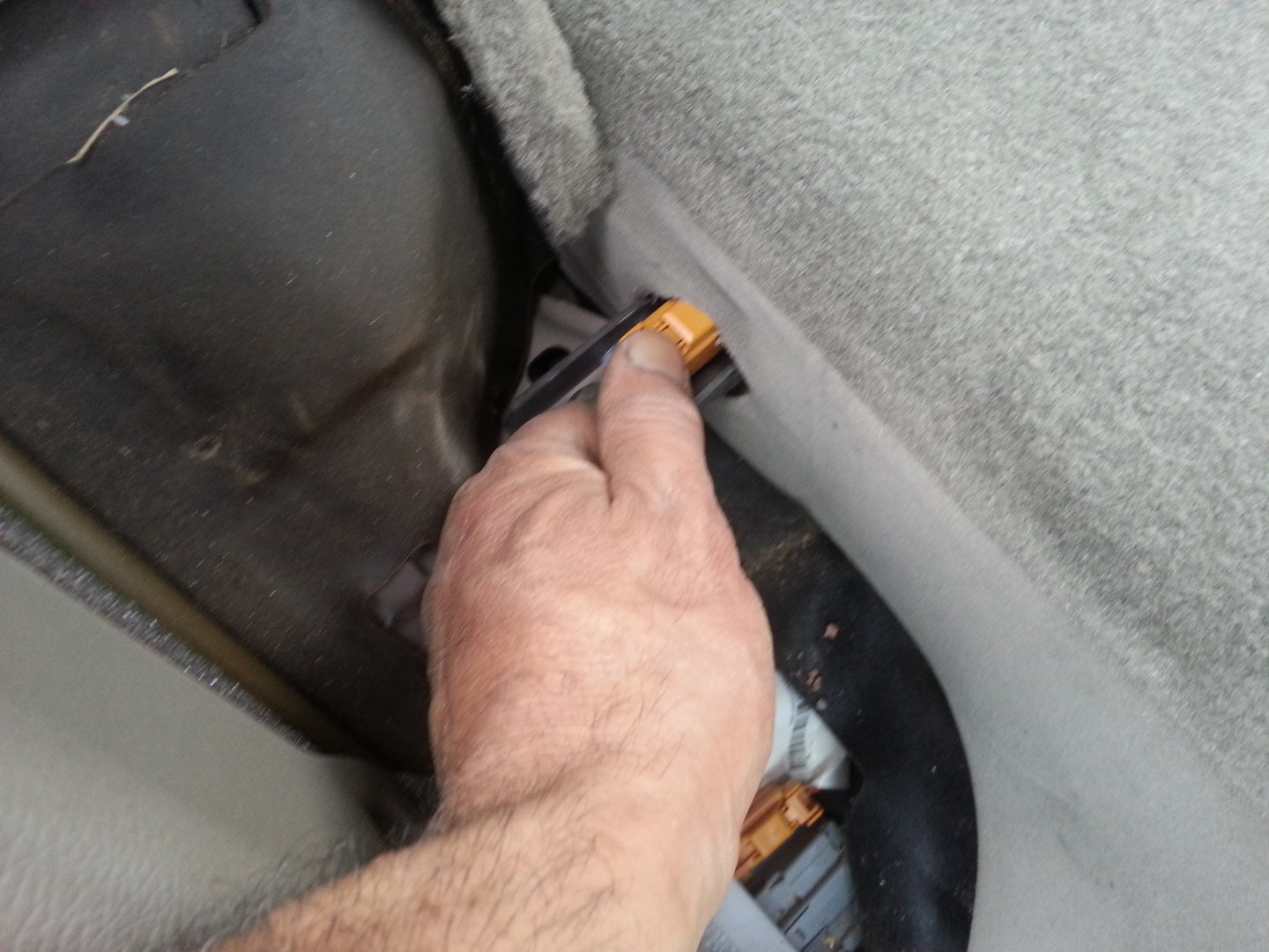

Remove this connector
Remove this 14mm bolt in order to remove the large seat backrest

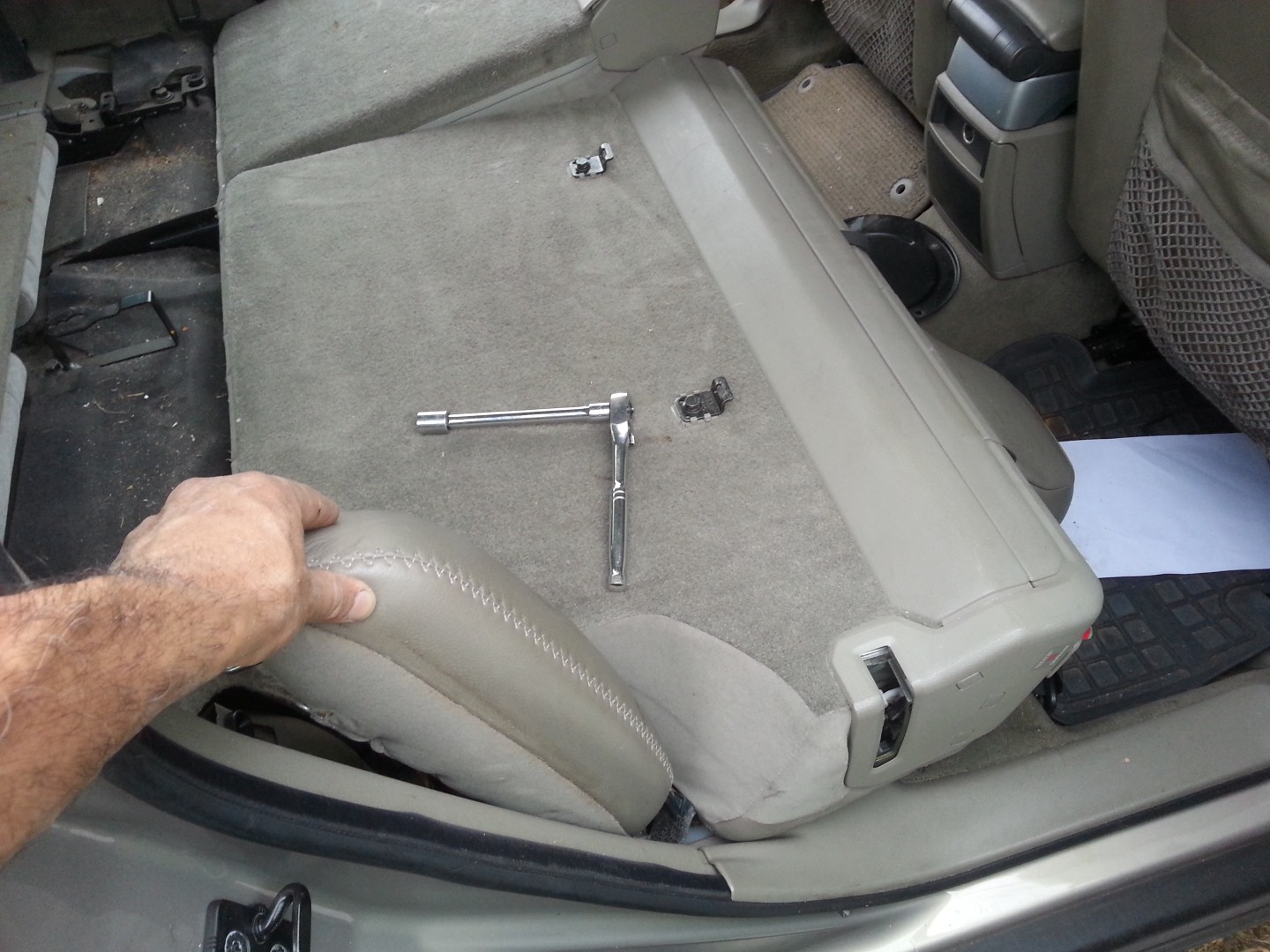

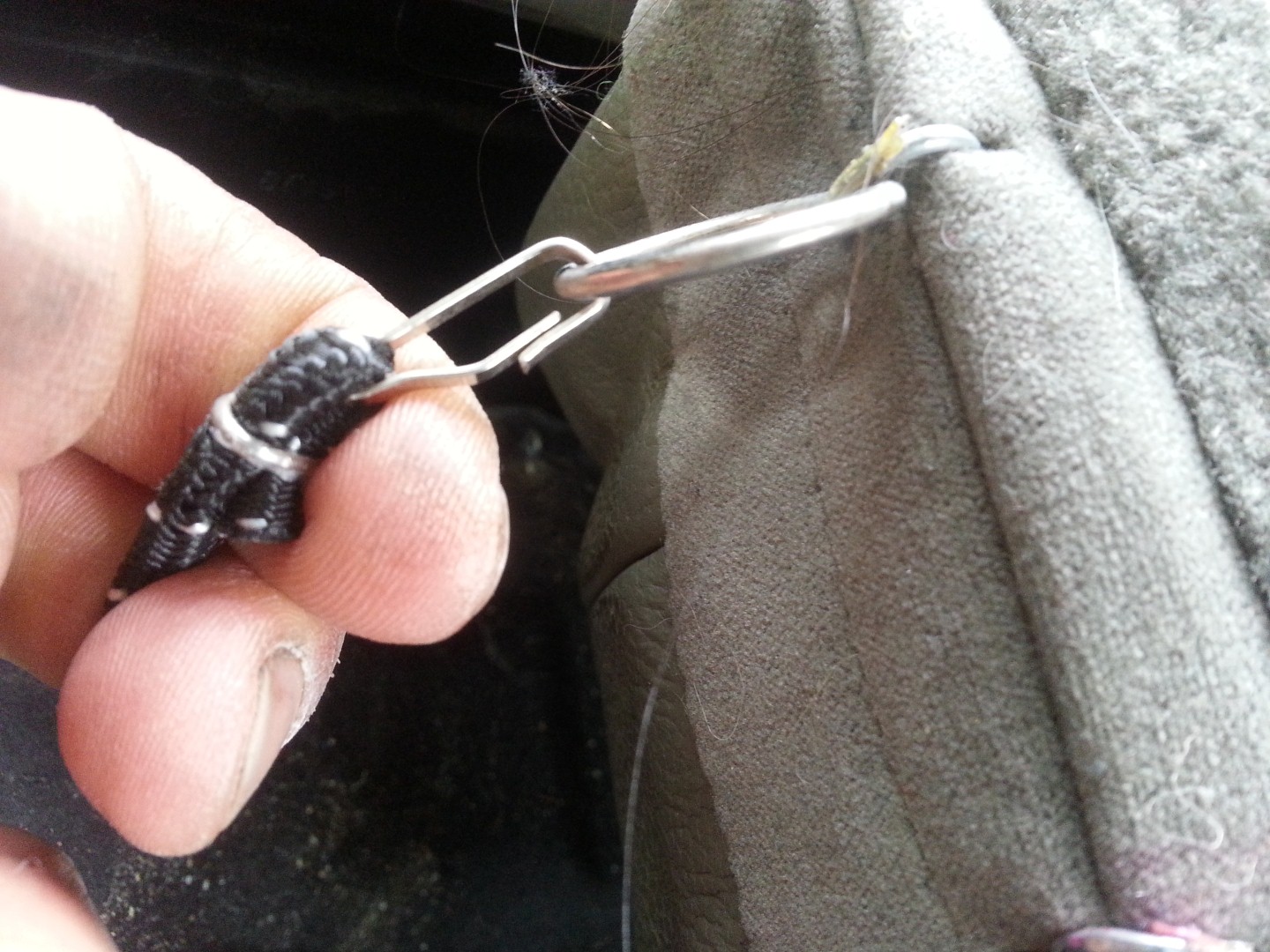

There are 2 x bungee cords to unclip from the backrest
Sound deadening material peeled back and finally we can see the hatch.  Backrest is upside down in footwell

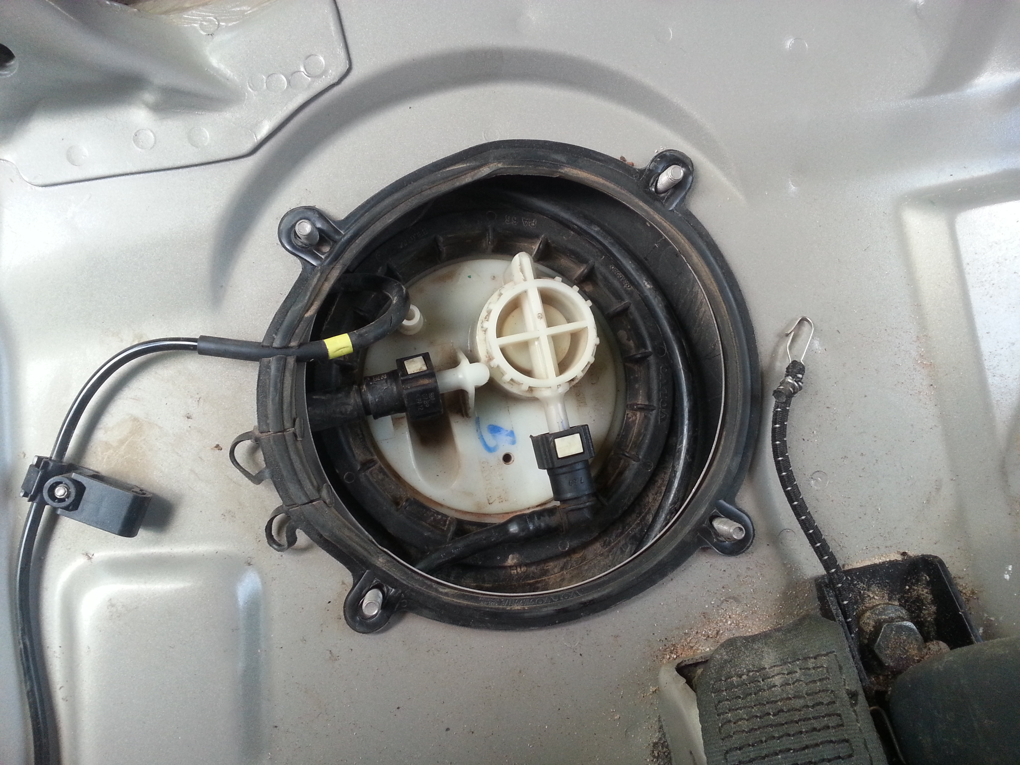

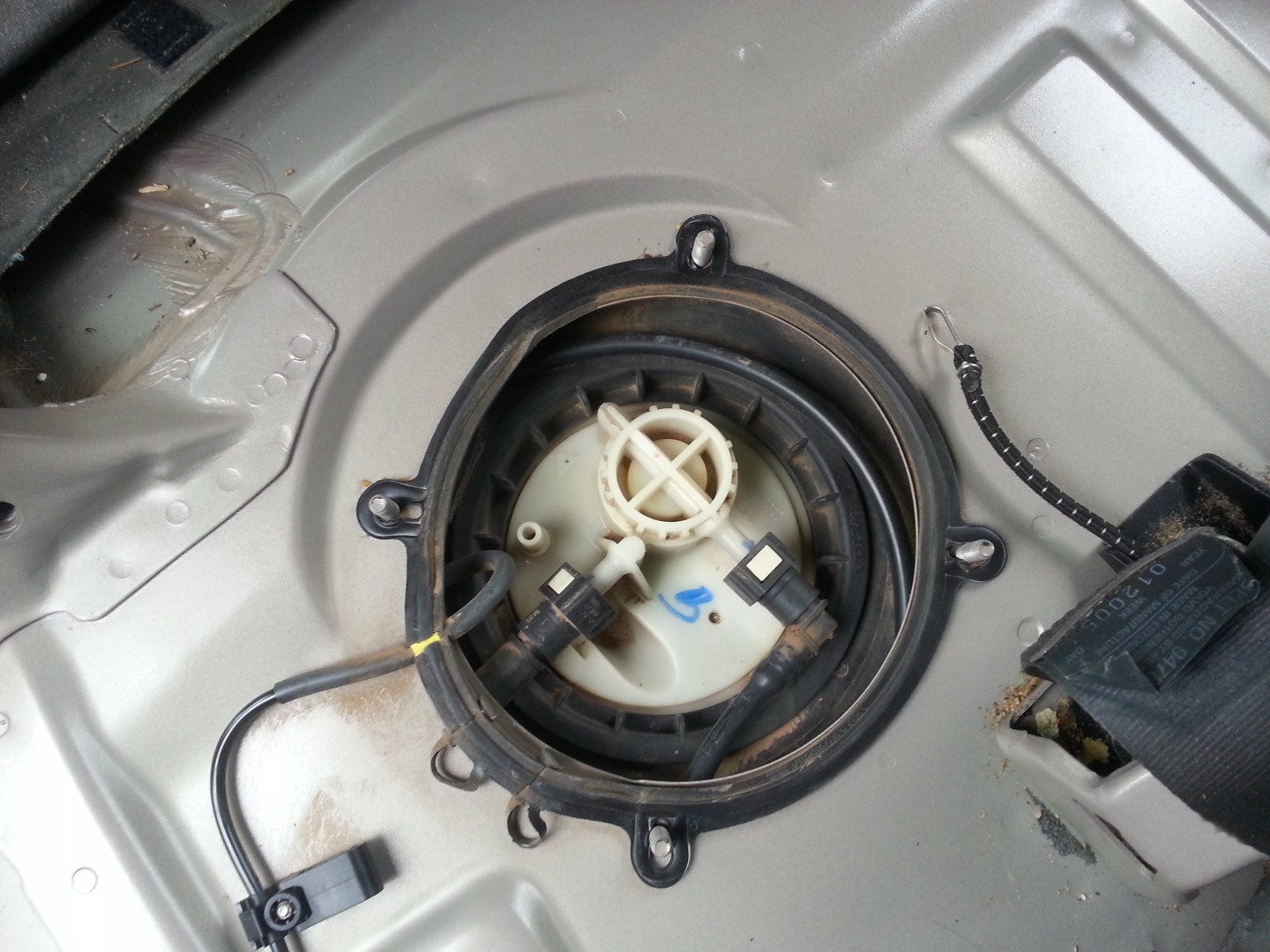

Hatch cover removed exposing the pump assembly.  The port is very dirty and needs a clean

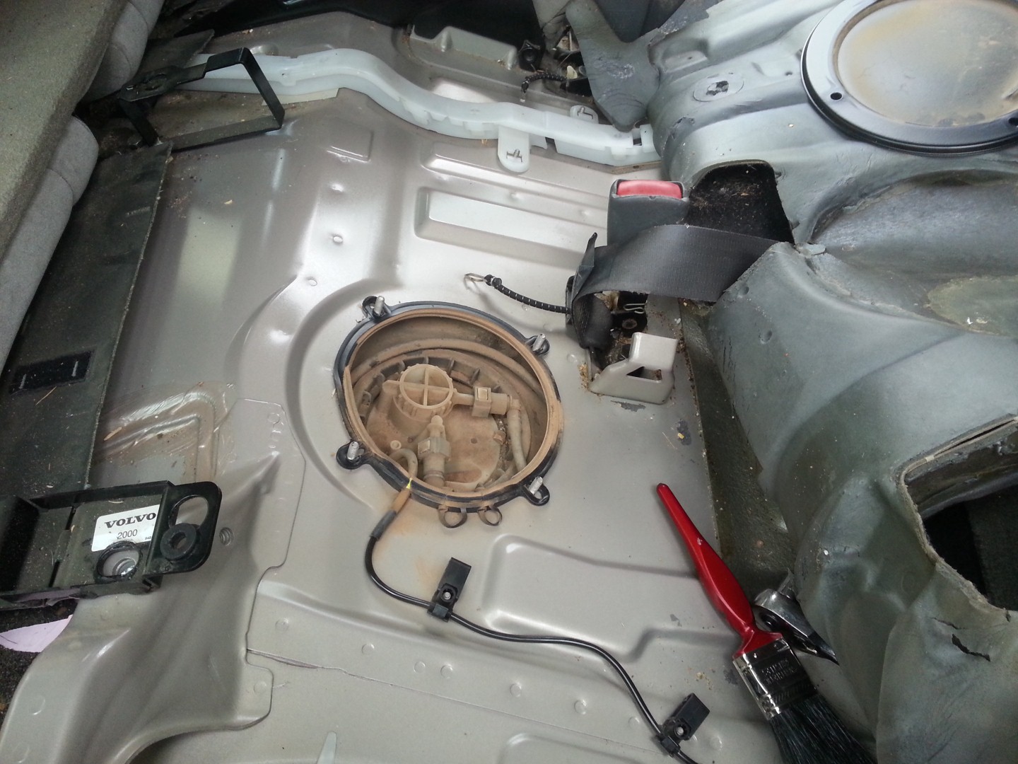

The port cleaned up with a paint brush and vacuum cleaner

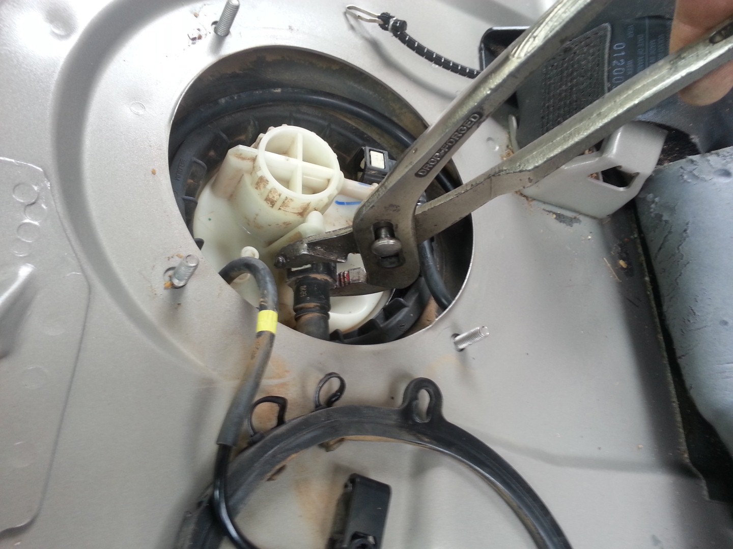

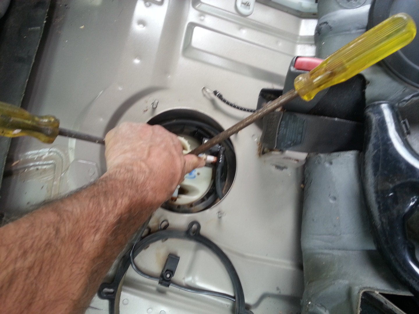

I found it easy to press both clips with one of these
Touche.  Engard Dartanion!!

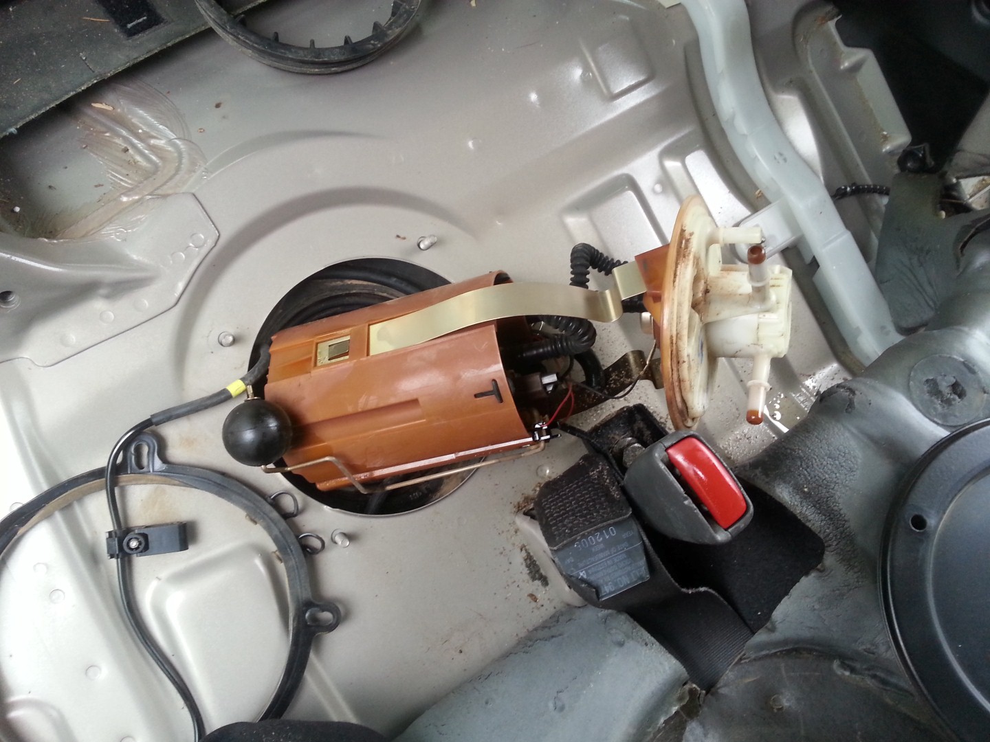

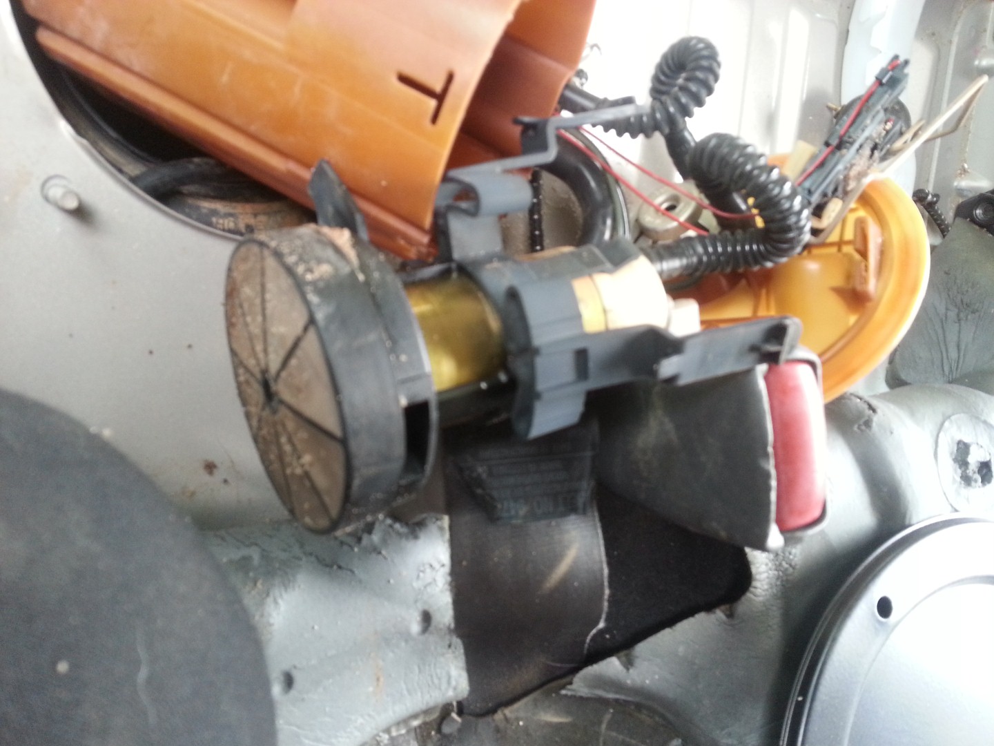

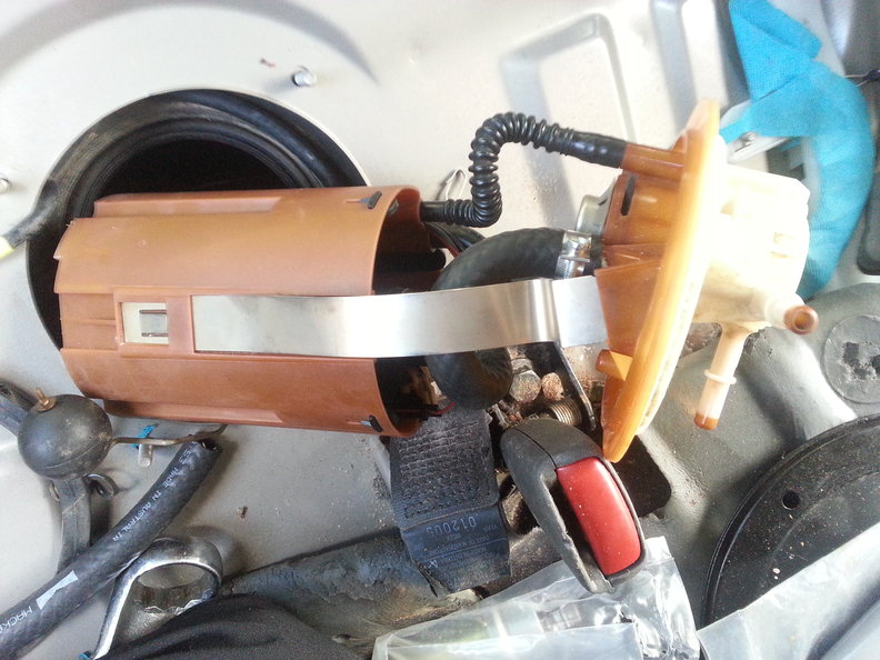

Finally pulled it out.  It doesn't come out easily and is tied to the sender on the other side by wires

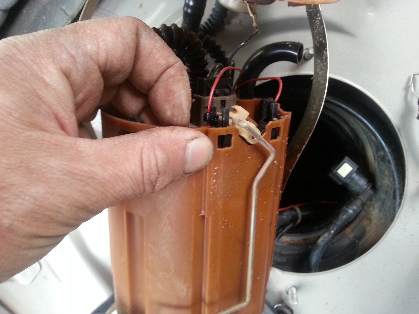

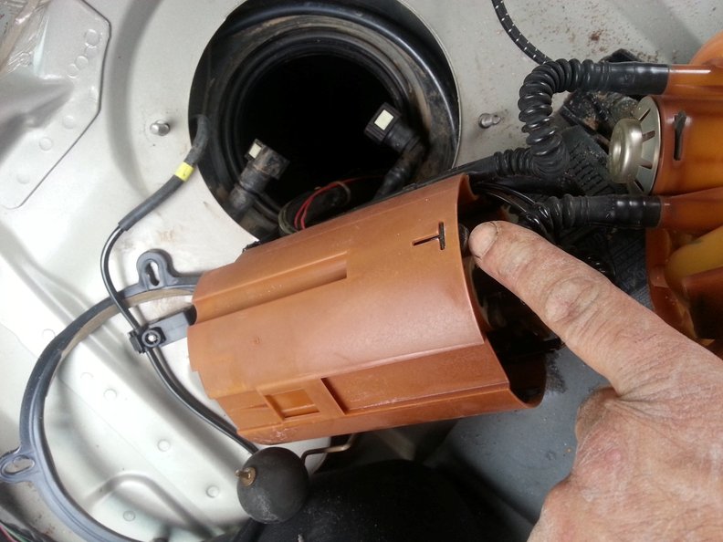

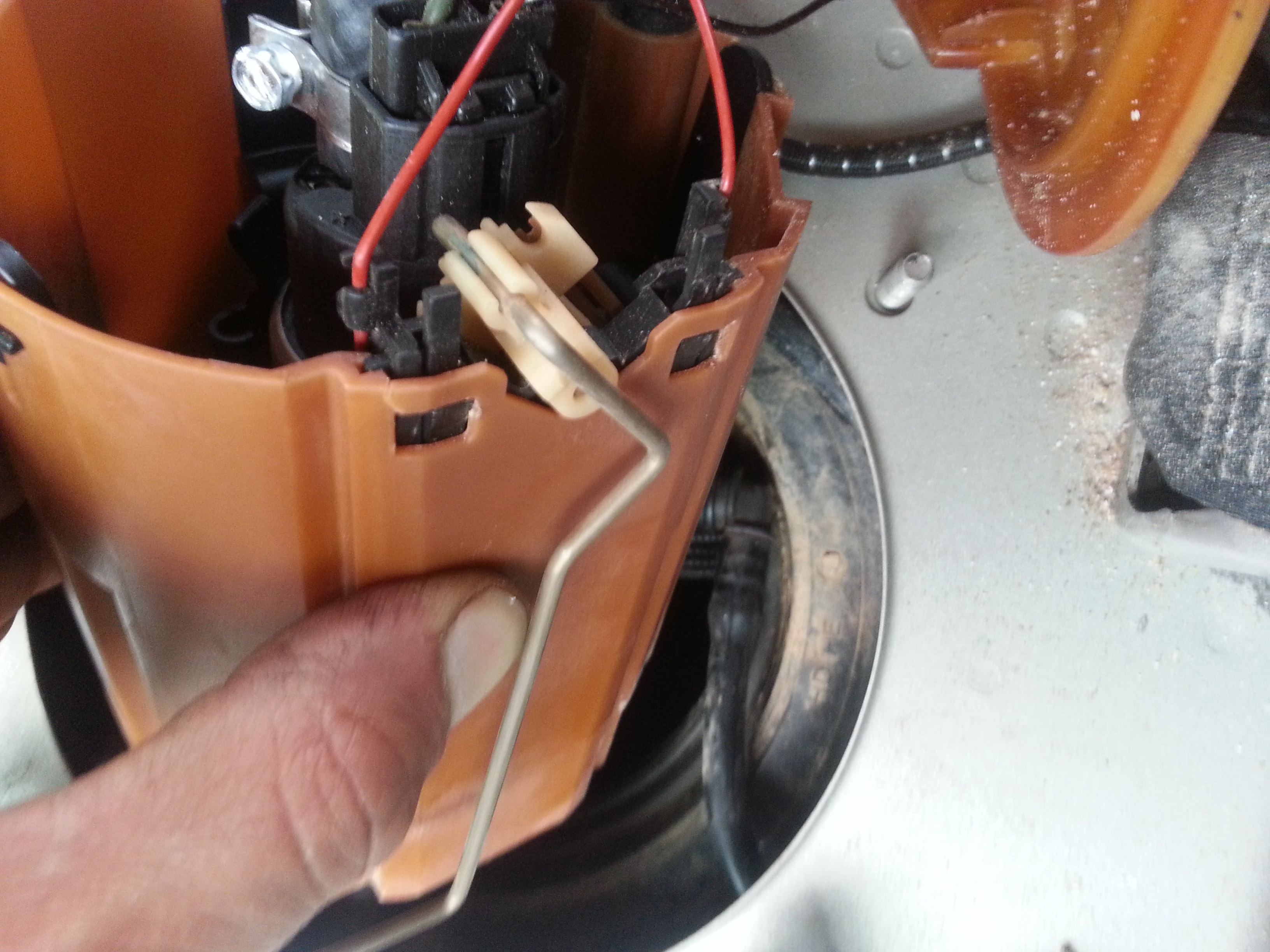

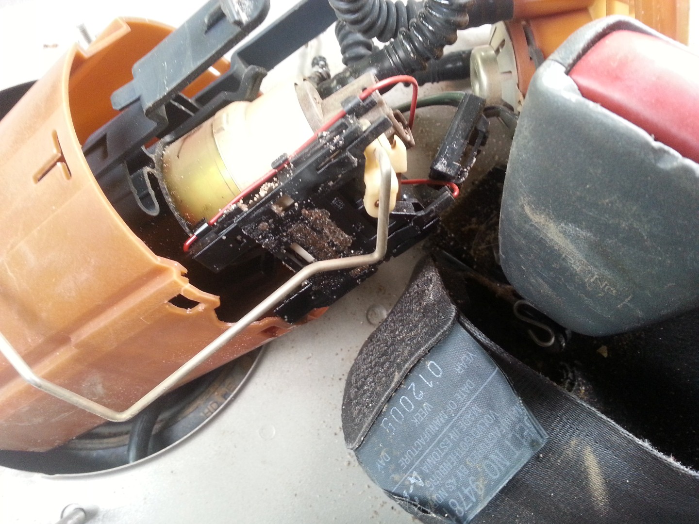

Showing the 2 tabs to depress before removal of the sender resistor (press both in and pull up with pliers)
Two tabs to press and the sender resistor can be removed

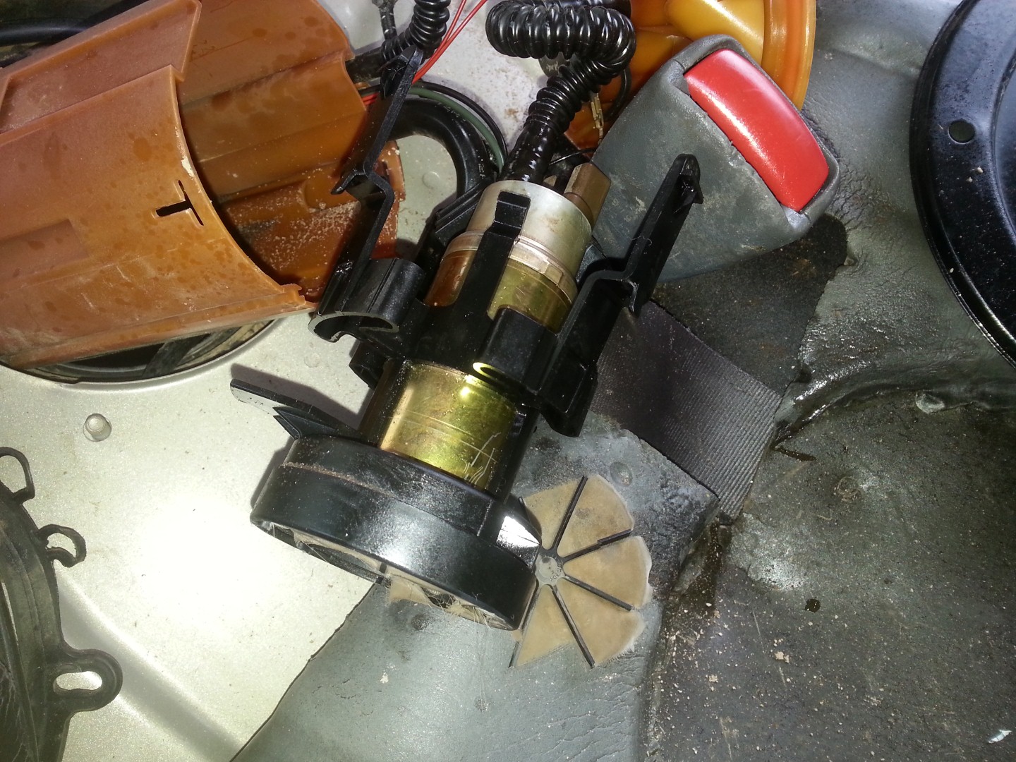

There are 3 tabs like this around the housing to press in and then pull the pump upwards

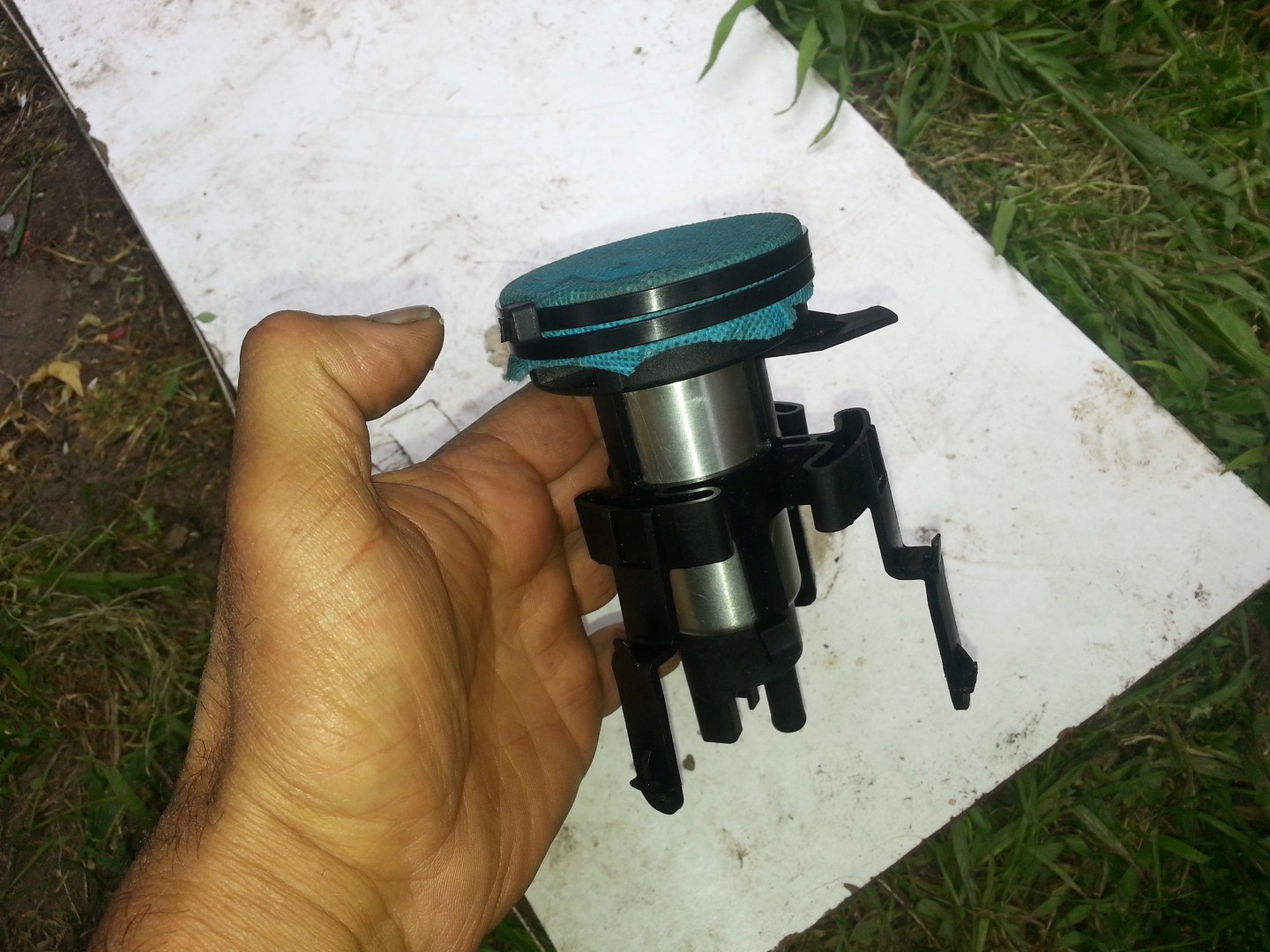

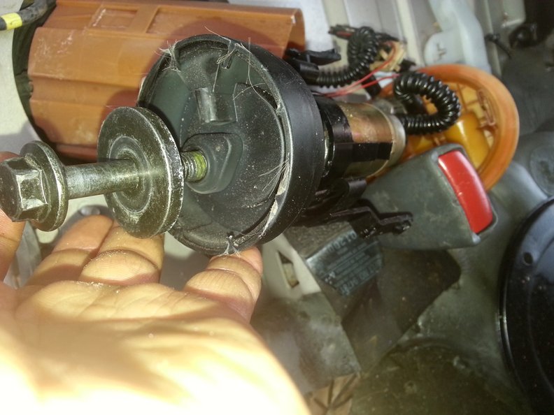

The old gauze filter needs to be removed because in this case I couldn't pry the pump out

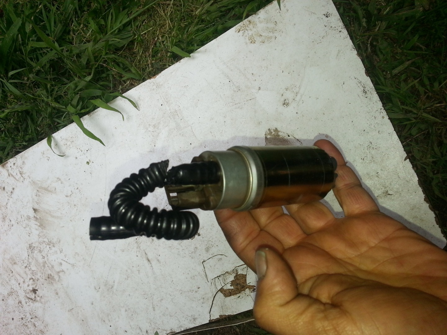

The pump removed awaiting further extraction (notice I have already torn the gauze filter away)

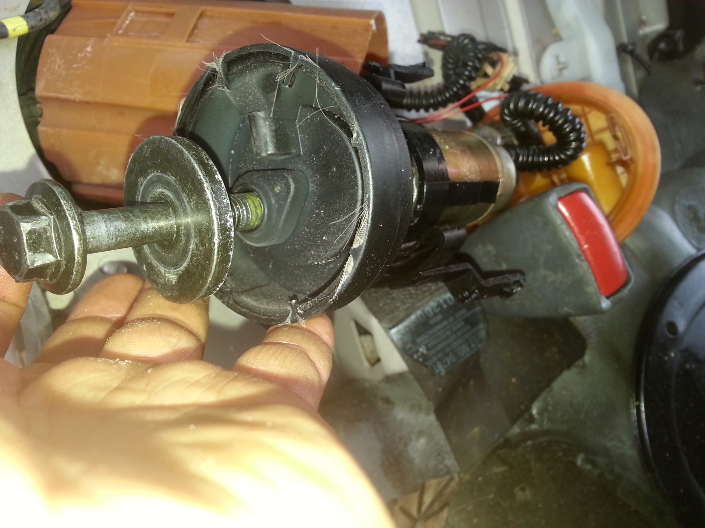

Forcing the old pump out with a 1999 plus axle bolt (end of pump is metal)

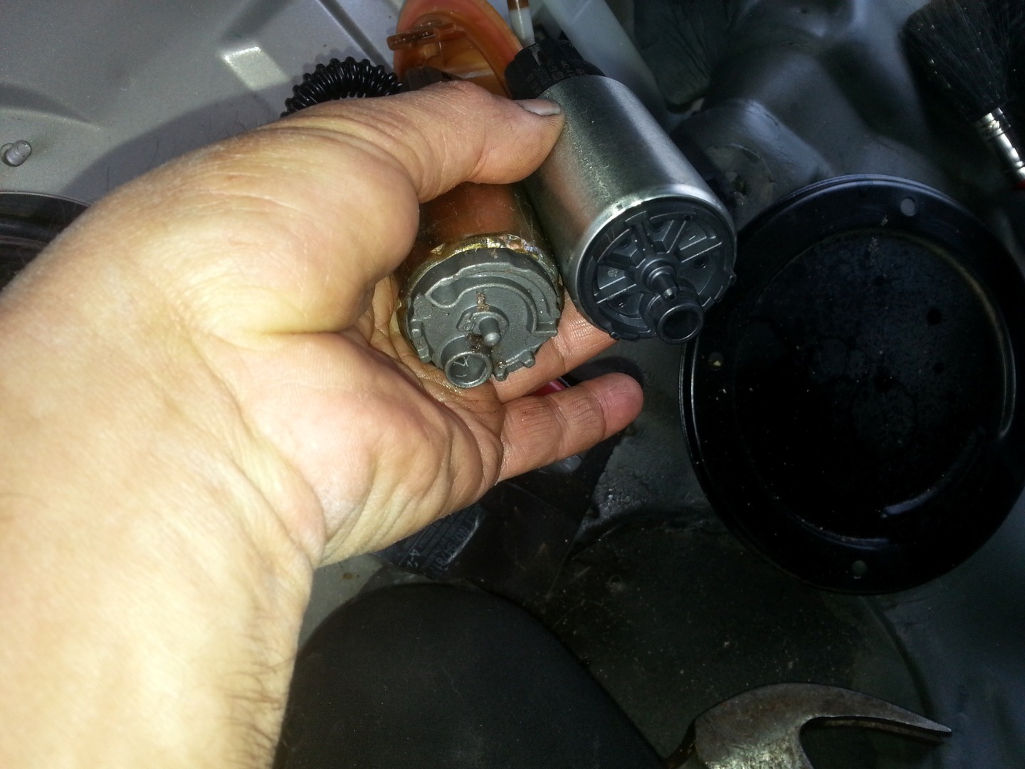

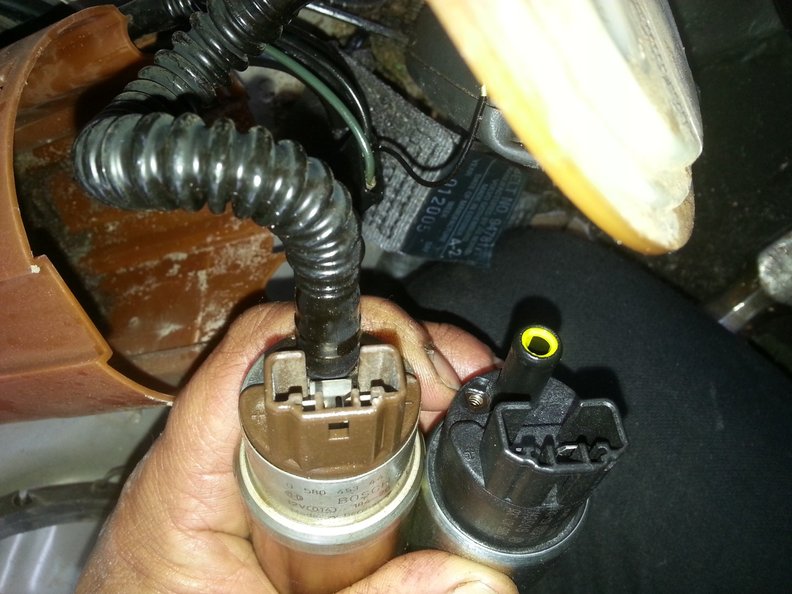

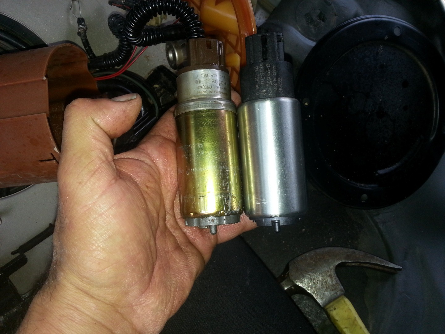

Pump bodies are both 38mm
Tops are a very close match
Ends are near identical

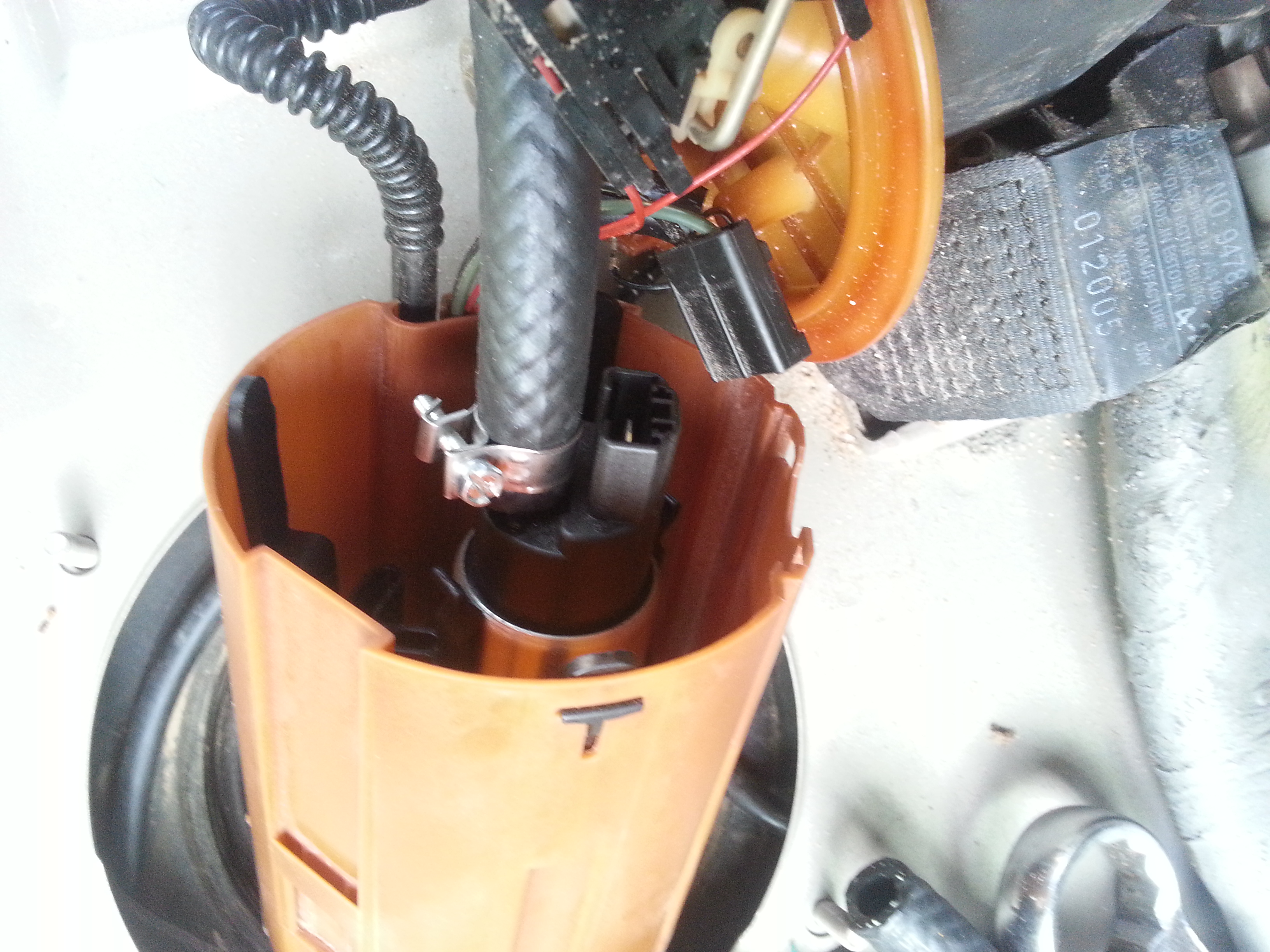

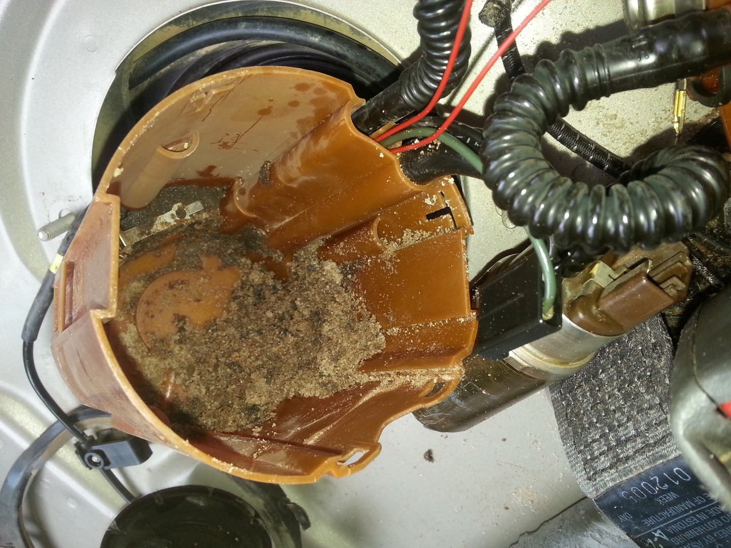

Housing assembly after pump removal

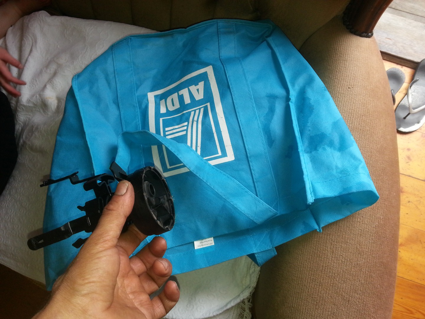

Hmm my wife won't miss this shopping bag

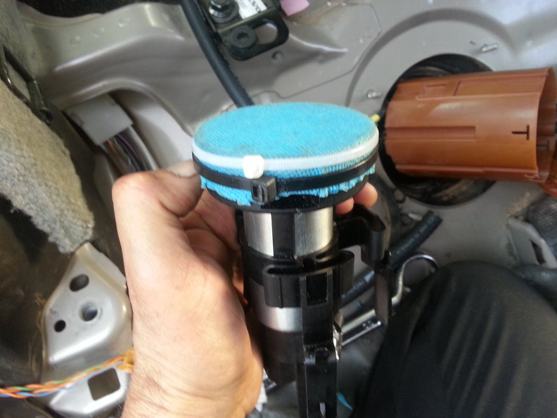

Place some assembly grease on the tip of the pump inlet and hit the pump onto the gauze housing (gently)

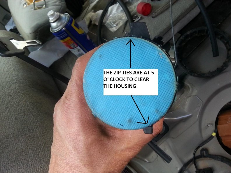

Please note that the ties are not in their final position to clear the housing
The original hose can't be removed without breakage.  I used a Stanley knife to slice it carefully
Zip ties @ 5 oclock to the protruding plastic piece
I used 2 zip ties for safety; hope they last

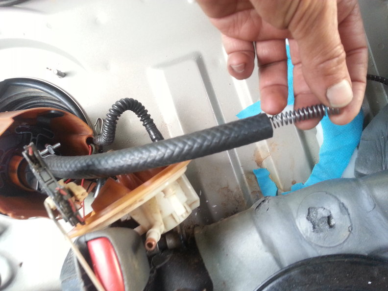

Instead of using this much like I first did, it's best to cut the spring in half and stretch it to the length of the fuel hose
Clamp the submersible fuel line to the new pump
Insert stiffening spring (you can use twice the spacing I used to have a more flexible hose)

A new revelation has surfaced as I discovered that the gauze filter separates from the plastic housing with some patient prying evenly around the edges. Hence no need for shopping bags :roll:
