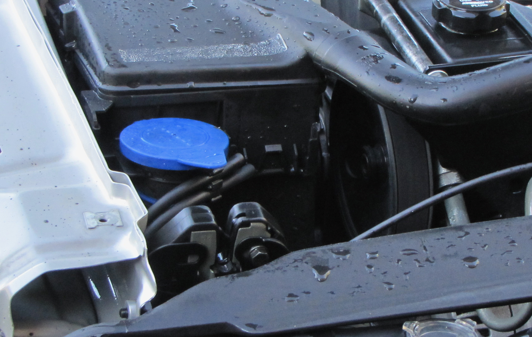

Looks like you have a lot of work to do...

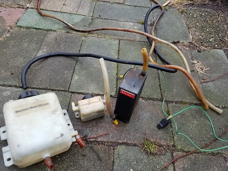

No idea what the extra tanks are about - Water injection, maybe?
And the food grade plastic hose sure isn't stock. You usually see
that clear hose with the nylon reinforcement webbing in soda
and beverage dispensing systems. It's certainly unique!
I wonder if they're running some kind of oil catch can?
The wire off of the positive clamp looks like it has a circuit breaker
can connected to it. I agree with ditching it. Between that B+ lead and
the relay on the fender wall, someone may have had a set of driving
lights installed. Ne telling with out chasing down where the green and
black wires go.
Don't sweat the "cut off" rubber lines - Those are vent tubes.
And the factory alarm horn on the firewall? It's missing parts.
Might as well remove it, because it's not gonna work like that.
First thing that I would do is get out the pressure washer
and blast a few layers of debris out of that engine bay.

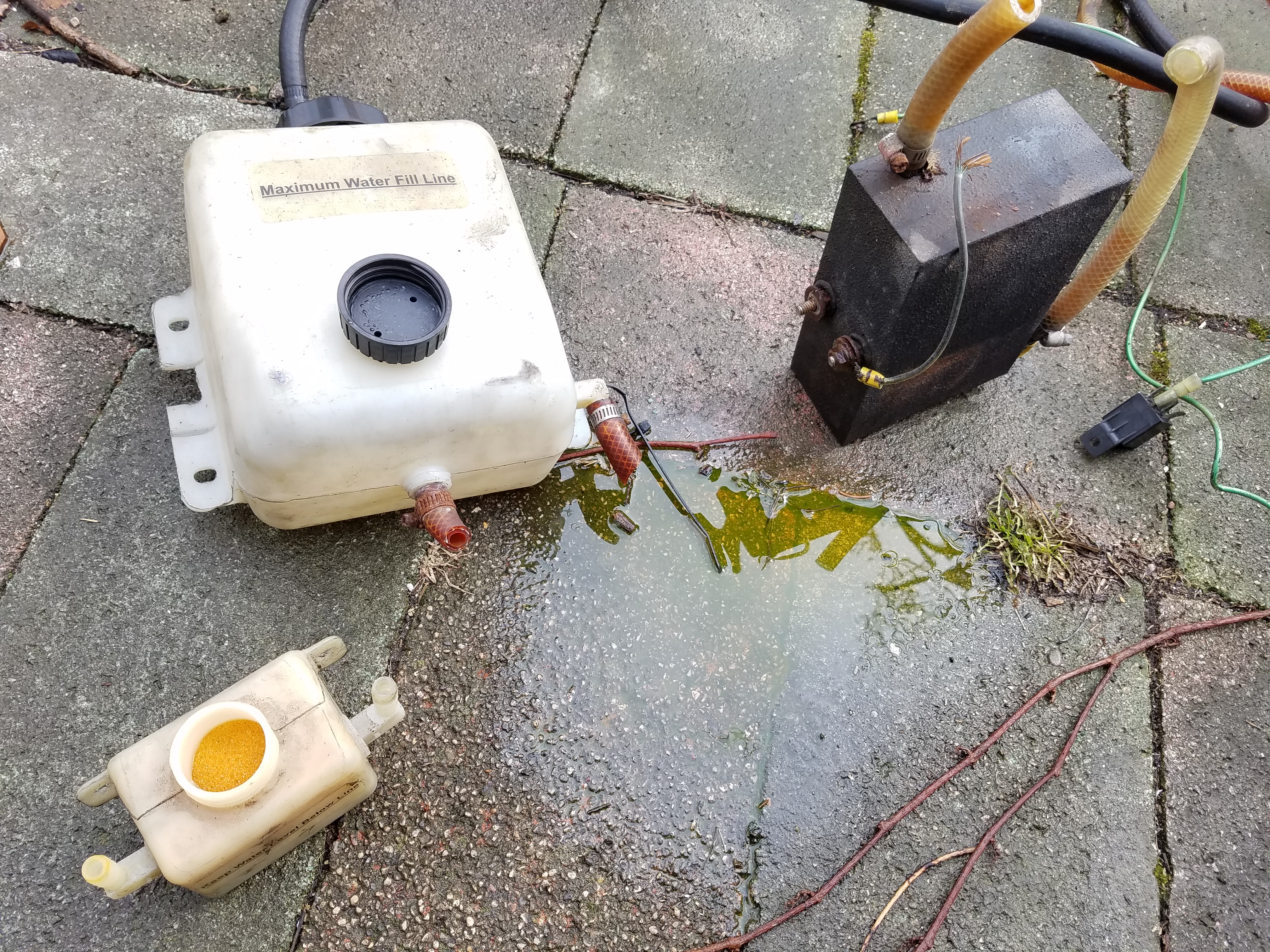

You are going to have fun with this project. Both of those liquid bottles are not Volvo things. Nor are the two garden hoses or the relay(?) screwed on to the fender. You need to follow the hoses and electrical lines and make a determination as to what they do. My guess is that you will be throwing quite a few things away.

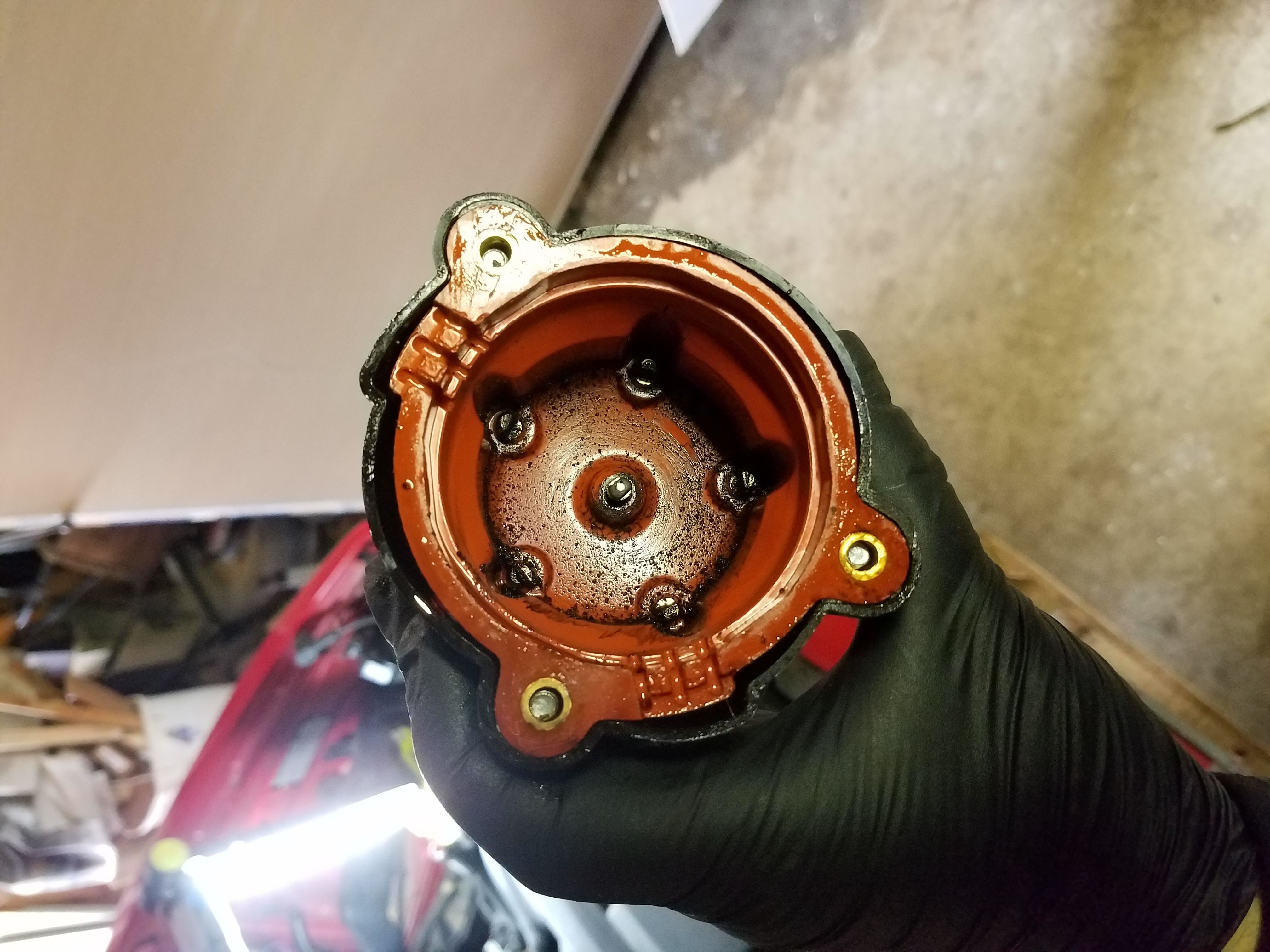

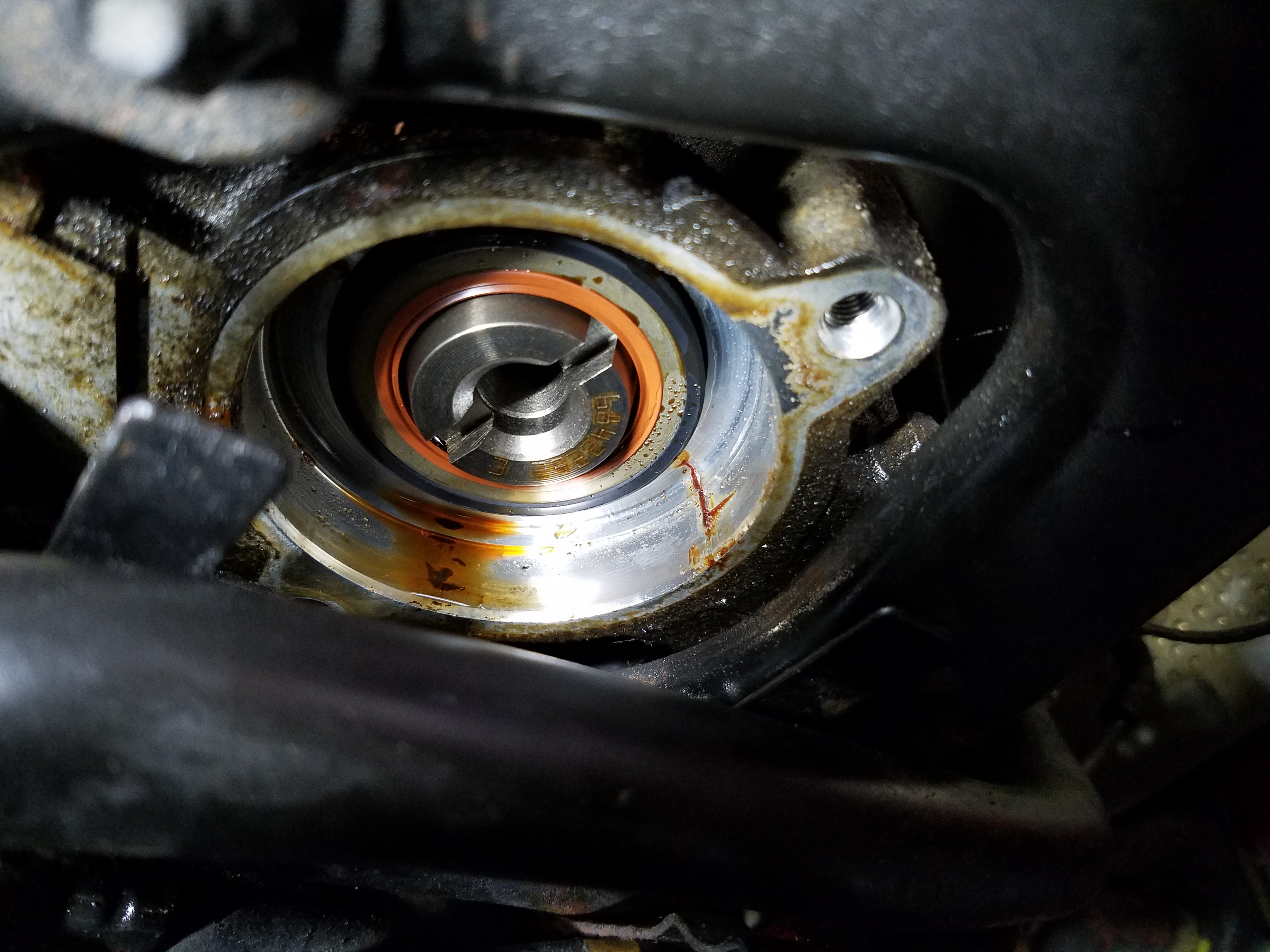

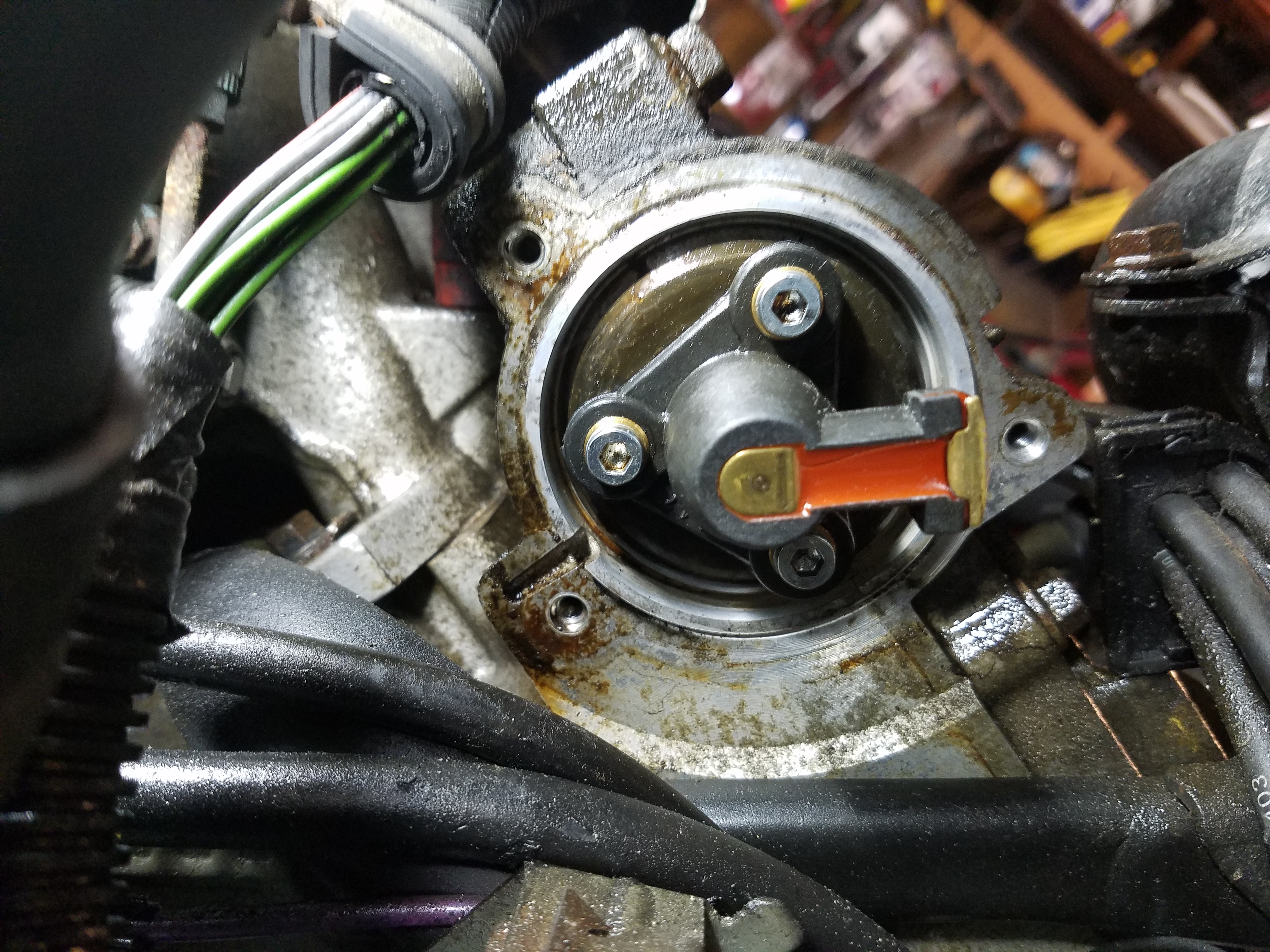

I was cranking the car over with the recharged battery (11.68 volts) and it wouldn't stay running. I added some fuel and checked the distributor/rotor and it was filthy! Oil and gunk build up. I cleaned it with brake cleaner and put it back together and started to crank the car and it was struggling more than usual and after a few cranks it POOFED! White smoke smelling like oil and electrics appeared and i stopped immediately. I noticed oil pushed out of the oil cap and smoke was coming out of the engine when i removed the oil cap.
I thought i put the distributor on wrong, so i removed it again and it had some oil in it again...
Any ideas?
Also i removed these quality pieces from the cars previous owner.(looks like coolant/water cooler tank?)

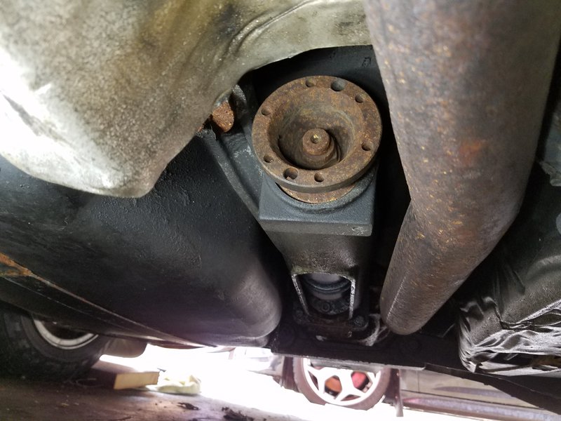

Also noticed they removed the driveshaft while i was underneath there. (i remember seeing a driveshaft near the car when i bought it but didn't put the two together)

The oil in the cap is due to a blown rear cam seal. Presumably clogged PCV is blowing the seal(s). You need to remove the little plate under the rotor, to push the seal back in. Note the orientation of the plate, for reinstall purposes. Longer term you should get new rear cam seals, just get them both (for both cams), be sure to buy Corteco. In the meantime leave the oil cap off/cocked when starting so the clogged PCV doesn't blow any more seals.
Edit: also, be sure to plug any now-open holes after removing the spare plumbing parts, e.g. that one in the turbo charge pipe leading to the intercooler.

Hopefully you will figure this thing out, but I would reconsider if the rear main is indeed blown. As was said already, the intricate hose and canister set up was probably used to relieve pressure from the PCV. Not a good sign, PO didn't know what was going on.

erikv11 wrote: 26 Mar 2017, 13:11 The oil in the cap is due to a blown rear cam seal. Presumably clogged PCV is blowing the seal(s). You need to remove the little plate under the rotor, to push the seal back in. Note the orientation of the plate, for reinstall purposes. Longer term you should get new rear cam seals, just get them both (for both cams), be sure to buy Corteco. In the meantime leave the oil cap off/cocked when starting so the clogged PCV doesn't blow any more seals.
You were right it was the rear cam seals, both were leaking and pushed out but the one under the rotor was actally pushed off and just hanging there(forgot to take pics).

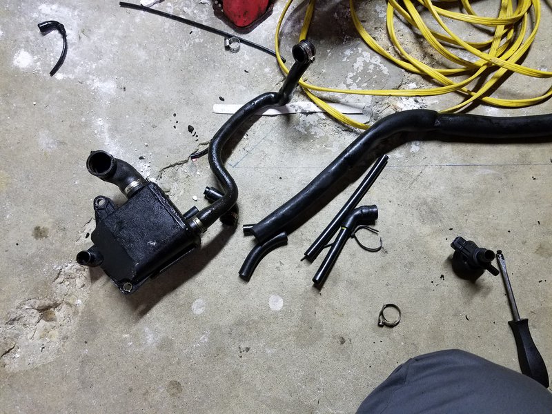

I just got done removing the pcv system and while there was some gunk and deposits nothing was clogged? Also the pipes were so brittle as soon as i lifted them there broke into pieces.
