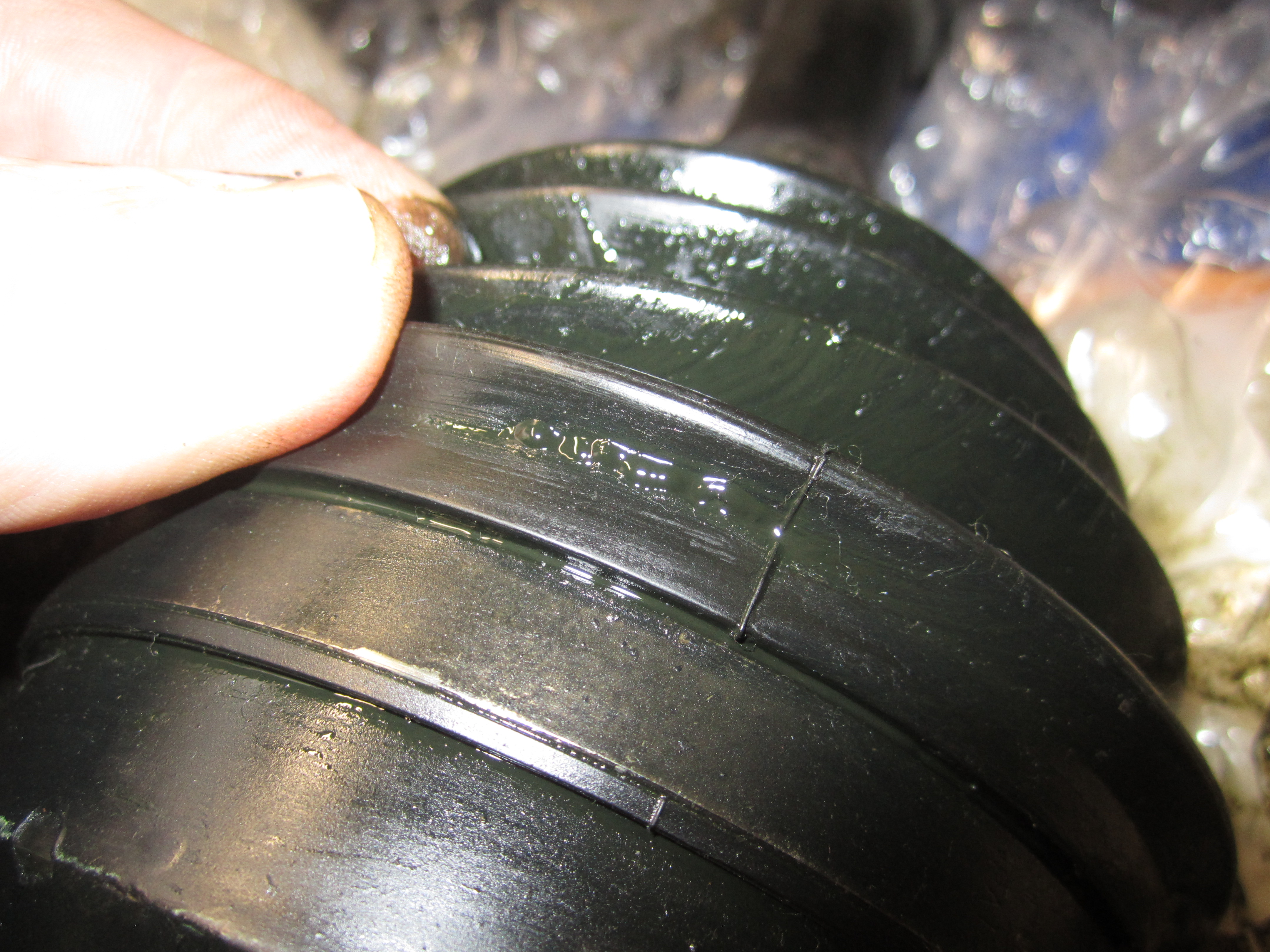

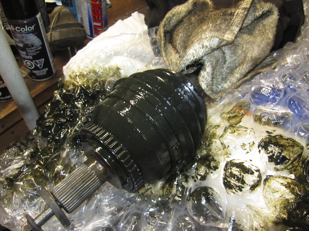

And the never ending bad luck continues with this car! Axle arrived today from Erie Vo-Vo. Opened the box to find axle grease covering the outer CV boot!
Took pictures and sent to them. I think this is the 'careful' handling UPS uses may have caused this. At first I could not see where the grease had come from, but then realised it was localised mostly. Cleaned the grease off and found a small split in the outer edge near the first corrugation. Amazing this small split had allowed so much grease to escape. Probably didn't help UPS stored delivered it with the outer boot down with the box on it's end.
I've sent a note to Erie and see what they suggest. The inner boot and carrier bearing seem fine, so I could fit the boot I bought to repair the original before finding the noisy carrier bearing. Man this car pisses me off now! If it wasn't for bad luck, there would be no luck with it!!
grease in the front of the fist crease is where the split is.

Packaging and axle as delivered
Different view
Different view
