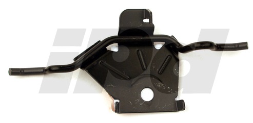

Stumbled onto this S70 (I think) part (Volvo #9470686) that simplifies the overly complex
sandwich design in the 850. Hold down the bracket with the big bolt, eliminate the sandwich
and two extra bolts - link says it fits 850, hope that is correct, about $18:
From FCP: https://www.fcpeuro.com/products/volvo- ... et-9470686
From iPd: https://www.ipdusa.com/product.asp?P_ID ... ory=basket This looks much better than the aftermarket part from ebay, also for the S70, the
Volvo factory part is around $50 but there is an aftermarket copy from iPd for about $19:
Link to iPd part: https://www.ipdusa.com/product.asp?P_ID ... ory=basket
I'm going to try these.

Installed the Volvo #9470686 single piece part and after trying it in different positions
I concluded that the hook part of the metal did not fit so I hammered it flat. After I
installed it I noticed that it did line up with one of the holes and you probably just have
to go in at an angle to get it in. Good enough as it is and I like the one piece design.
I had the ebay clamp on pipe hanger on upside down, it fits fine with the nuts facing
down toward the ground. It was an easy job and it all fits nicely now.
