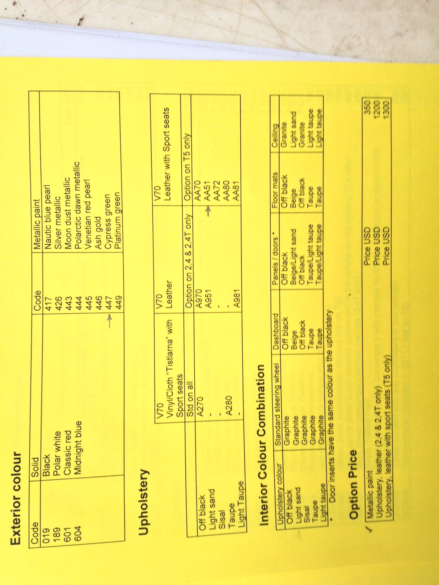

leapdragon, Thanks for your updates. I think your dye company has it partially right...different color names are used for different markets, but I don't think Oak was used in the Euro market, at least in 2001. I have the European Sales Order spec sheet (option sheet) for my 2001 V70 T5 that was ordered in Germany and shipped to the US. Car was built for the US market. For the Upholstery color codes, they clearly state Taupe is AA80 for the T5 Leather Sport seats. Other T5 options are Off black (AA70), Light sand (AA51), Sisal (AA72), Taupe (AA80) and Light Taupe (AA81). Options for the 2.4 and 2.4T are also listed, they start with A9XX. They also list cloth upholstery options. They start with A2XX. I could be wrong, but I don't think any cloth upholstery options were available in the US.
I believe that starting with the interior code is the way to go. Whether you call it Taupe or Oak, B980 (XC70) should look similar to AA80 (V70 T5). It's probably listed as XX80 for a S60.
At any rate, good luck color matching. Share your results when you are finished.

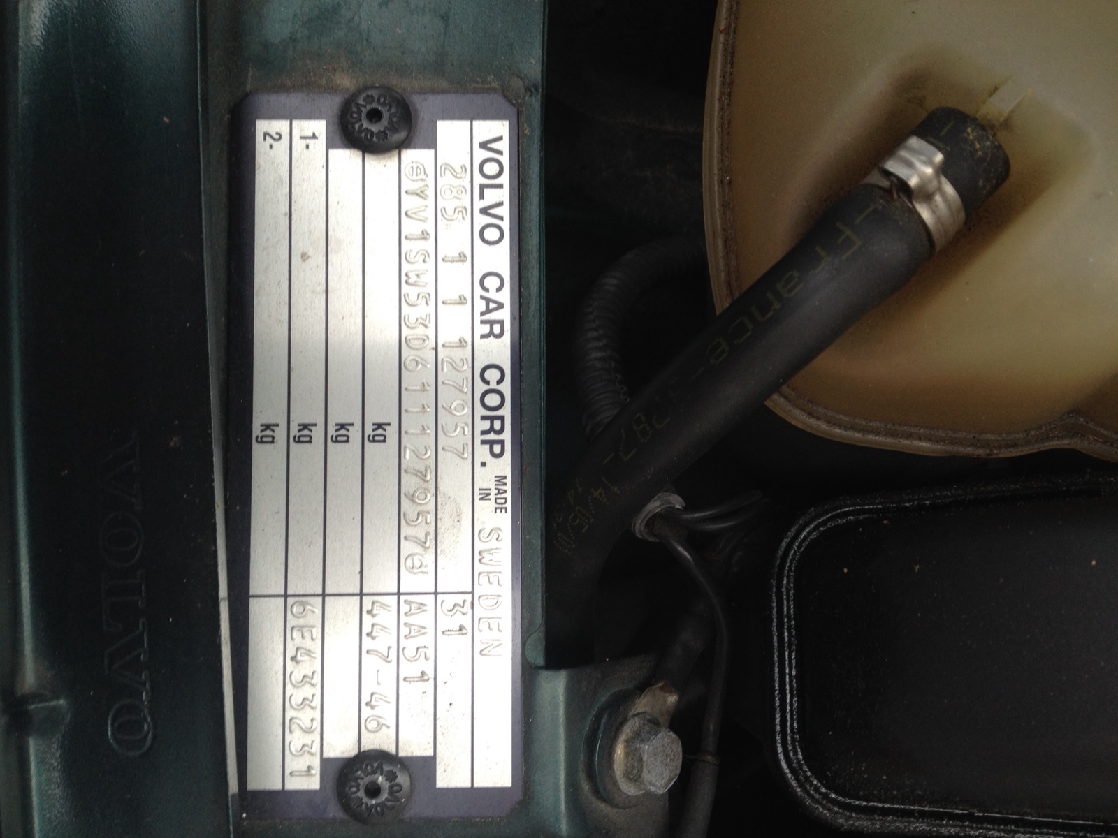

I'll try to help.
1st, could you be more specific with the car, is it an NA, a 2.4T or a T5? This will help in confirming what color option she may have.
2nd, Go to the car and open the hood. Look for a silver/aluminum data tag like this. Take a pick and share or write down the upholstery color code...AA51 in this example. 3rd, compare your number to this sheet to determine the exact color. This is a 2001 build option sheet, but I figure the 2002 models probably carried over many of the same options. Once you have the exact match, you can buy online or find a junk yard donor car with a similar color code/color. Be aware that the same color could have 3 different color codes, dependent on the model (NA, 2.4T, T5). For example, Off black could be A270, A970 or AA70.
Good luck.
