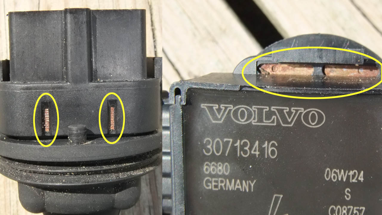

Quick update. I didn't make any changes to fix the ignition coil. I was able to start the engine. I've been driving it for three days with no issues so far. No visible or audible issues, and no codes thrown (misfire, etc). Today is humid and drizzly and there were no issues starting this morning.

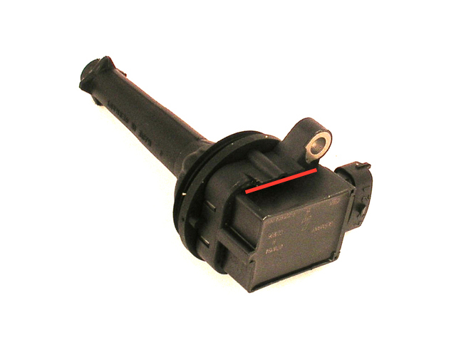

I was looking at all of the ignition coils, and noticed that all of them actually have two small sections of this material exposed, apparently by design. I don't have my own photo of this at the moment, but you can try to visualize from the line I drew on this photo. When viewed directly from the top, there is a channel in the plastic on either side of the coil, and at the bottom of this channel, there is a gap in the plastic that shows a thin strip of the same metal I exposed when I cracked off the side of the coil.
This makes me lean more toward the theory that it's not a huge deal for this piece to be exposed.
I did receive the replacement coil in the mail from eBay. It looks to be in pristine condition, although I suppose a good external cleaning would belie any internal problems. If I'm not having any issues at the moment, I'm not sure it would be wise to replace it with an untested ignition coil... although I should probably swap it in so I can at least test it before my 30 day money back guarantee is up.
As far as the sealant, I haven't used it yet since I'm not having any issues with the coil as is. I guess I should use it anyway just to prevent excessive contamination of the underlying material.

Actually, the exposure is a big deal: the core is composed of sandwiched plates of a ferrous metal. As moisture invades the layers become separated by an oxidized film which alters the core's electrical and magnetic properties - not for the better.
