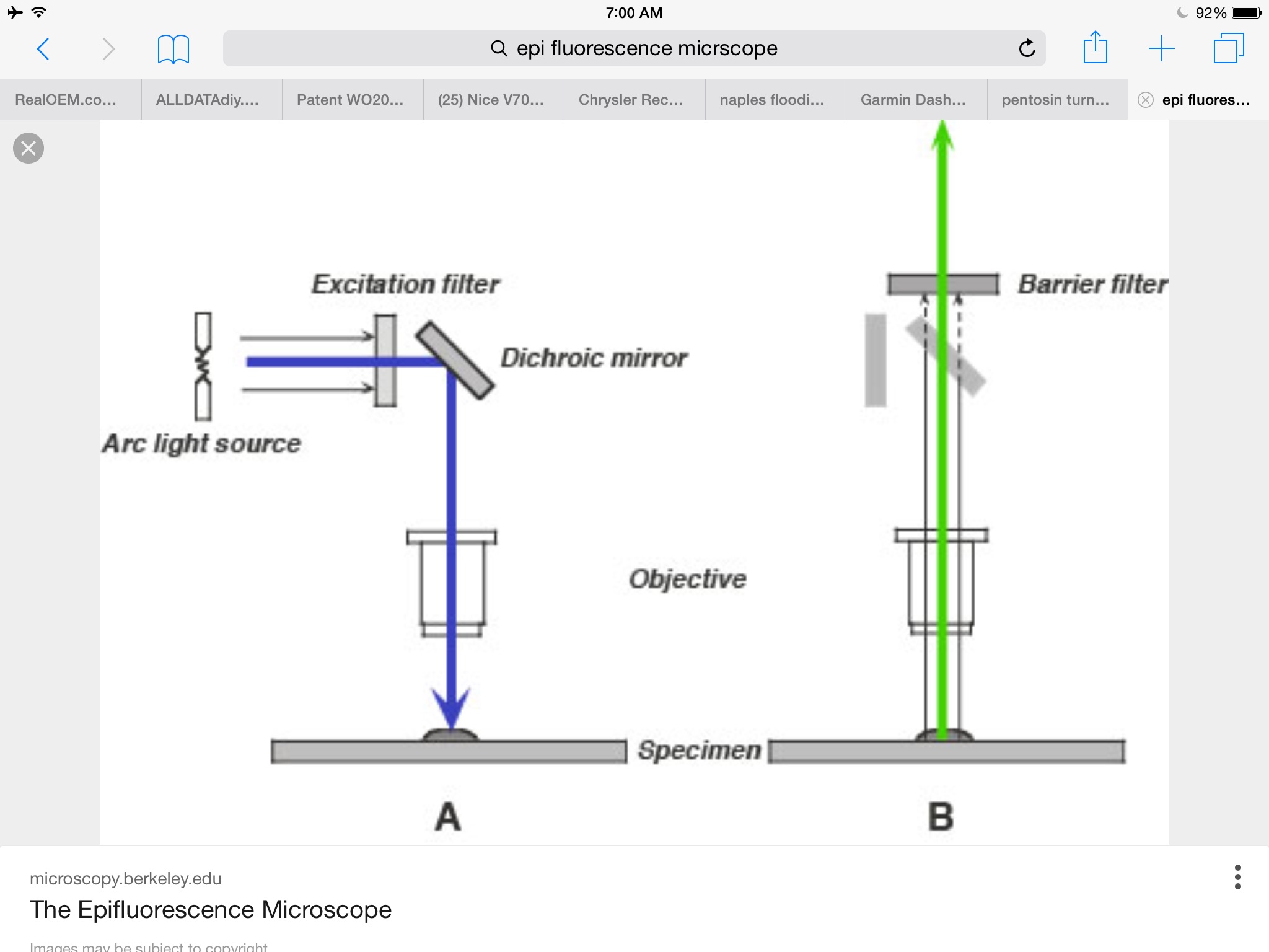

Here is how an epi works...you shine light in, then look through a filter for the light that comes out, which is shifted to a redder colour
