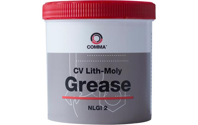

What I have done with my CV joints, is using the tip of a cutting pliers to bend the 'u' portion of the Oetiker clamp open until the clamp released, then clean all the old grease inside and put about 1/4 cup of lithium/molybdenum grease
http://i1.adis.ws/i/washford/634949?w=637&h=403
I then used a lighter Oetiker clamp to close the boot with some chinese clamp pliers because the original clamp is impossible to close back again.

Are you talking about changing CV grease as a routine maintenance task? I never have, but I could see you may consider it if the boots are long-lived. I have only changed out the CV grease when a boot has cracked.oragex wrote: 21 Sep 2017, 08:33 ...
