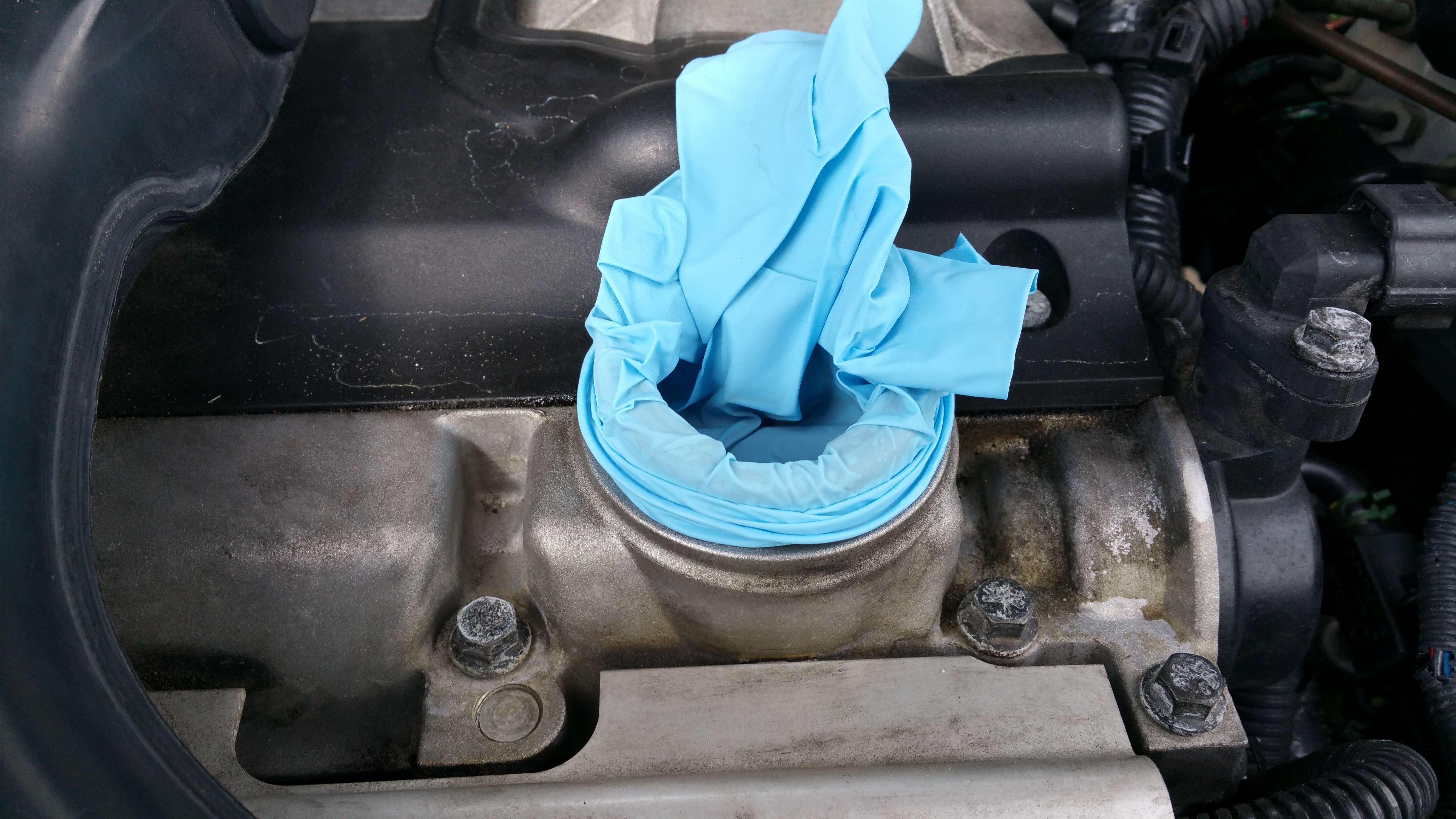

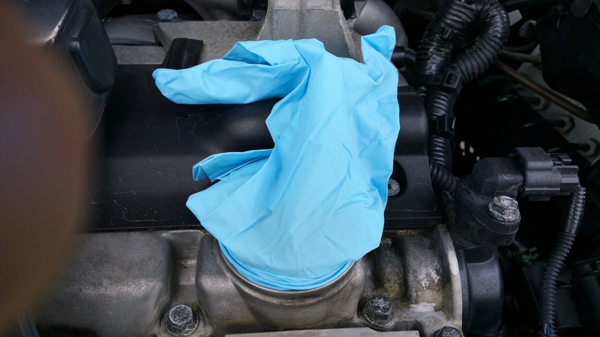

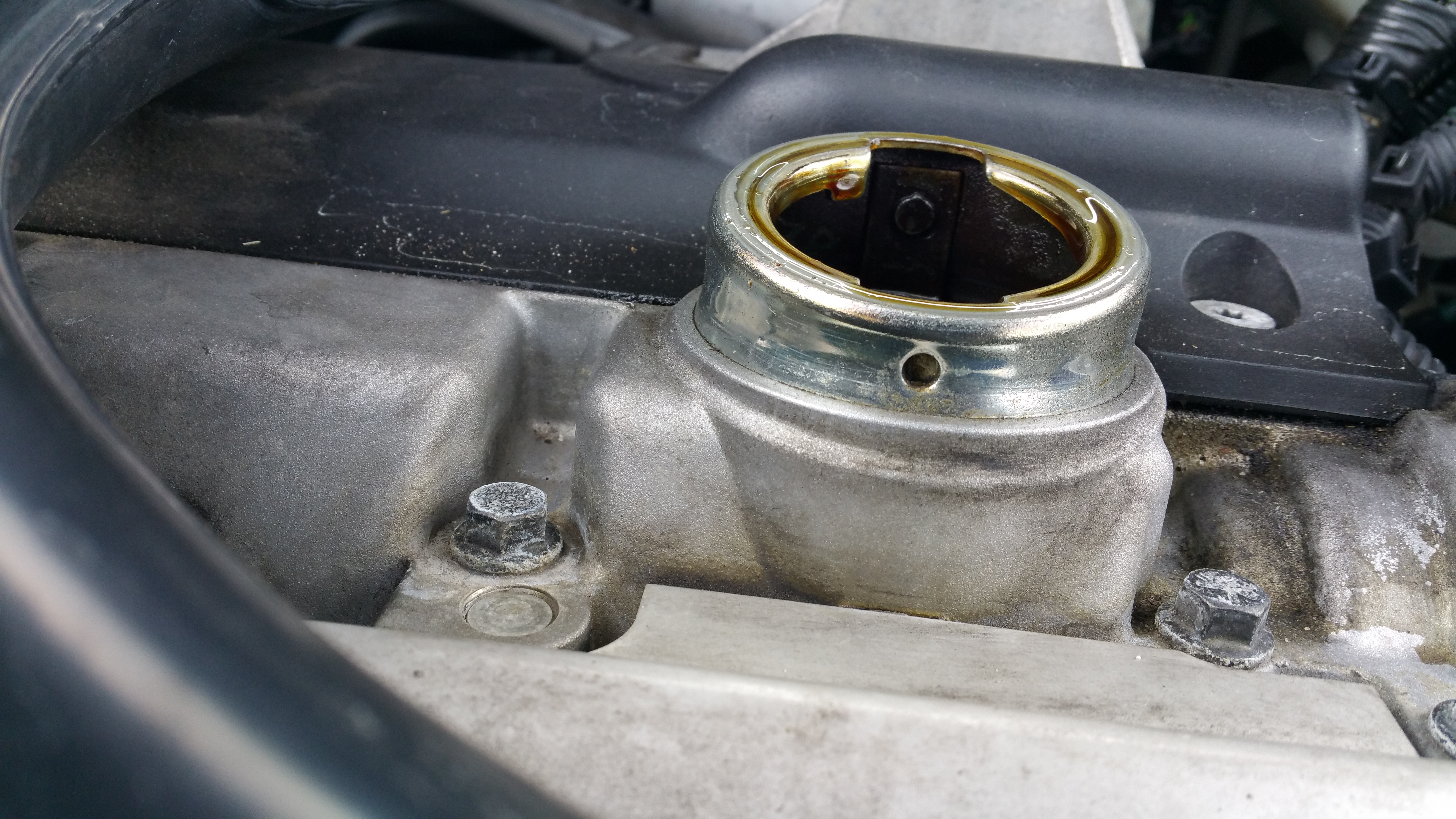

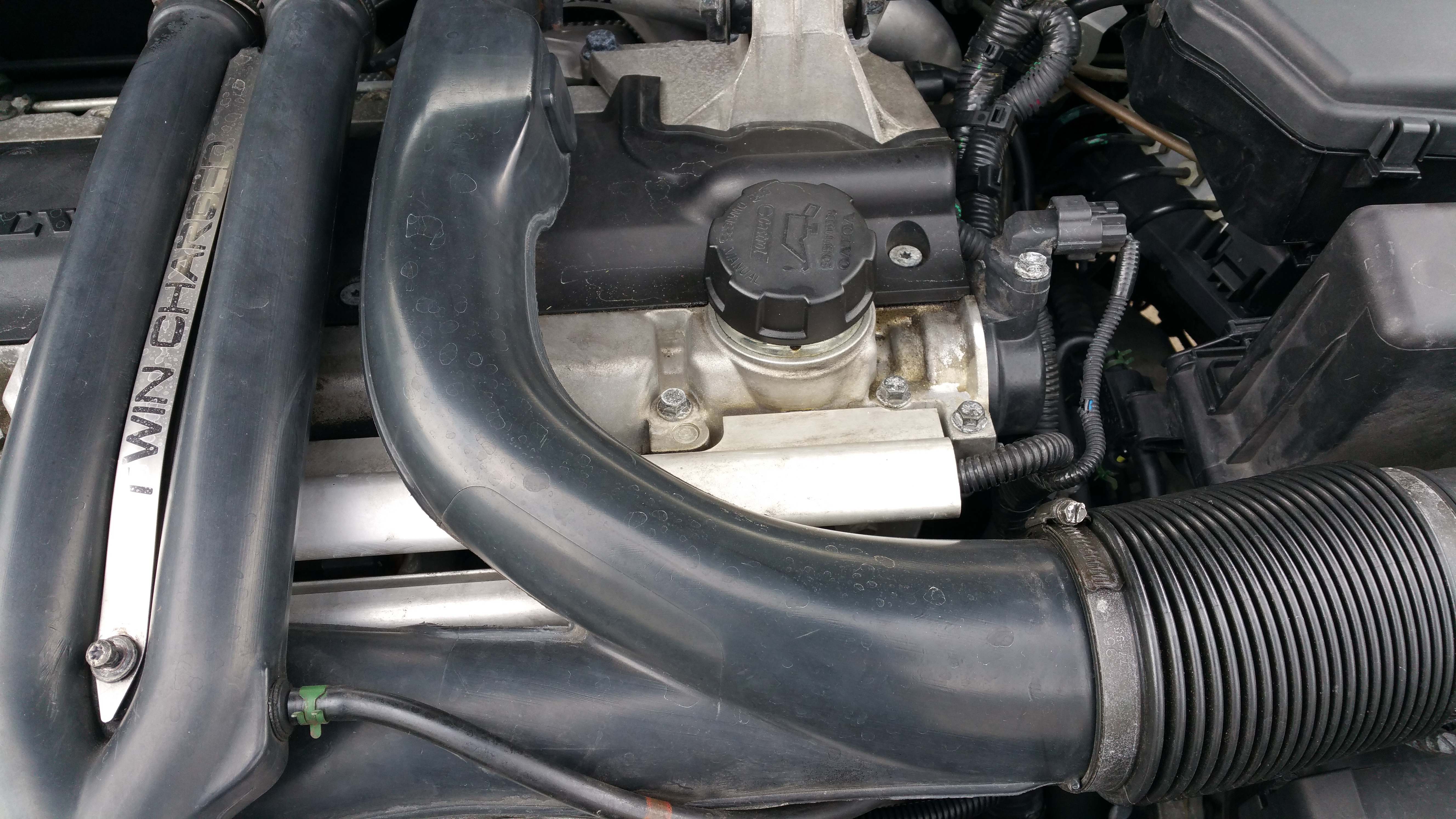

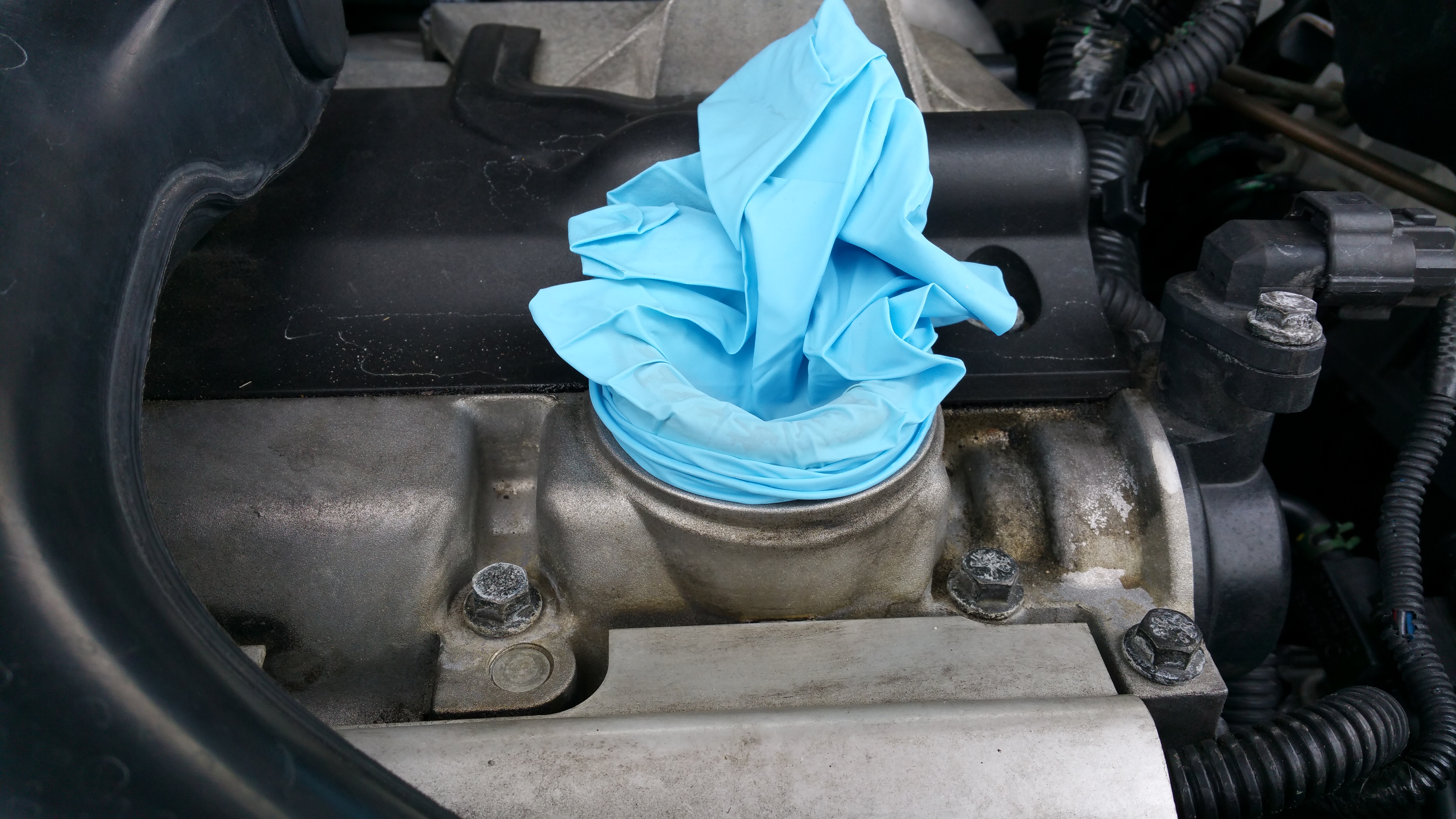

2000 rpm
Idle
Just fitted glove engine off
Lip to install glove on
What you see when hood is first opened
This is the pcv test talked about above by others. Very important the pcv always works properly otherwise expensive seal replacement will result.
Open hood
Remove cap
Notice lip has room to put glove over the lip
Next photo is the glove placed over the lip engine off
Next photo is started at idle
Last photo is 2000 rpm.
This is what the glove test on pcv should look like if all is ok. This is my 2004 S80 T6 2.9L twin turbo engine at 145K this morning. There should be a grate to prevent glove from going into the engine. My car has had 6 month 3,000 mile change interval full synthetic changed at Volvo and my pcv is completely original. I bought my car new and when my children were in school I did 1 mile trips twice a day causing black carbon buildup under the oil cap and likely internal as well. Wish I had been a little more on top of it. My car still runs and drives like new however. Your 5 cylinder should have the same oil cap and filler neck. My dipstick seats firmly with tight seal so I just left the dipstick firmly in. My photos are in reverse, sorry. June
