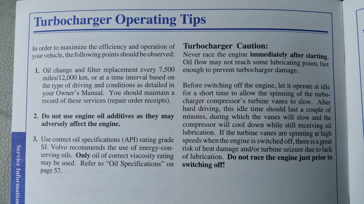

Just a afterthought on my part. You owned Honda before Volvo so maybe you are not aware of the turbo rules. Theyare universal among brands with turbo engines. I photographed the information from my 2004 book. I have never had a turbo fail on any of the 5 cars that had turbo.6yKailee wrote: 24 Sep 2017, 17:41 Thank you for the replies. I realize most anything is a relative gamble and I know I'm not in this car to make any money. The water pump/ timing belt replacement by a mechanic would have been enough to total this car given its mileage. It surprisingly was a 1 owner with records from Volvo until it ended up in a second hand used lot, then my lucky hands. I've replaced the turbo once after snapping the impeller shaft due to a low oil condition caused by gunked up lines. With this being a pretty serious hit it's strike 2 for me. Monday morning I'll be talking with a local shop about potential. I'll be honest though, I'm missing my old Honda.
To not follow the shut down rules starves the turbo of oil resulting it turbo damage and failure such as your car experienced. I always follow the turbo start up and shut down rules. They were explained to me originally when I bought my 1989 Volvo turbo new. Every booklet for every turbo I have owned had similar if not the same to say as the following photos. June
