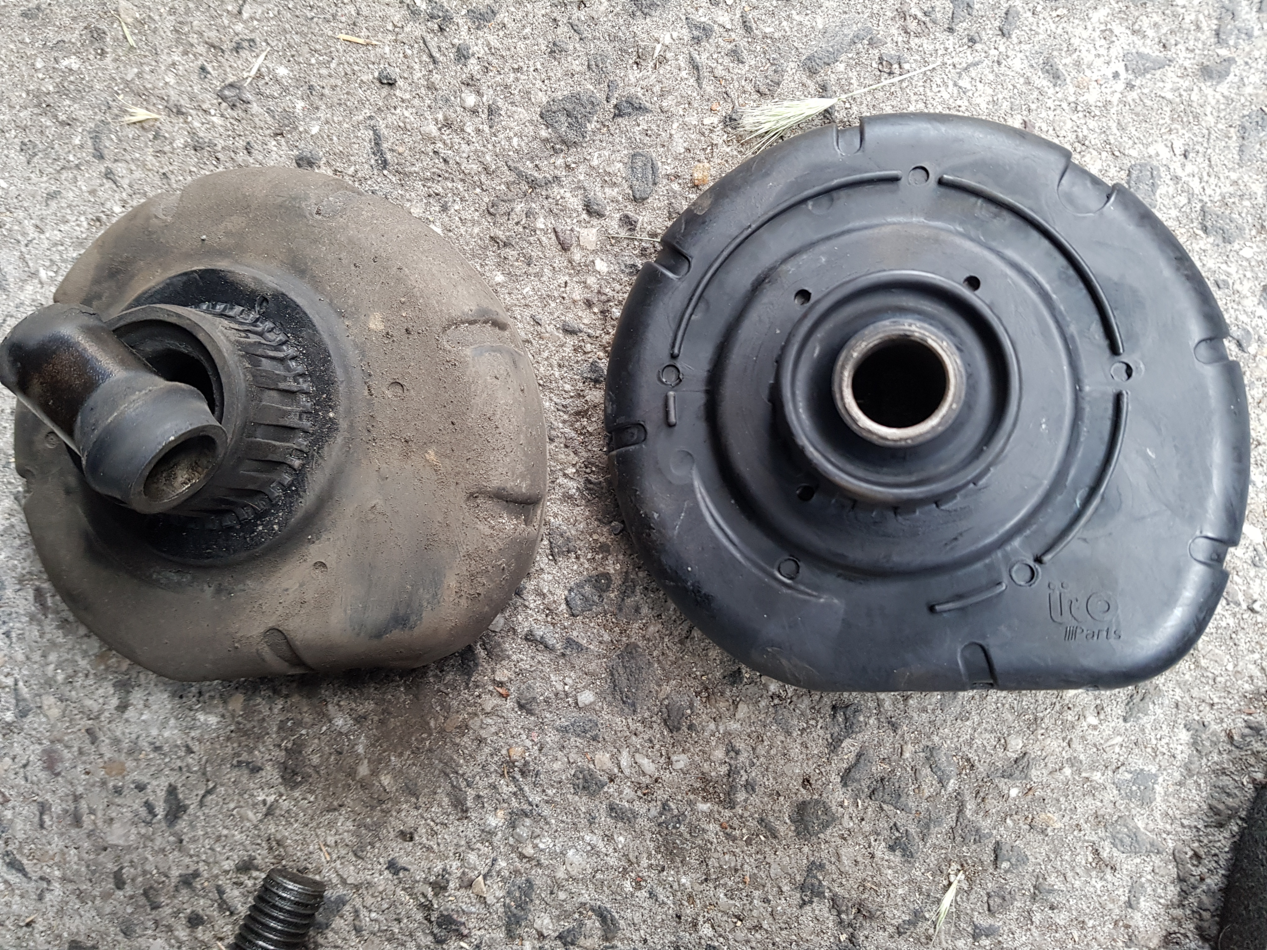

Replaced both front spring seats.
Pro Parts spring seats let me down after about 25,000kms
Cost: $70 AUD

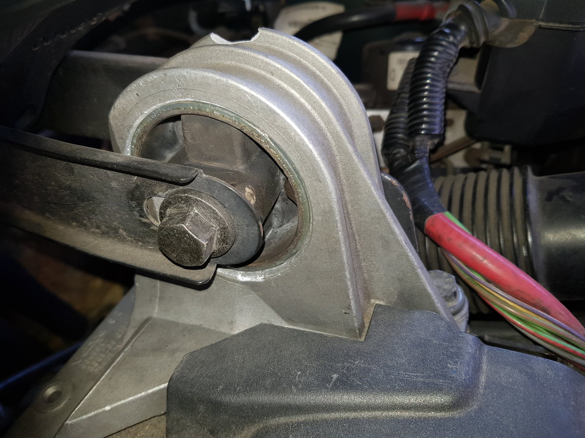

Replaced the tired old engine support stay with a new one. I pressed a Pro Parts one in with a plastic external rim after taking almost an hour to cut out the original Volvo metal one.
Cost $15AUD

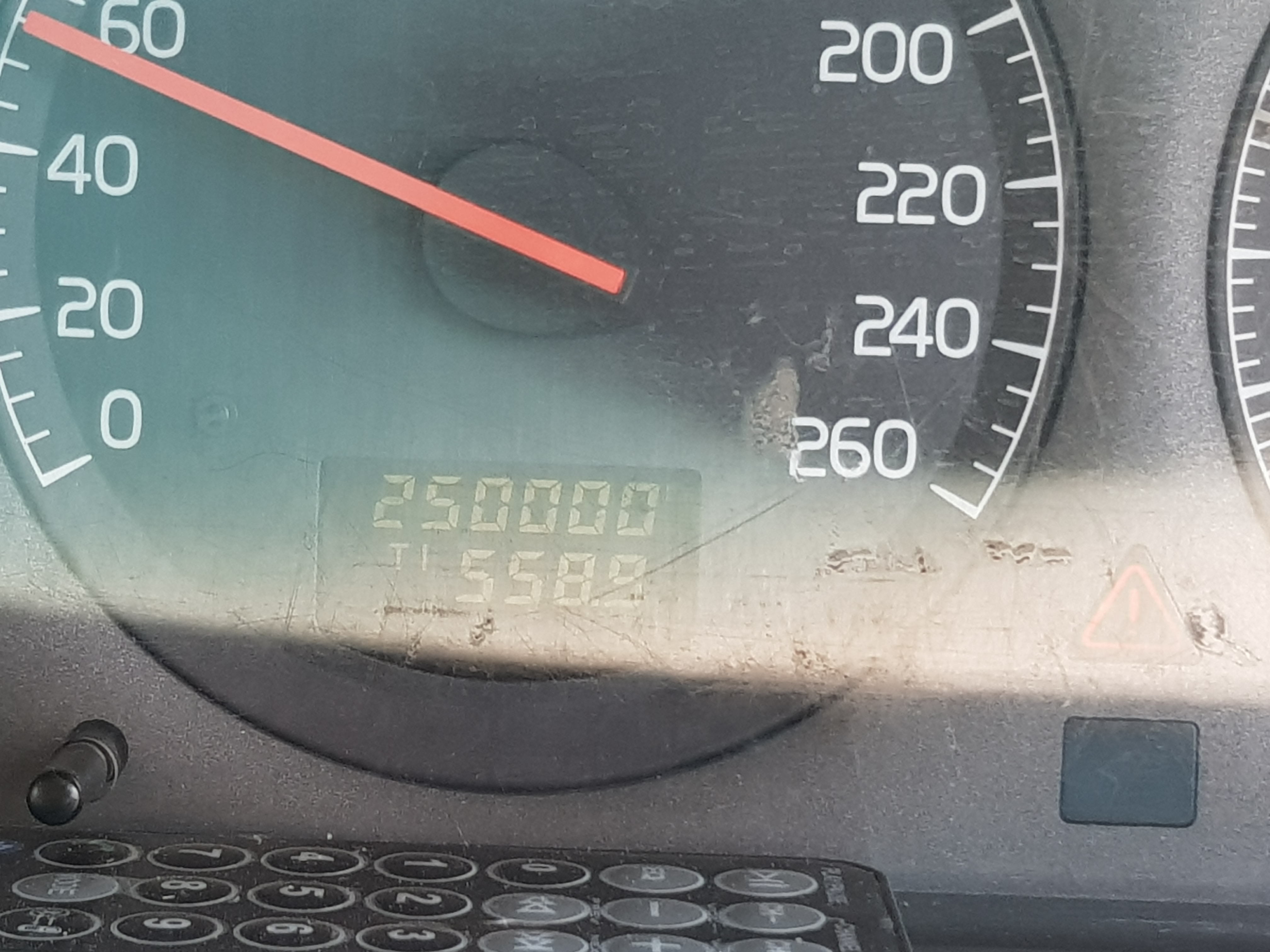

Hit 250,000 kms today.

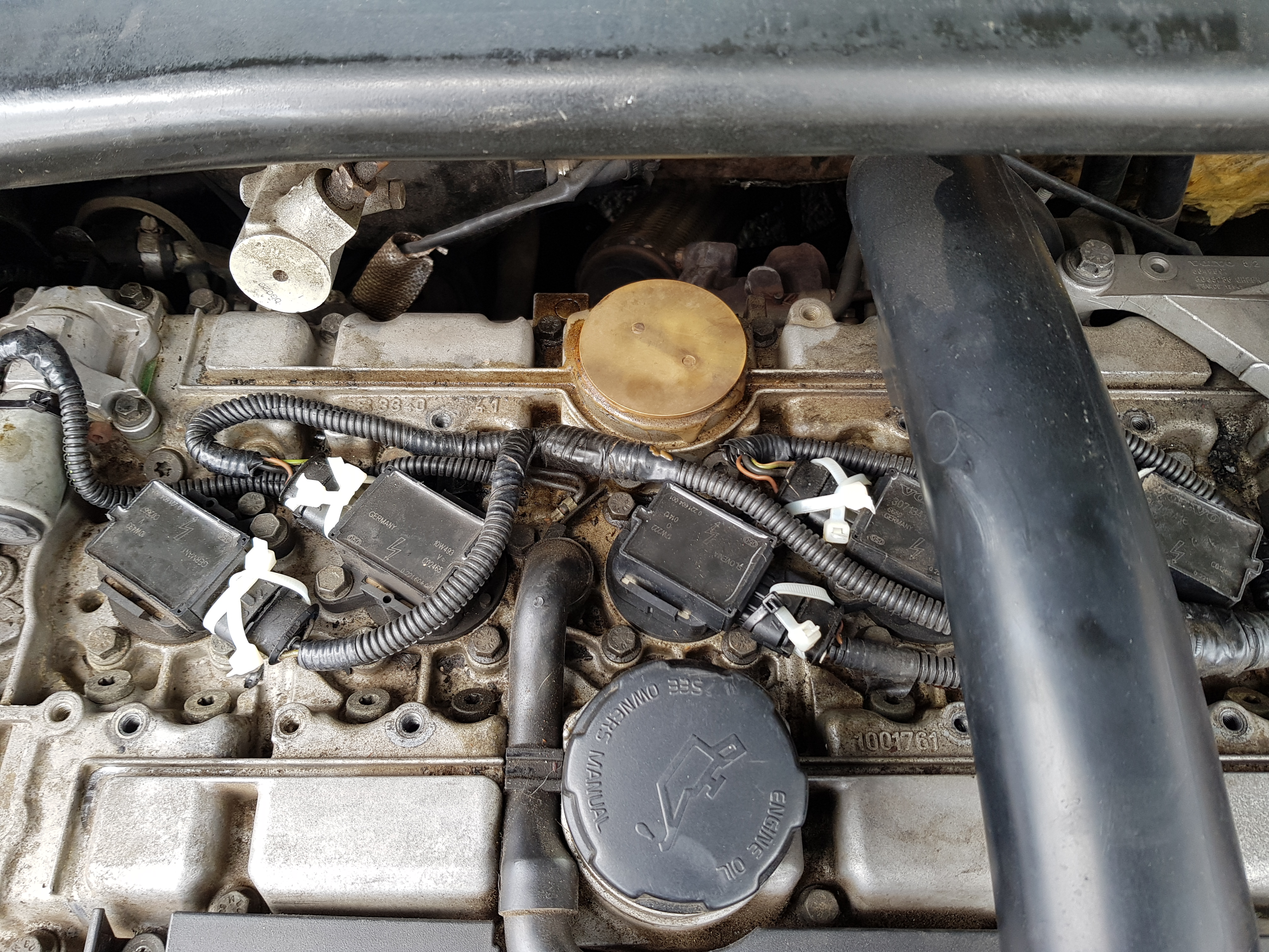

Cylinder 3 misfire again; connectors secured with high tech "Coil Connector Secure" TM

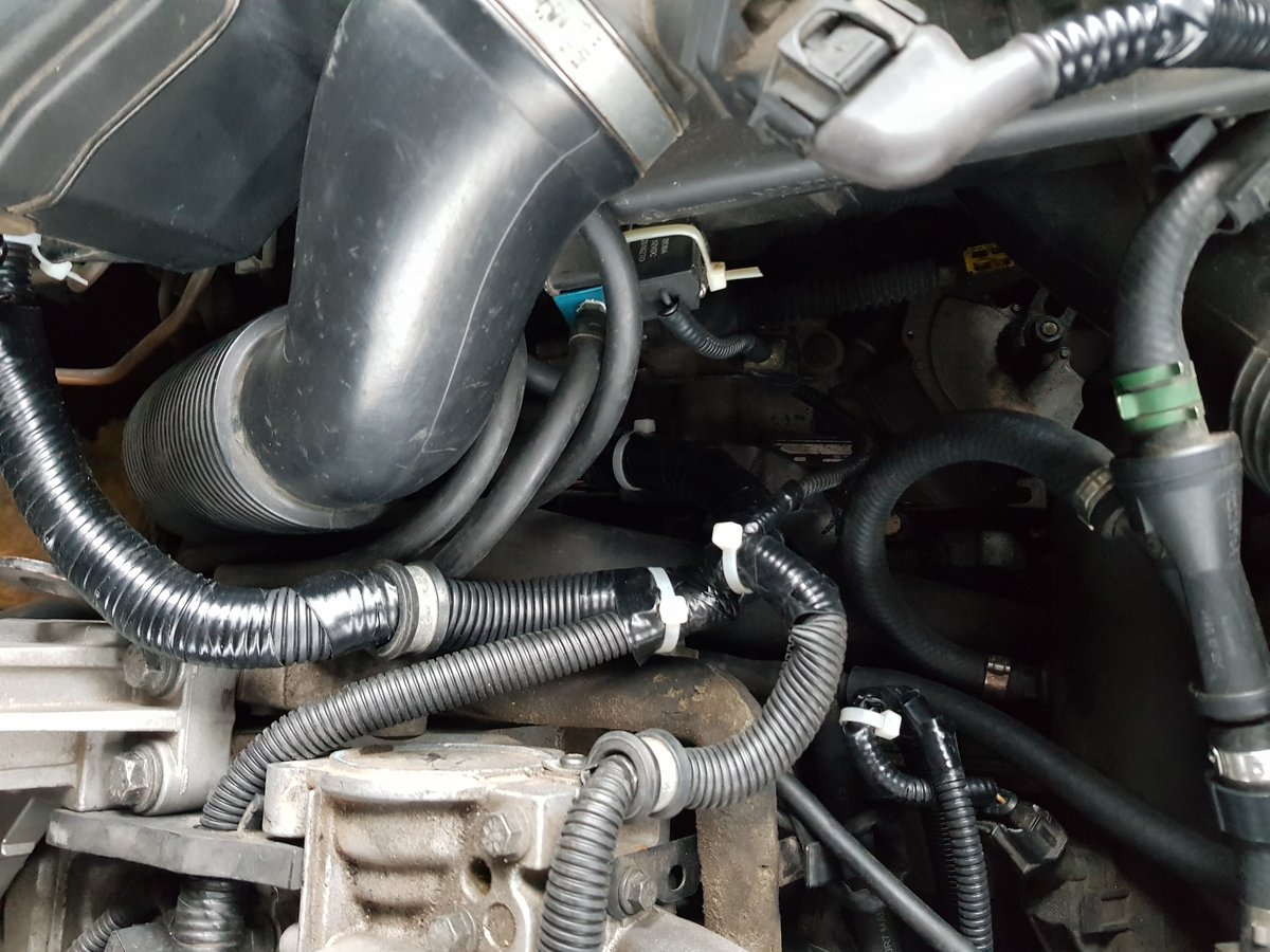

New split tubing for main engine loom coming from fusebox.
Replaced engine oil & filter
Castrol Edge 10W 30 and Nulon 10W 40 mix at 2:1 both full synthetic. Volvo genuine filter.
No sludge found in filter housing
Reset SRL with Vida

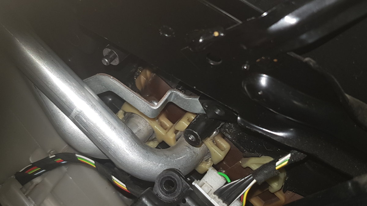

Replaced heater core o rings. Remind me to leave this on my list for "most hated" chores for P2 cars. Due to mine being a Feb 00 build the heater core is not removable without removal of the dashboard so I was very lucky it was only the o rings that required replacement. Later built models have a differently sculpted evaporator box allowing easy removal. Working in tight spaces is not my favourite pastime.
