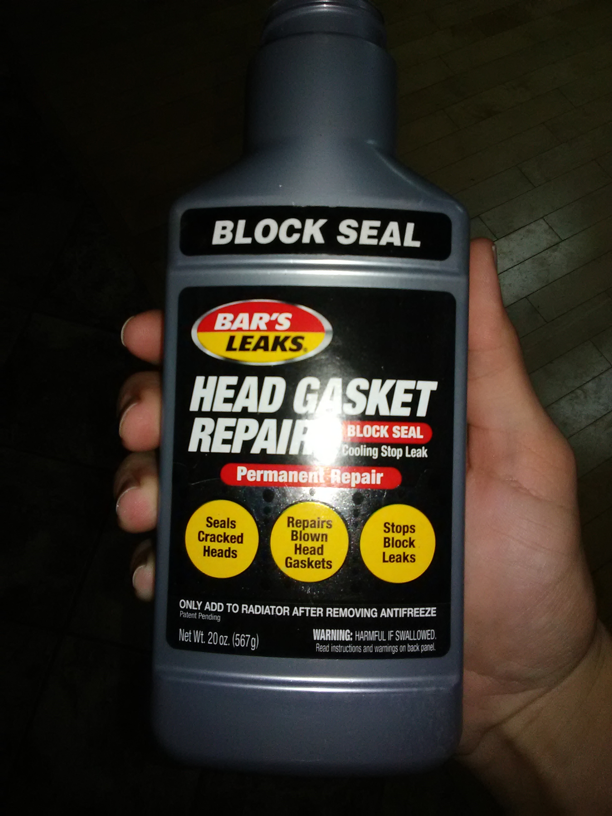

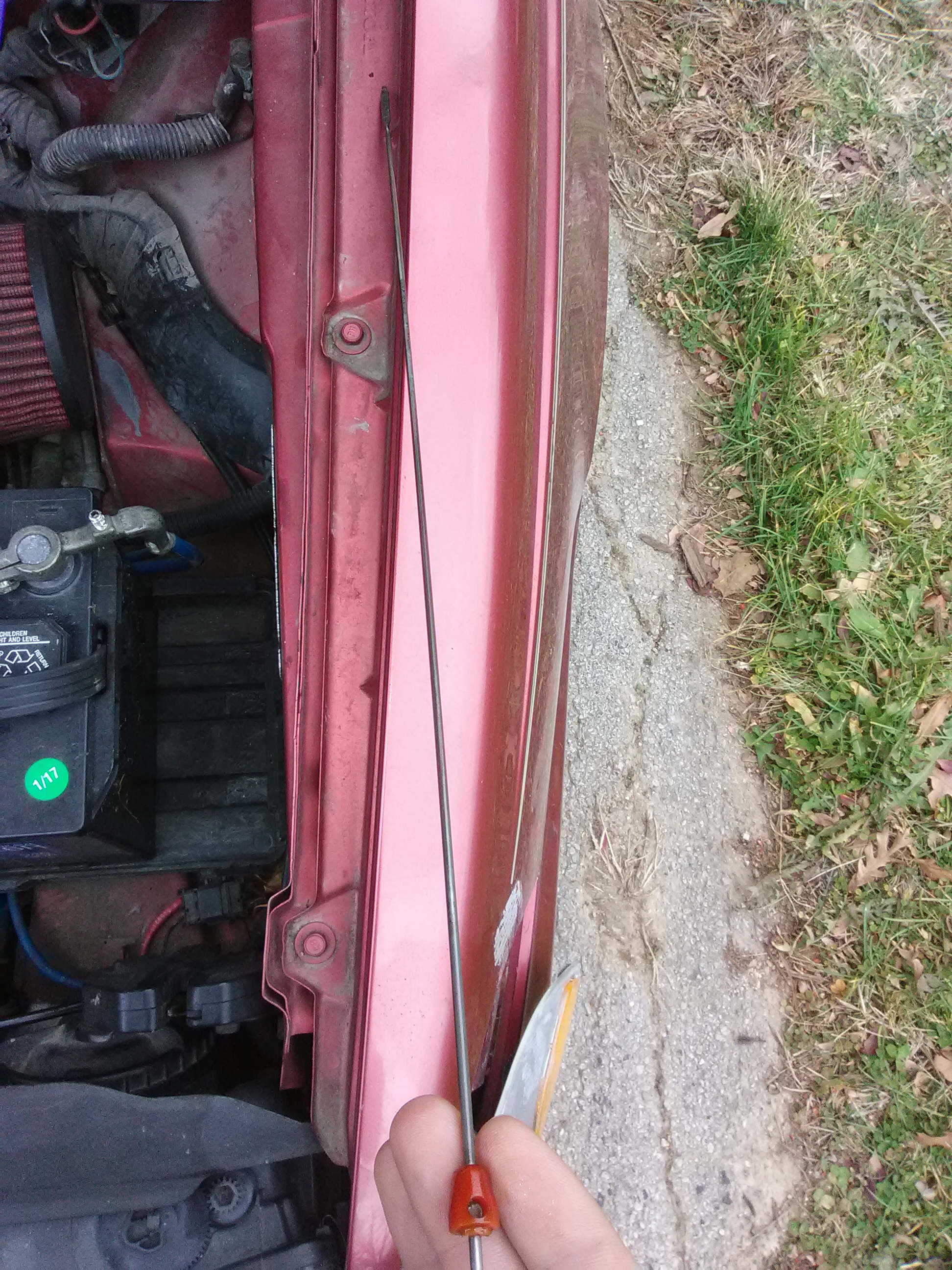

Hey guys, been a while since my last update but I was waiting until I had results to show. Here's what has happened.
I took my last bit of cash to autozone and bought the best head gasket sealer I could find for what I had. A whopping total of about 14 dollars. I chose bars block seal head gasket repair. I ran this through last Sunday night (the 26th) following the instructions on the bottle as closely as possible. The only instructions that didn't get followed were
1. It ask for the engine to be idled for a while and then let cool and run again at a high idle. My car consistently idles at 1500rpm so It was a "high idle" both times
2. After the treatment it ask for the radiator to be drained and left open for 12-24 hours. I finished this procedure at around 3:30 am and it only had about 4 hours to sit while I slept before work.
During the flush before running it through I noticed that not all of the coolant I was losing was going into the head, I had a leak where the upper heater hose runs into the firewall. I looped the heater out or the cycle and continued the treatment.
The idle had become rougher before the treatment and though fully warmed up the car was smoking when I was performing the treatment. During the treatment I saw the idle smooth out and the smoke slow to a stop. Both good signs.
Upon completing the treatment my milage was 256186. Ive been driving the car regularly for the past week and put nearly 200 miles on it. The milage is now 256375. I did not have the cash for an oil change so I've been watching the oil for the past week and noticed less and less milk on the dipstick. I've also noticed no smoke even on cold morning starts. When I checked the oil this morning there was no milky residue at all. I took the car for a short drive to the gas station (about 7 miles round trip) and still had no residue when I got back. Here is my dipstick now I believe this was a success. This stuff worked for me. I've put nearly 200 miles on it now and it seems ok. It still has a small amount of the treatment in the cooling system as I haven't been able to flush it again yet. But if anything changes when I flush it out tomorrow I will let you guys know.

Well done!
Drive this thing like the re are eggs under your foot on the gas pedal and save. Every novel for 5000 mile synthetic oil changes. About 22 bucks for a 5 liter container when your eye falls upon such a price, pick it up

Grrr, not sure why I did NOT see this post earlier.
I don't think you had any issues with a head gasket. Glad you found the source of your coolant leak, likely the firewall coupling. Stopping that leak likely solved your coolant loss issue.
