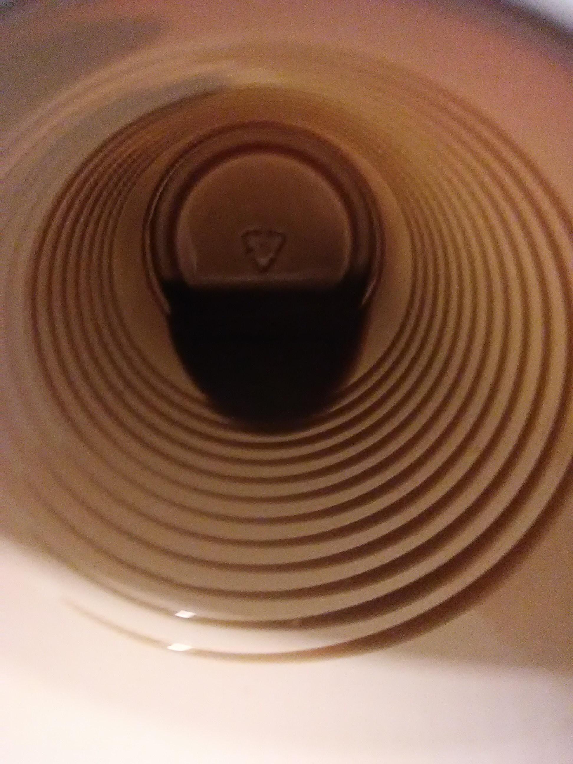

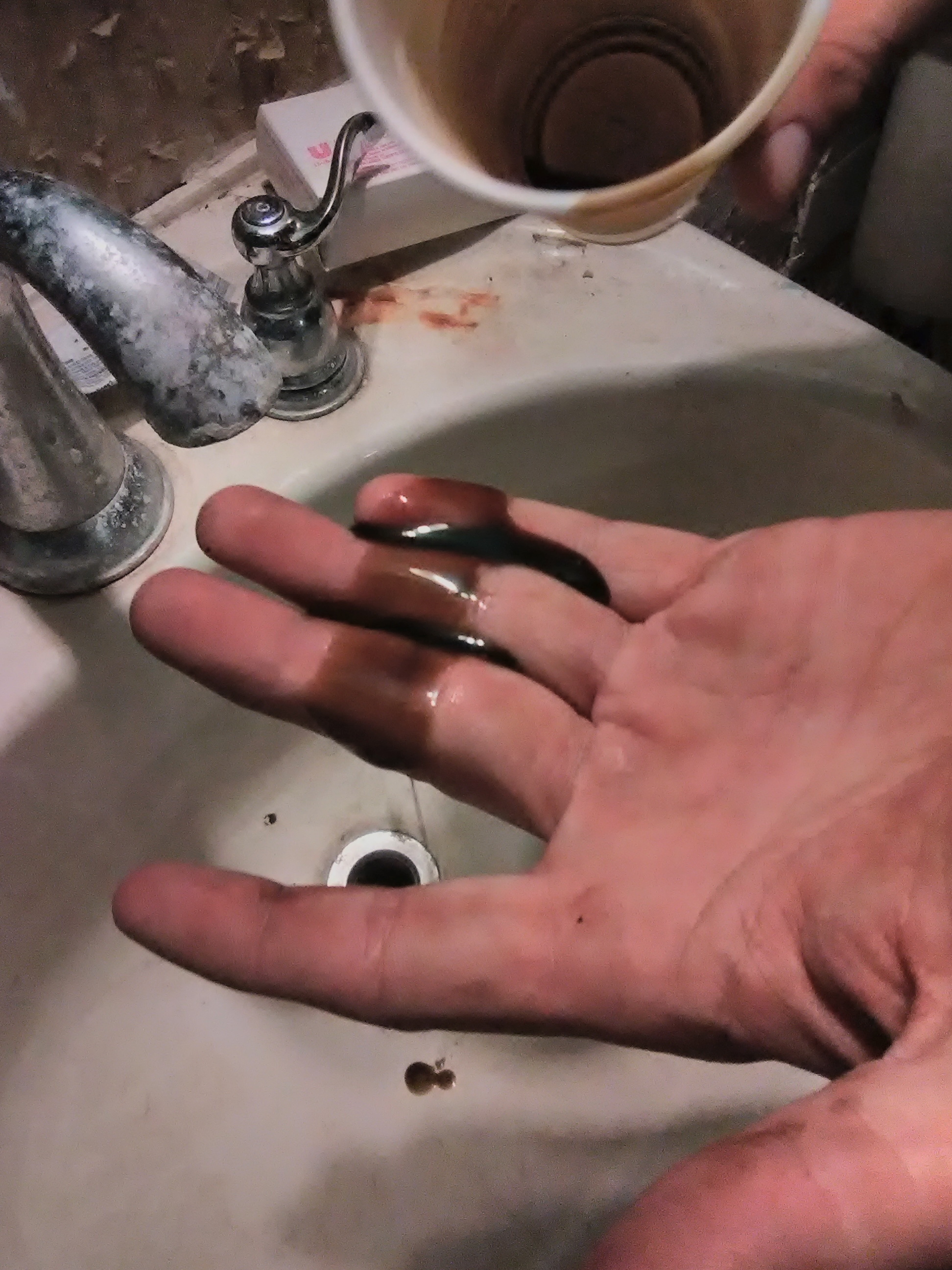

5. This one has me really confused, I drained out a small bit of oil to look at it, and it doesn't look milky at all. I had the car warmed up from driving it home and after being home about 10 minutes I started it back up and pulled it around to the garage, so any water should have been stirred up and mixed with the oil. What I got just looks like oil, I've attached a picture.

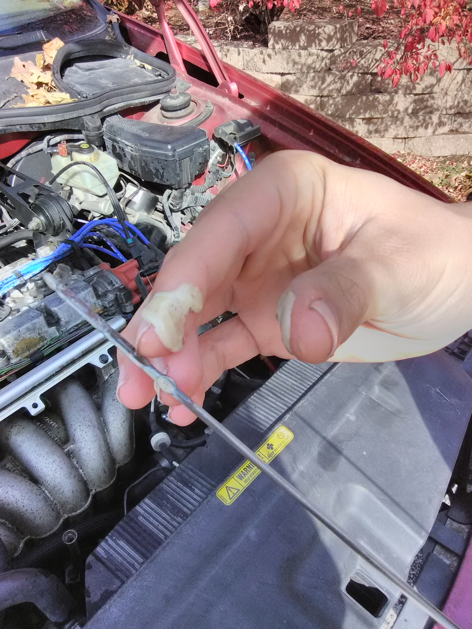

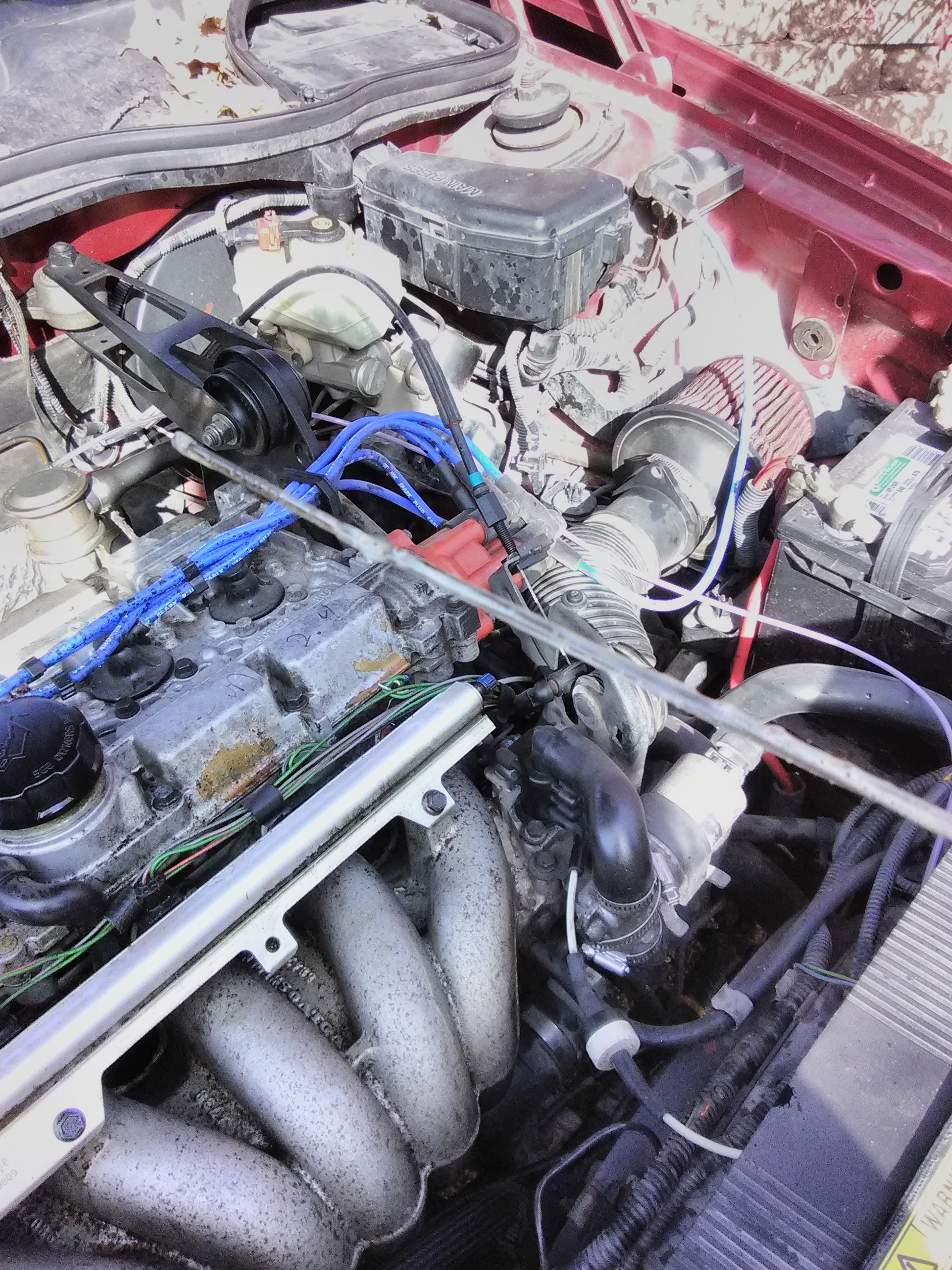

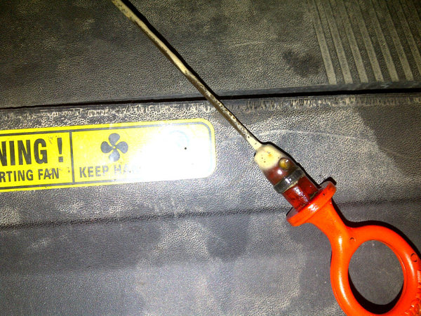

Sorry guys I got this picture earlier but didn't get a chance to post until now. This is what my dipstick looked like this morning. Sometimes it's worse, there was more on it later but I didn't get a picture of that, also sorry if it's hard to see in the first picture, I didn't think about putting something a little less busy behind it.

I replaced the black box under the intake manifold and the hoses running to it. As for the smoke I thought I saw a blue tint to it today but my girlfriend said it was white so maybe my eyes are playing tricks on me.erikv11 wrote: 21 Nov 2017, 14:42 Yeah, cracked PCV hoses is typical, they all have to be replaced. There is no PCV valve on these cars, which part did you install? A clogged PCV can push episodes of oil in that will make clouds of blue smoke, but not white.
10-15 miles is not very far, that could definitely make milky dipstick. Post a pic of the dipstick if you get a chance. Here's one example of clogged PCV and short trips, but it can look different:![]()
