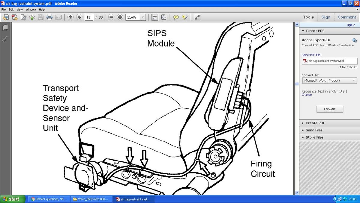

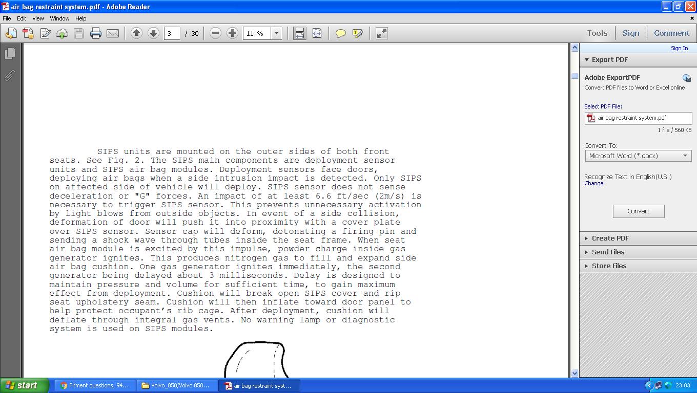

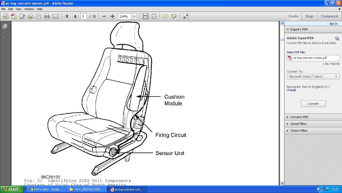

Yes you're right Klausc.
I just surfed over my diagrams and sips airbag info data.
It looks like sips airbag deploys when the sensor is crushed with the door in side impact.
Those wiring and connectors under the seats confused me a bit.It seems that wiring is just for seat belt reminder and heated seats.

They do not require power to trigger the seat SIP. I have tested a few at the pull yard with a hammer and they go off just fine.misha wrote: 28 Nov 2017, 14:16 That would be interested since i have 2 connectors with a lot of wiring under the seats...for heating,seat belt warning sensor and sips airbags.
Sips airbags still needs power in order to work just don't use crash data from srs module.
They deploy when side impact happens with correct pressure on their casing,but must be powered.
