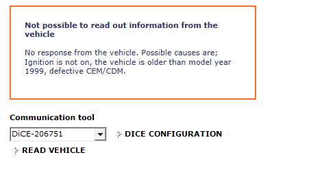

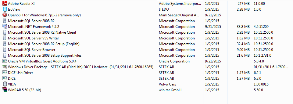

Update: Followed the above procedure, still no DiCE (sorry...sorry...). When I plug the DiCE back in after reinstalling the drivers, it spends about 30 seconds on the "Installing drivers" message, and then shows the "driver installation failed" message. I did notice that right at the point where it shows "driver installation failed," the yellow "USB com status" light flashes quite a bit before shutting off, so it seems that USB communication is happening at some level. Not sure it's useful, but I added Console logging messages from Mac OS X at the bottom to show what the Host OS is registering when the USB device is plugged in/unplugged.

List of Installed Software
Screen Shot 2018-01-09 at 9.52.49 PM.png (64.56 KiB) Viewed 4746 times
Error in VIDA when trying to Read vehicle
Screen Shot 2018-01-09 at 10.46.38 PM.png (20.51 KiB) Viewed 4746 times

If things start getting "WTF" keep in mind there is no Vida software per se. Vida is a Microsoft Access database with some helper programs. In turn, Microsoft Access is an assembly of stand alone programs. You got a lot of subsystems that got to play well together ....
At this point I suspect it a communication problem between the VM and the Mac USB port. You might want to look at the VM settings in the VM manager. You might need to stop the VM to make changes. DiCE supports USB 2.0, is the virtual USB port set for 2.0? Is it setup for passthrough or host managed?

RickHaleParker wrote: 10 Jan 2018, 01:13 At this point I suspect it a communication problem between the VM and the Mac USB port. You might want to look at the VM settings in the VM manager. You might need to stop the VM to make changes. DiCE supports USB 2.0, is the virtual USB port set for 2.0? Is it setup for passthrough or host managed?
Ding ding, we have a winner! :D
It turns out that Virtualbox, by default, only comes configured with USB 1.1. I had to download and install the Virtualbox Extension Pack in the Mac OS X host OS, which provides support for USB 2.0. Then I edited my VM's configuration in Virtualbox and switched USB from 1.1 to 2.0. After that, I booted up the VM, connected the DiCE unit to my Mac host, and it was properly recognized. I was able to start VIDA, read the vehicle, and operate everything in the diagnostics tab.
Thanks so much for all the help!
