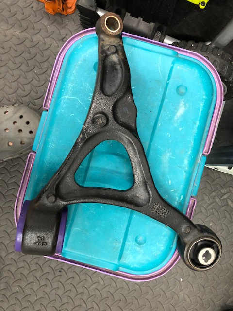

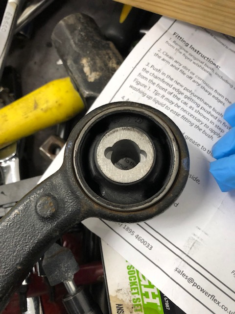

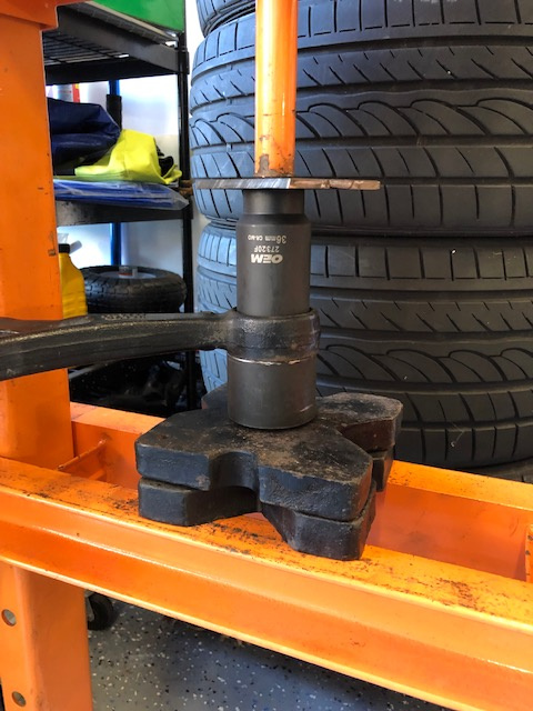

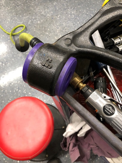

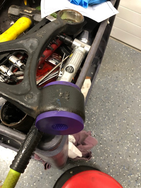

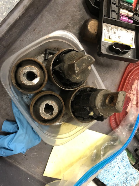

Thanks for the comments. I ended up doing the lower control arms as a first step. I decided to go with the polyurethane front bushing and rubber rear ones. Seems like the poly sub frame inserts are out of stock. Will check that out next. Wow, it was a lot of work getting the old bushing out. A 12ton press barely did the job. Yeah, still had to drill out the front bushing before pressing out the sleeves.
