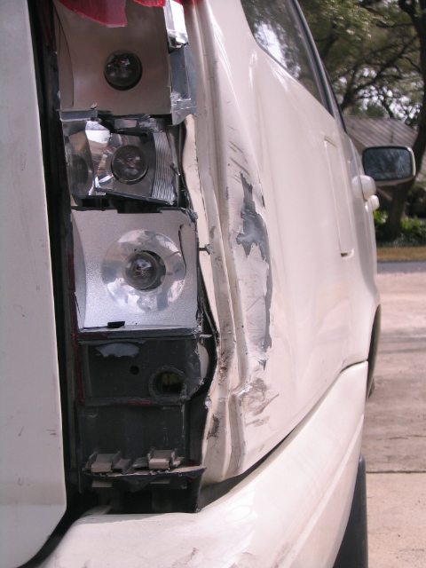

It looks like you lucked out- the nasty area is below the light- you should be able to access that area when you remove the tailight- some wood wedges can help - can go to autobody101.com and post for assistance too

Returned to PnP the next day (after cooling off) when it occurred to me that a new tail light cluster just might not fit UNLESS the sheetmetal around it was fixed FIRST. Therefore, I needed a replacement to check this out and the quickest & cheapest route was the PnP.
I picked up a 8mm deep 1/4" drive socket on the way. It's tough sledding without one. I also discovered you must remove the tail light assembly above it FIRST to get the lower one out without applying undo force. Gaining access to the rear 8mm nuts means removing interior trim first. With that accomplished, I also removed a few more pieces. I was finally able to successfully remove the pass. outer mirror insert without breaking it for the first time in four tries. I've had the worst luck with these......
Yard only charged $14 for the complete tail light assembly. Well worth going back.
Turns out I did have to straighten some bent sheetmetal to extract the busted tail light, then work on it even more to get the replacement properly fitted. I also took time to thoroughly clean the gaskets of dirt and lube it with Mequiers VLR. Might as well as I had both upper & lower out.

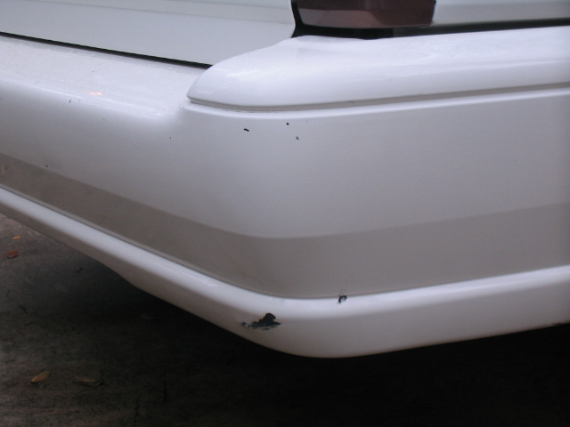

Next, I washed the rear bumper to see just how much of that was dirt, the other cars trim, damage to my bumper/paint, etc. While doing so I noticed these short, black threads floating in the wash bucket. So I began scraping the damaged area with a fingernail and noticed it WAS the other cars bumper material and that after removal, my white bumper was undamaged!
After enough work, here's the results:
This was a most-welcome surprise! Compare this with the above before photo.
So I WAS able to fit the replacement tail light lens without getting the big dent fixed first. Also got lucky finding a OEM replacement lens in excellent shape locally for only $14. Third, I'm street-legal again so don't have to worry about being stopped for a busted tail light. Fourth, I can replace the cracked pass-side mirror. Fifth, I can also replace the pass door handle (plastic swivel fatigue) and the door latch mechanism that defies my attempts to repair it internally. Sixth, I also scavenged some inner door panel keepers that hold the panel to the metal door. I also spied some OEM axles there.....

Have to give Volvo a +1 on their plastic bumpers and trim piece. The other guy's paint usually wipes right off. Had a white ford focus sideswipe the entire length of my car in a parking lot. The white streak buffed right off. :lol:

^^^ Indeed. Rather amazing all of those black marks were just melted plastic adhered there from heat due to friction.
