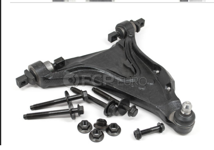

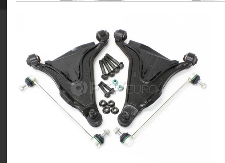

This is true on 850 style control arms that bolt through the side of each each arm and if you don`t do what you say they will get destroyed quickly. However on S80 style arms it is NOT DONE as they bolt directly to the frame and is not necessary, it can`t even be done anyway.matthew1 wrote: 15 Feb 2018, 16:37 Important: after pressing bushings in, during control arm installation, remember to align (push up with a jack, typically for us DIYers) the control arm before you tighten things down. This puts the arm at "ride height". Without doing that, you're fixing the position of the bushings at maximum wheel extension (think jumping your car, Dukes of Hazzard style, wheels hanging down waiting for the crushing, inevitable reunion with Earth), and the bushings will be constantly extremely torqued for their life. Which will be about 2 months.
S80 style
850 style

Short answer to know whether your style of control arm requires that the vehicle be lowered on the ground before tightening the bolt(s), you have to know what you're looking at because designs vary between make/model/year. I would venture that quite a few people wouldn't necessarily understand the difference by just looking at it. If in doubt, lower the car first.

Fairly simple, if a mounting bolt goes through a bushing the control arm needs to be brought up to ride height before tightening. If the control arm mounting bolts do not then no need to. No worry Matthew, I was doing an s80 and looked at the arm several times before I figured that one out
