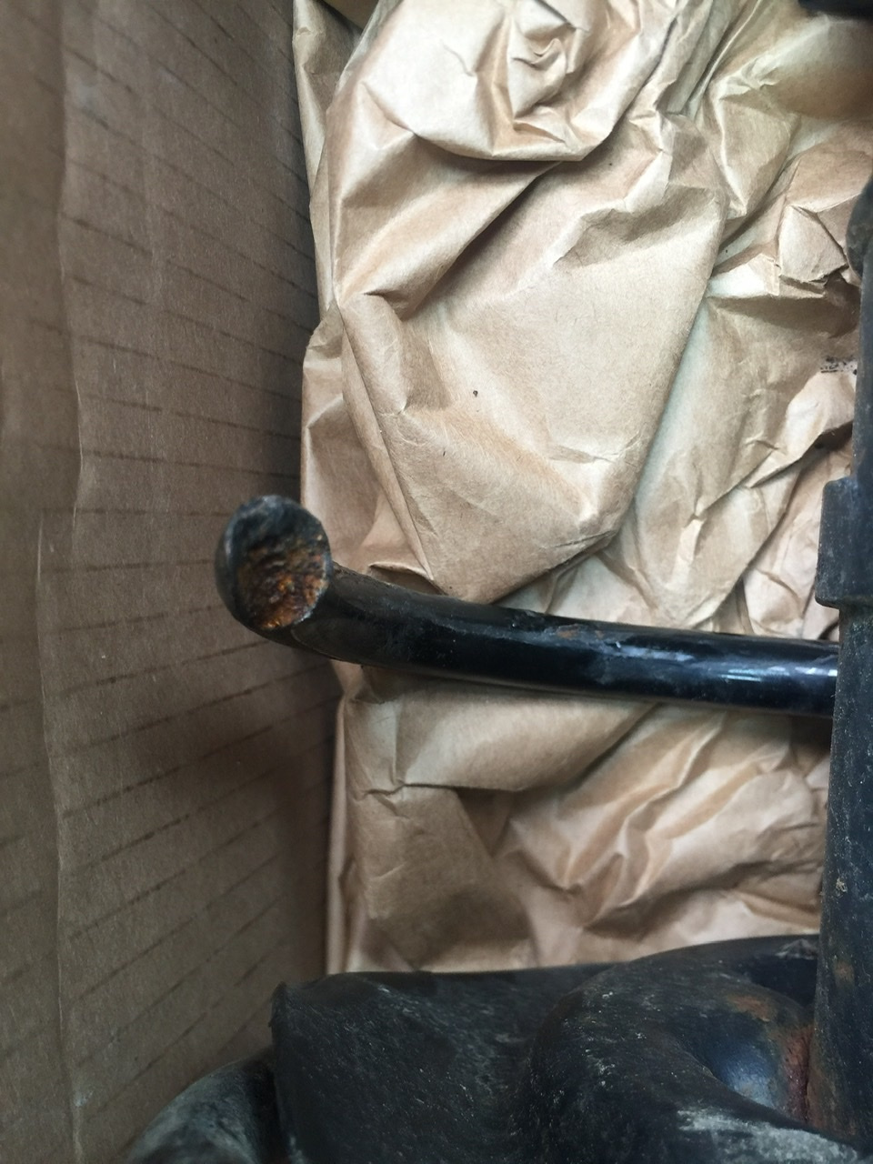

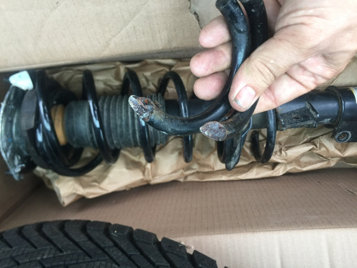

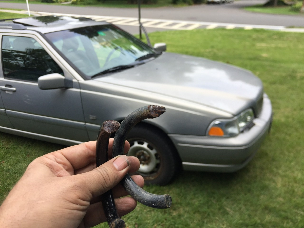

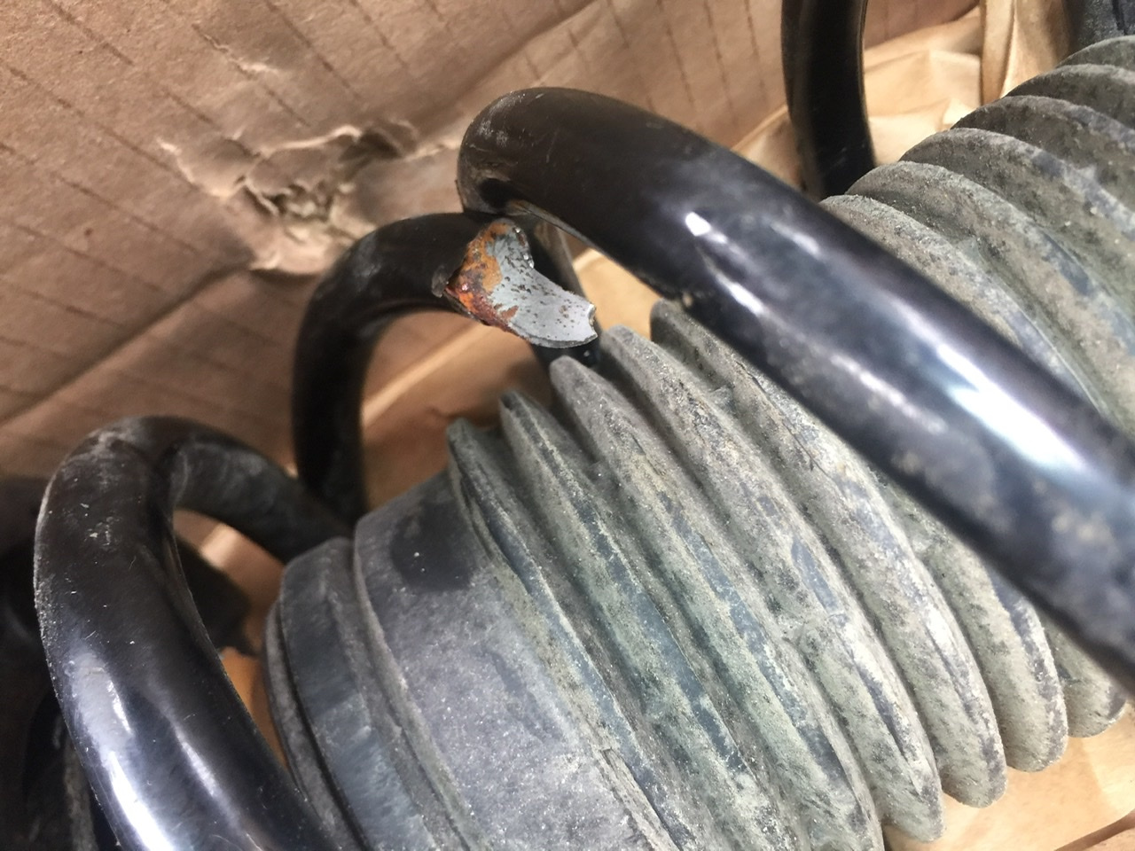

Just wanted to add to this thread.
I recently reworked an engine on a 1998 and after sitting fir 6 months, one year old Sachs quick struts from FCP BOTH failed due to fracture of the spring. We suspect sample defect vs product defect after talking with FCP.
