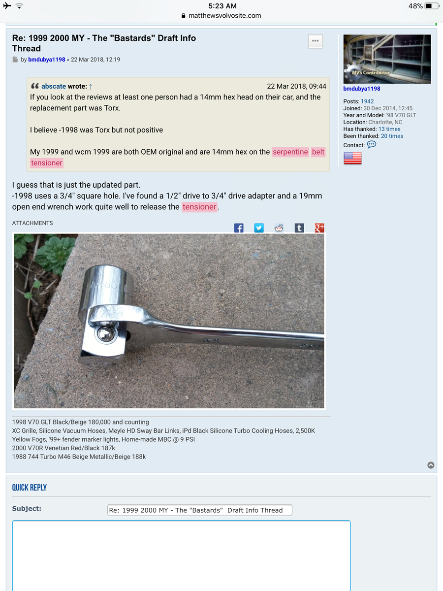

Now all I need to determine is what do I have on the belt tensioner, a female square or do i need to make a male square tool?

I believe it is a large torx on the serpentine belt tensioner but that should be searchable here
Onedit...Fail..,
It’s a 3/4 female square...here is a nice trick by bmdubya1198 via screen shot

Greta idea, thank you for that. You got my juices flowing upstairs. I am going to Home Depot at lunch break today to buy that 1/2" to 3/4" adapter for my breaker bar I have at home. That should do it!
