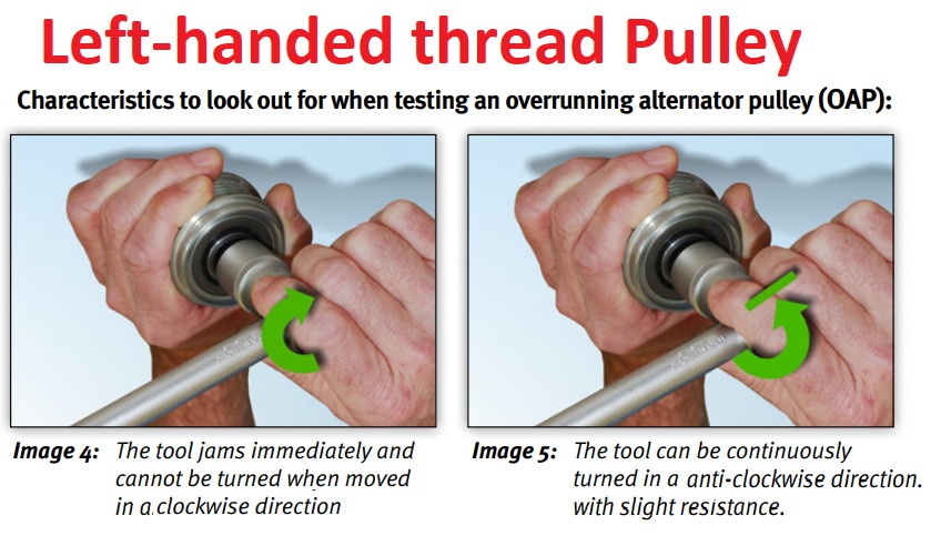

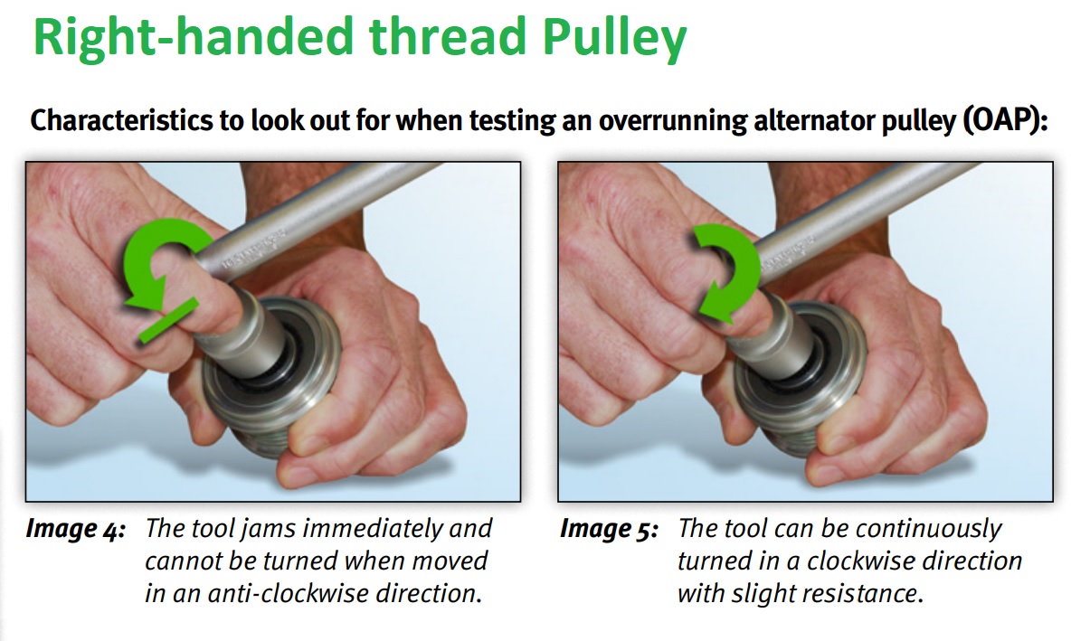

Note: my overdrive pulleys are
Alternator Pulley: Left-Handed thread
AC / Power Steering and Water Pump: Right-Handed Thread
so I modified the picture and description to show how the pulley works if it is for a left handed thread.
The picture shows how the pulley is tested according to the people that make the pulley.
Microsoft Paint is very useful for editing like this
Edit: Here is the original picture for the Right Handed Pulley
Take care
Paul
PS the picture that you posted with the Orange Bar applying Clockwise torque and it is implied that the breaker bar needs to be held steady or turned counter clockwise. To quote Ed China "Simple but not easy". Don't forget that you also need to push down on the T50 so that it doesn't slip. And be ready to apply 100 Ft * Lbs. to the orange bar.
