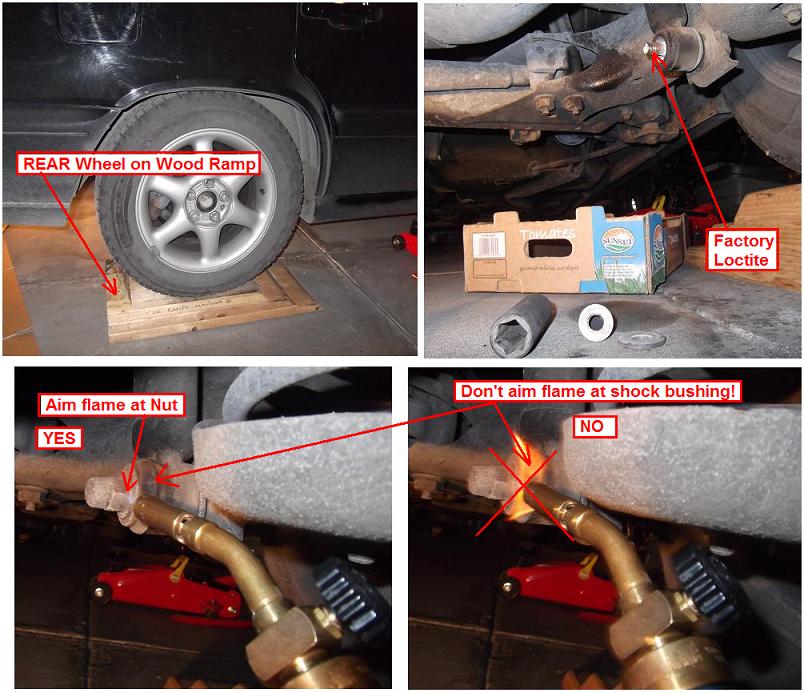

In the P80 (1998 V70), I modified the REAR shock procedure to do it with rear tire on the ground but on a wood ramp (no need to remove the rear wheel or lift the rear)...
viewtopic.php?f=1&t=28318&start=30
Has anyone here replaced the REAR shock in a P2 car using same technique: rear tire on the ground but on a wood ramp?
Car is 2004 V70 2.5T FWD...
