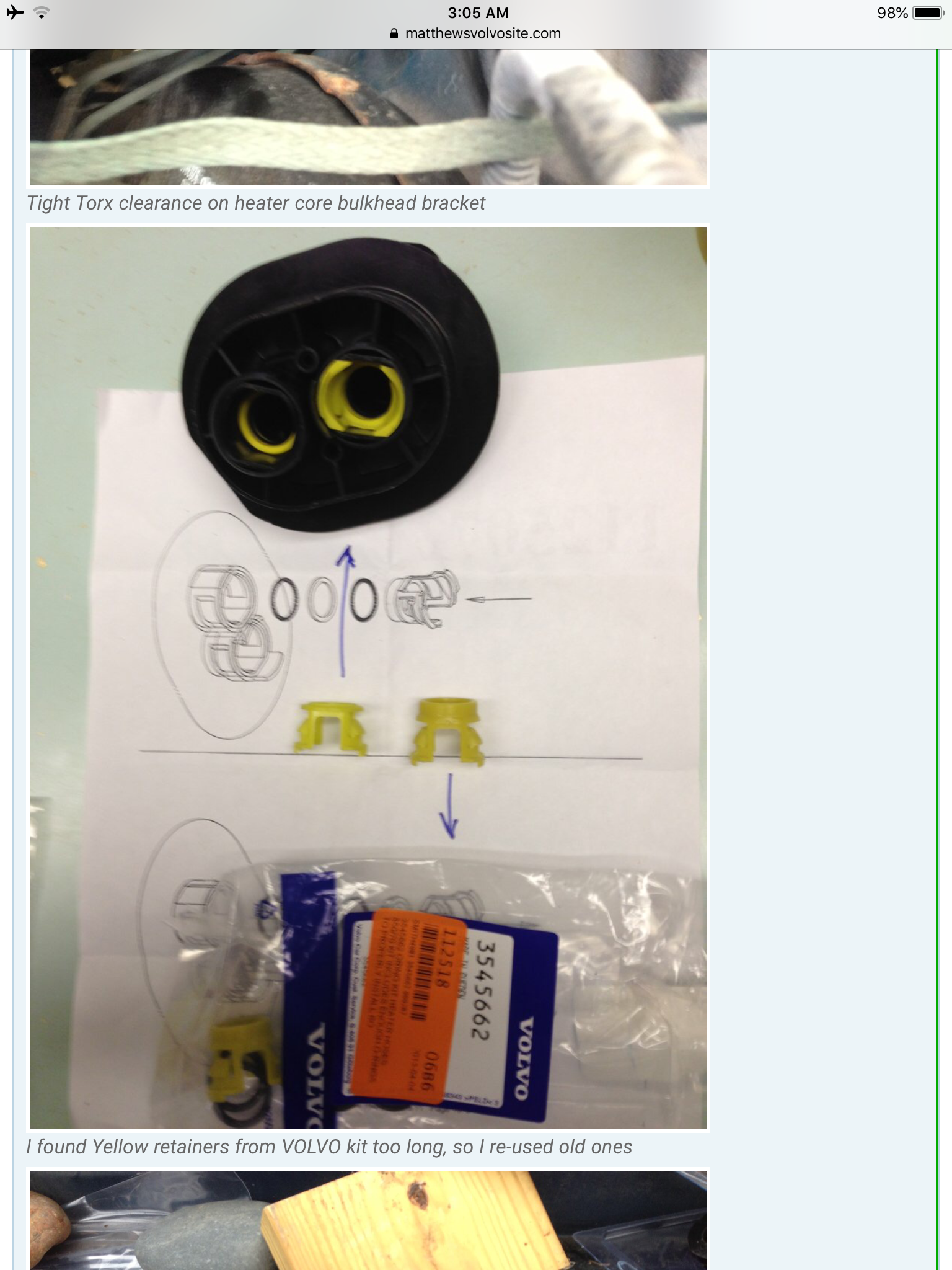

The mechanics of the coupler really don’t break or wear. I did have to reuse my old clips as the new ones were too deep or perhaps I didn’t quite understand the figment correctly. I put pictures in my thread on heater core and AC refurb....here
viewtopic.php?f=1&t=56005&start=30
Picture of clip issue

Thanks. I bet they redesigned/improved the clips in conjunction with the new coupler/junction box. I'm planning to order the Behr heater core and the complete junction box (with o-rings for four connections instead of one per o-ring kit). I'll use the o-rings and have the junction box and extra clips/o-rings if I need them.
