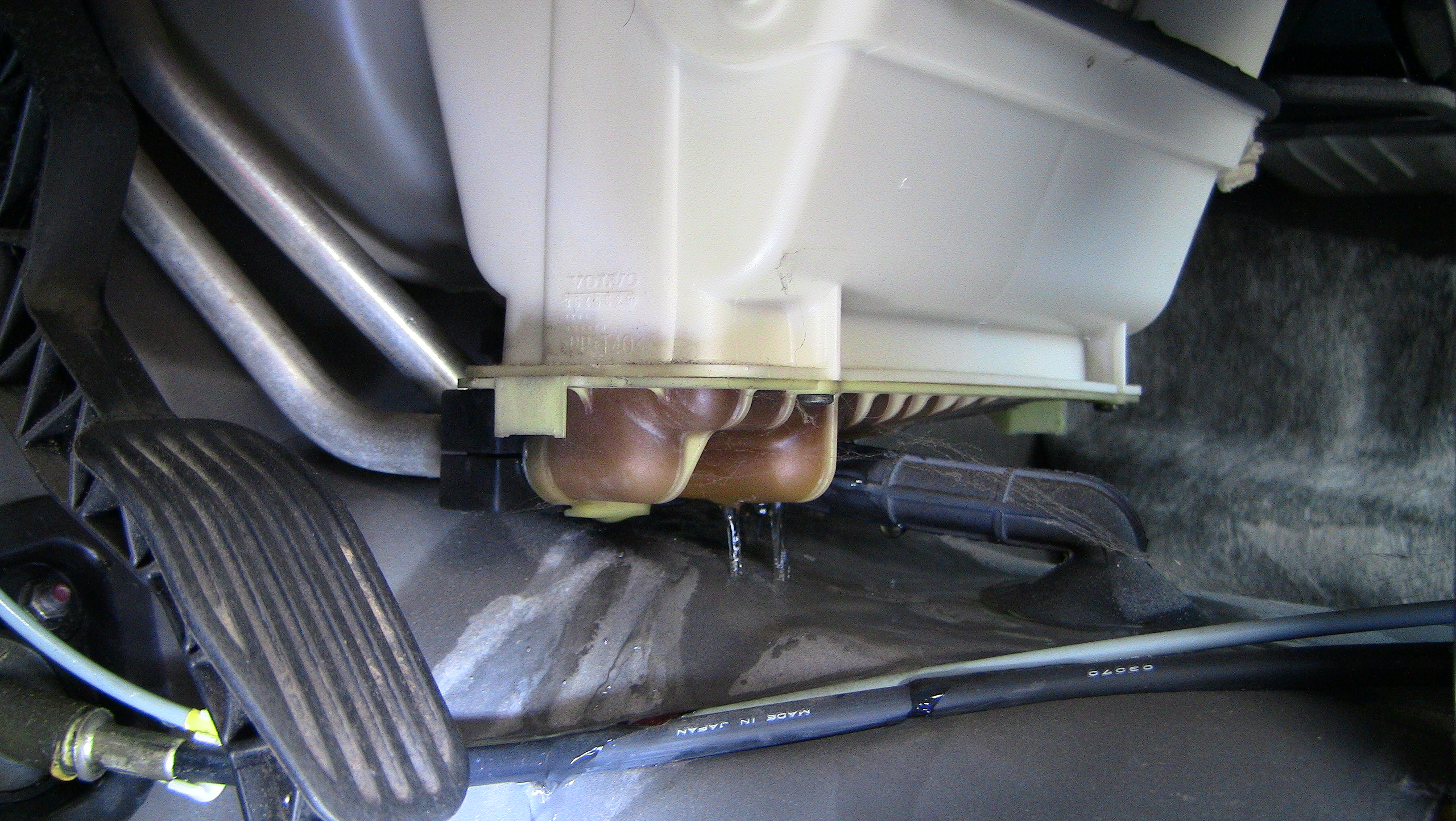

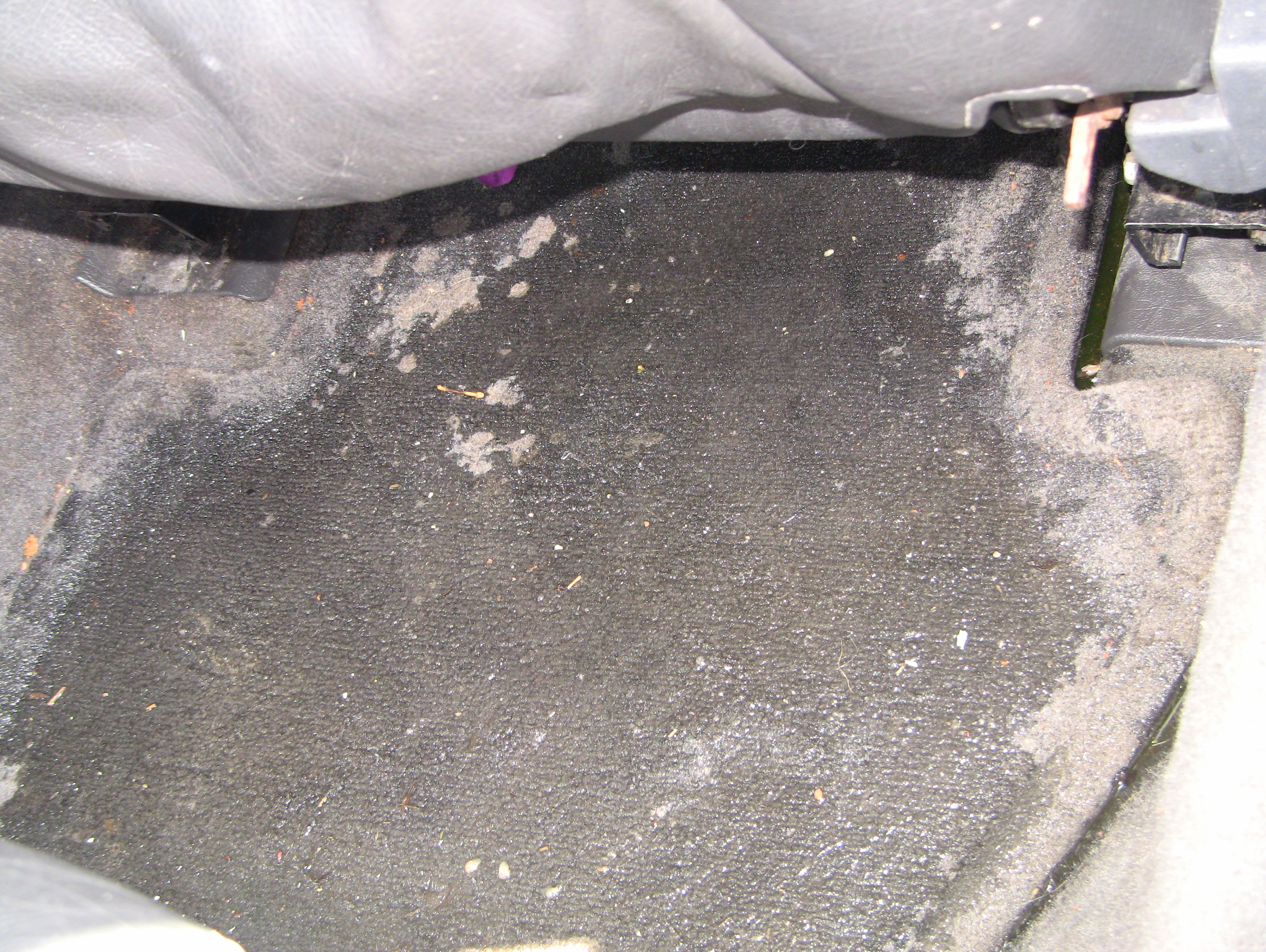

I do see a small wet spot on the driveway under the center console where the heater core is. Carpet under passenger carpet is damp. Not what I'd expect after adding gallons of water. I will add a few more gallons of distilled water to overflow tank as soon as I buy more.
Options for diagnosing leak as heater core versus o-rings. Is it enough to pull back the center console, add water, and watch whether water escapes near o-rings or from heater core itself. Or is it possible both heater core and o-rings are bad?

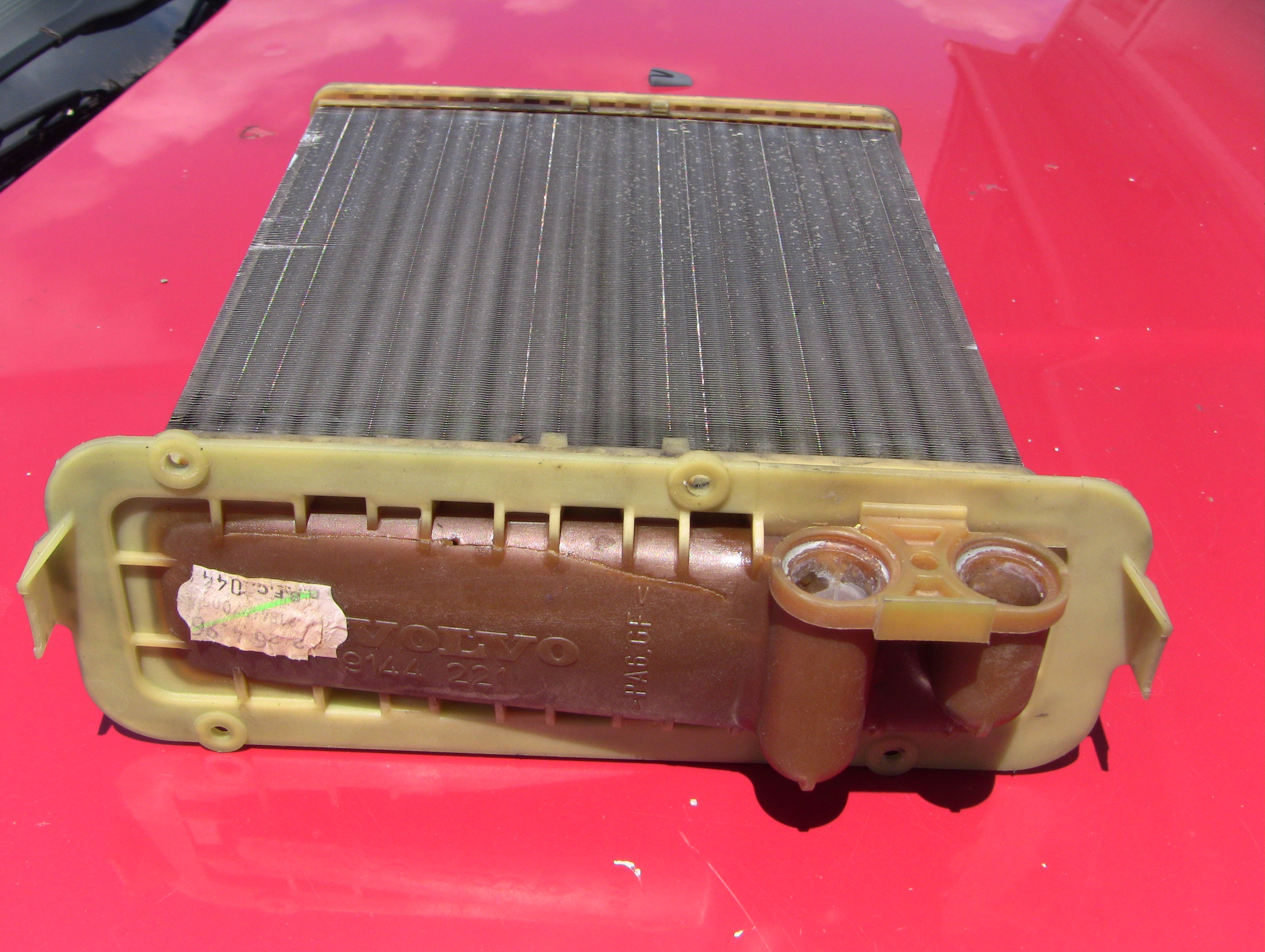

Houston, we have a problem:
I'm pretty sure I know where all of the coolant I've been adding is ending up:
I noticed the coolant flowing back along the top of the center console hump. The back seat floors were flooded with coolant. The front driver and passenger floors not so much.
Note the long crack along the bottom of the heater core. Also note the darkened discoloration an inch or so up from bottom of heater core grill. I suspect this discolored area may indicate another leak and be responsible for the long-term slow coolant loss I've noticed in recent years.

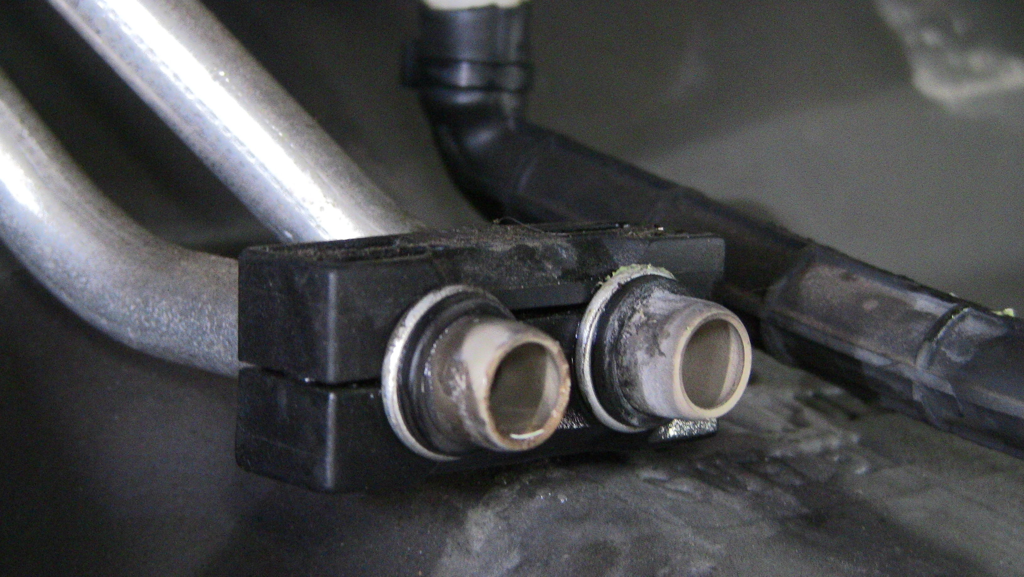

I'm hoping these line connections will clean up ok:

The old heater core has '96' on it. I suspect this is the original heater core. They just don't build things to last anymore. :^)
I'm thinking to order a new Behr heater core. abscate recommends replacing the o-rings that attach the coolant tubes from heater core to coupling on firewall. I'm thinking to do this as long as folks are confident the coupling will survive my messing with it. I want to avoid scope creep (IT term).
Thanks again for all the help. I need to decide whether I should scavenge heater core from other 850 or just go ahead and order new one. I'm sure the experts here will set me in the right direction.
