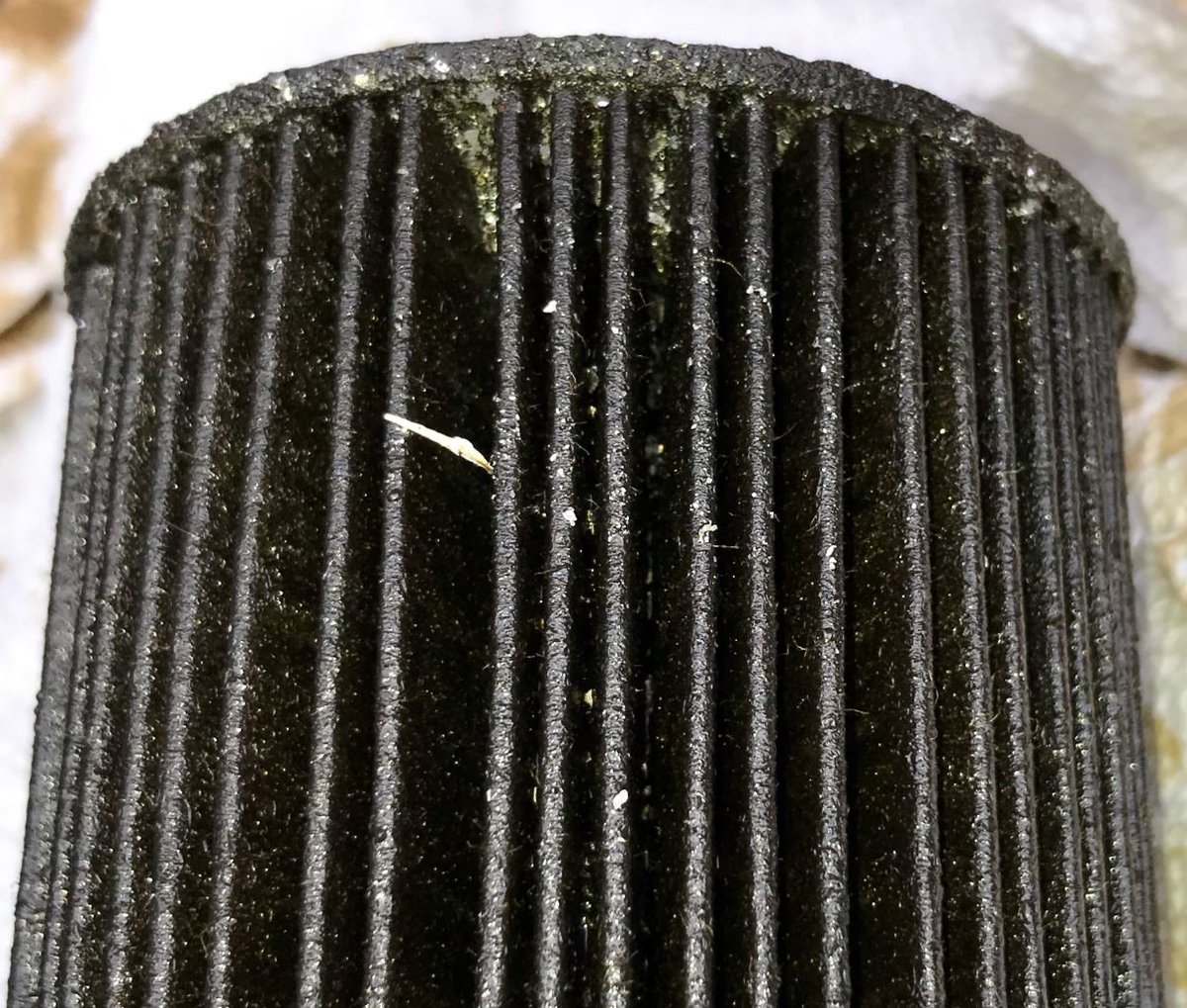

I am seeing some metal fragments caught in the filter. If your pistons and cylinders are good (which I doubt) then most likely your bottom end crank bearings and/or rod bearings are history and the crank is scored. Could be a fried oil pump but doubtful. Top end could also be toast.
At this point the only way to tell is to dismantle the engine. I think some of this work can be done with the engine still in the car by pulling the oil pan, but in a worse case scenario the parts will exceed the price of a used engine. If you farm this work out you will be underwater pretty quick and most likely be told you need a new engine.

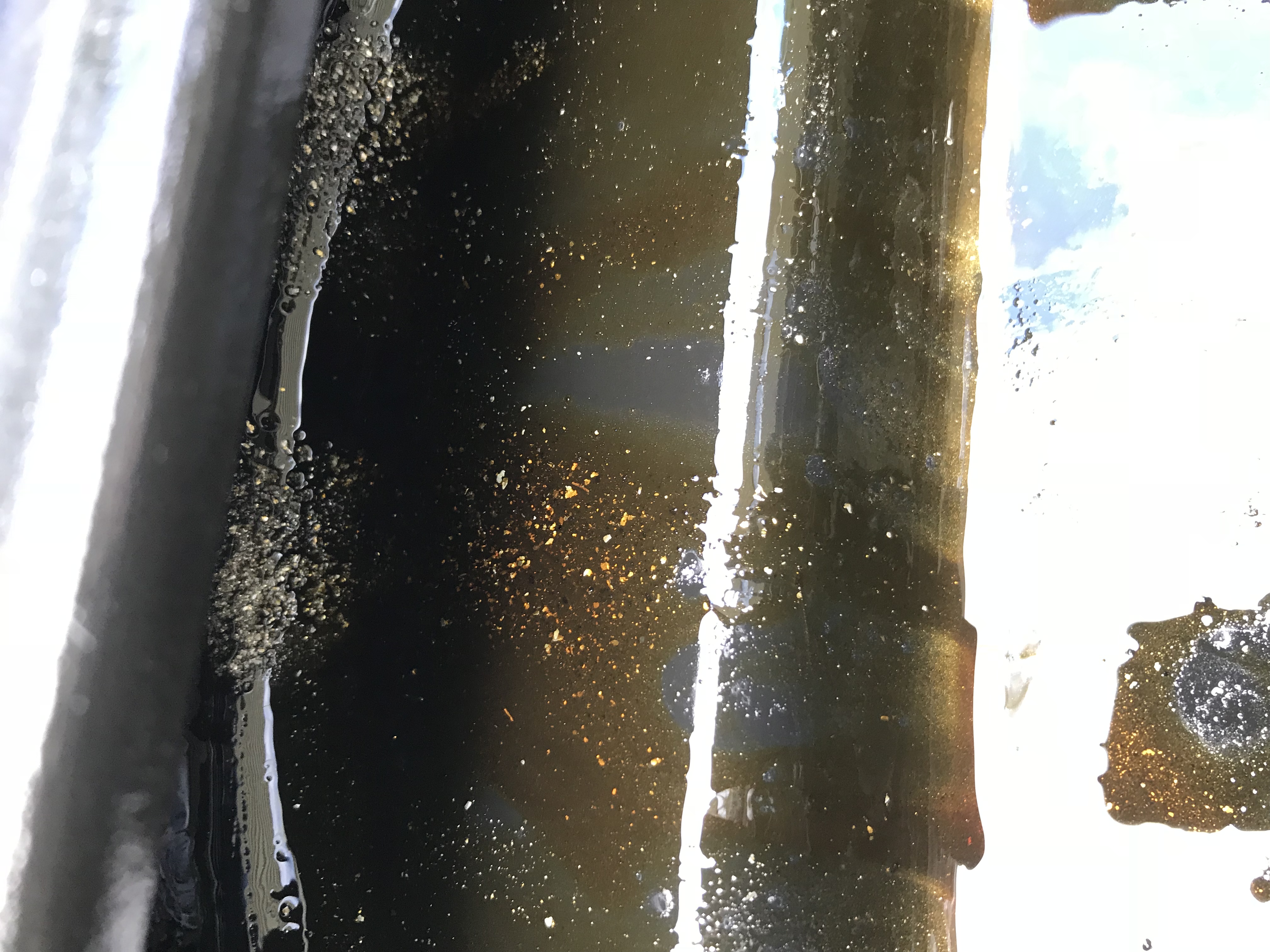

Yeah sounds like I may need one... no joy. Oil drained into pan looks like a gold miners dream. What metal is goldish in appearance - bearing race?

Agreed, but that noise wasn't there prior to this incident and the top end sounds very normal. Under the car, different story. Too bad, she served us well and I just replaced pretty much anything replaceable by a shade tree mechanic over the past 2 years. Maybe it's worth another engine, just can't be sure...RickHaleParker wrote: 05 Aug 2018, 12:41 Take a mechanic's stethoscope and pinpoint where the noise is coming from. A $10.00 tool, if it prevents misdiagnosis one time it has paid for itself.
