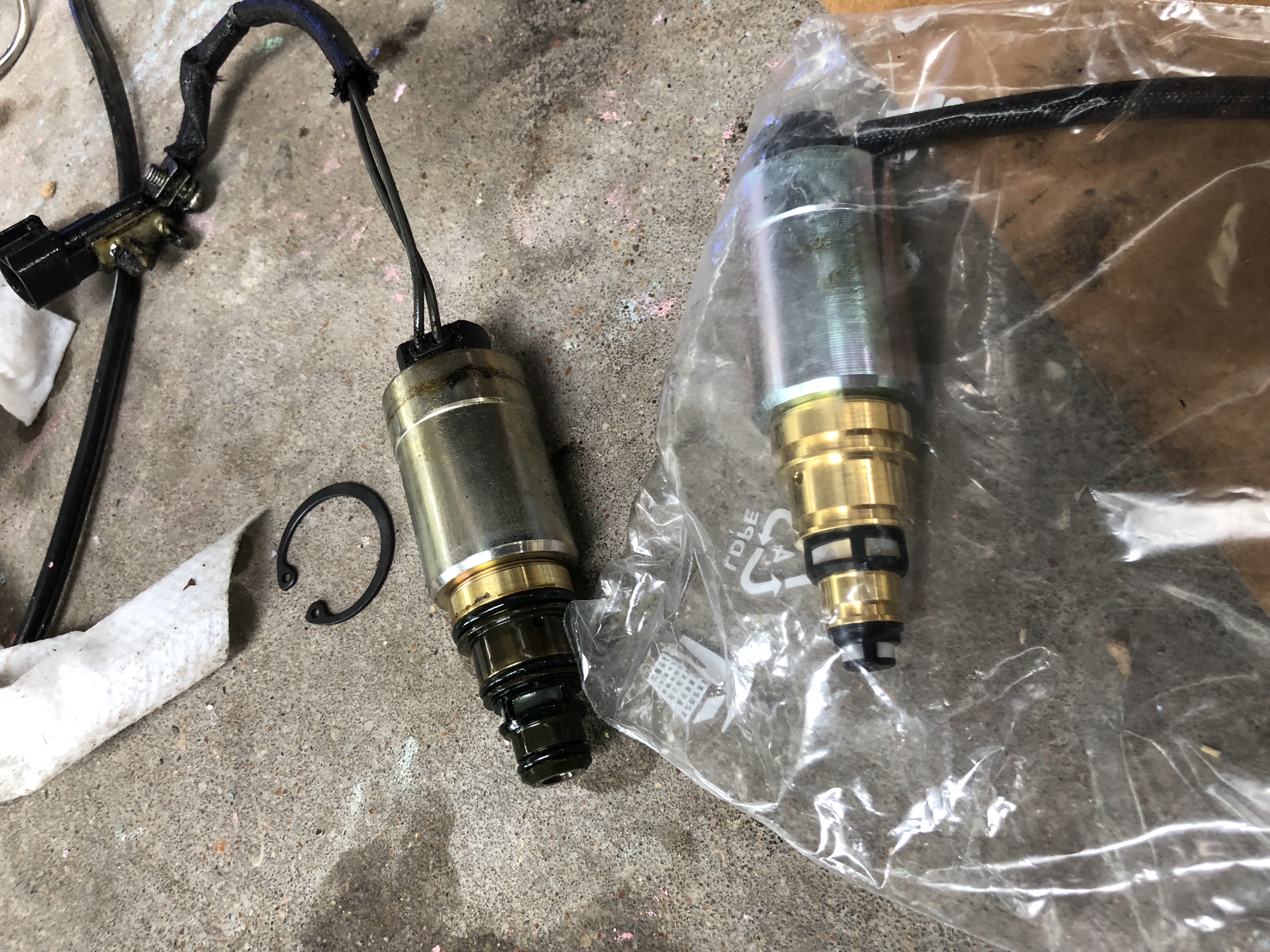

I just pulled the valve.
My new valve has what looks to be a filter on the end, but the one that i pullede does not.
Do you think this piece is stuck inside the compressor? It doesn't appear tobe the case, at the end of the valves hole, there is metal, not black plastic or otherwise.
Maybe it flew off in removal, or it was never there back in '08?

Subpost #7 in the link I noted, you'll see that the guy who wrote it noticed exactly the same thing. New with filter, Old without. He suggested it's a re-design, I have no reason to think otherwise.

They added the filters as a running change. It will fix the issue of swarf from manufacture giving a stuck valve early on but it does not address bore wear that occurs years and a 100K miles later. CVVT solenoids got filters either in gasket or on the valve for the same reasons.

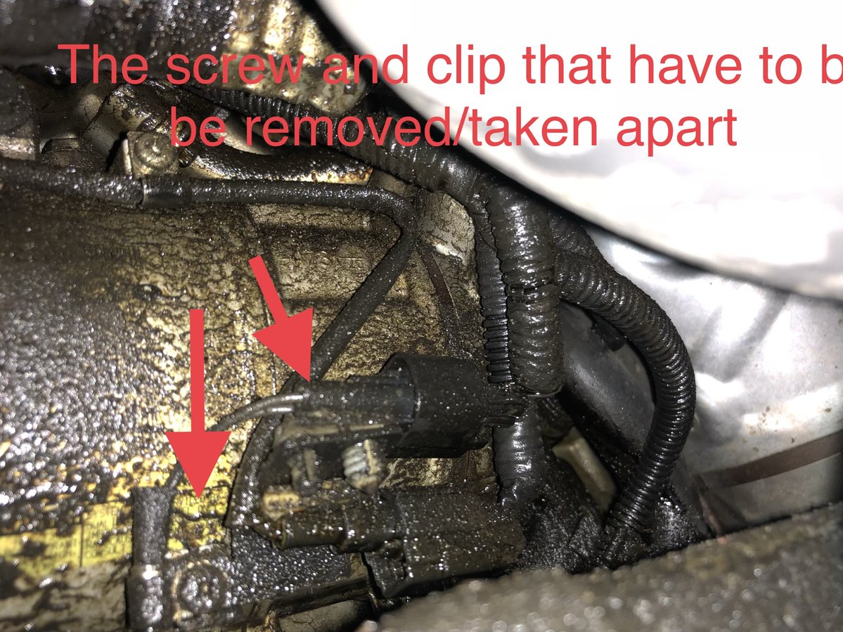

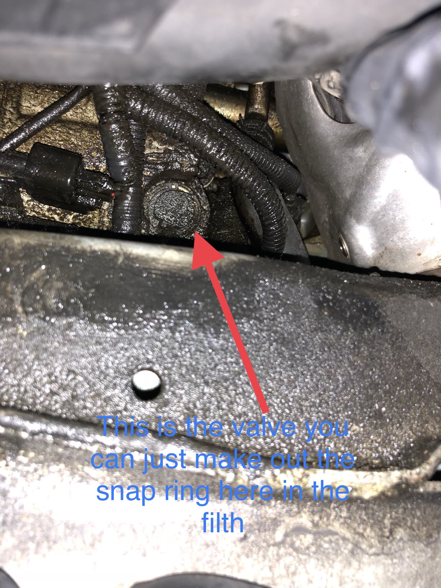

1. Remove metal skid plate - I realize that there should be six bolts total. But it wasn't apparent that the bolt that is mounted through the frame to the top of the skid plate brackets was part of it. I spent a lot of time searching for the third bolt on each side and couldn't even track down the diagram in VIDA. The bolt which requires your wrench to pass through the hole on the two brackets, a few inches from the two obvious bolts - is required for removal.
2. After dropping some parts at various times, It is helpful to drop the front portion of the plastic skid plate. This aids in your light hitting the compressor well without impeding your view at some points. I highly recommend using a light that isn't a flashlight or head lamp. I have those cheap metal foil work lamps from like wal mart which a regular screw in lamp.
3. Snap ring - the snap ring has to be squeezed together. Make the circle smaller. This was unclear to me based on someone else' comments and I spent a great deal of time trying to spread it....
4. Electrical connections. The screw is not super easy to get back on. Note the other cable under there rests over the screw hole before screwing the metal clip on from the valve's pig tail. Put all these together, try to get it over the hole and find a screwdriver you can maneuver that the handle isn't too fat. A 8" control size screw driver or a short thin handled one would have been nice.
5. The valve - My system had a vacuum on it because I wanted to test for leaks before I did all this. This made the valve a bit harder to pull. I eventually just pulled on the wires very hard and it popped out. I have no doubt having a vacuum on it made it worse because it obviously had to pull in all that air. I vacuumed again for a very long time
6. The large O-Ring that is seated inside the hole that the valve goes into - this took forever for me. I tried tiny phillips heads that are used for iPhone size screws, I tried every weird tool in a nail/vanity kit and eventually I ended up using a pocket knife that was about 6 inches long when open, get the right angle and dig it out. This was not graceful. Need something about 3 inches long or 8 inches long that will be tiny enough at the end to grab that o-ring and pry it out. Good luck.
7. Seating the new O-Ring - it wasn't easy but sure seemed that way after all the drama described above. Shove it in the hole and use your finger to pull it out in a way that makes it seat itself. No tools used here for me.
8. New valve seating - first put the O Rings on that came with it. Make sure when pushing it in, it is deep enough to get the snap ring back on.
9. New snap ring - sucks but you basically have to just get it in there. Snap pliers and a big flat head is how I did it. Use the pliers to get close then push with the flat head to pop it off the pliers at just the right place. Maybe others are smarter than me and its easy.
