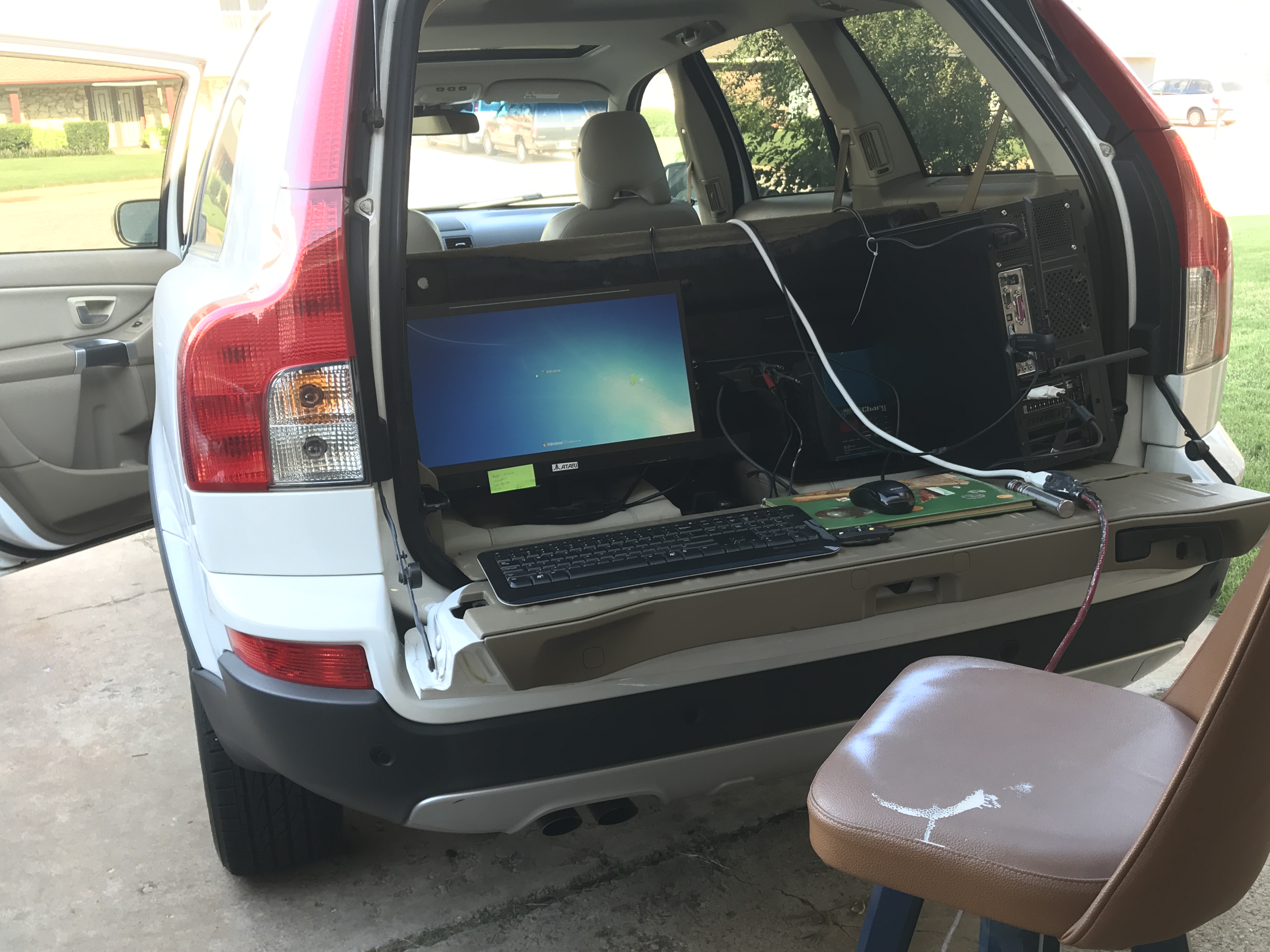

I can only get vida running on a Win7VM within win10. So i have to lug my tower and monitor out side...

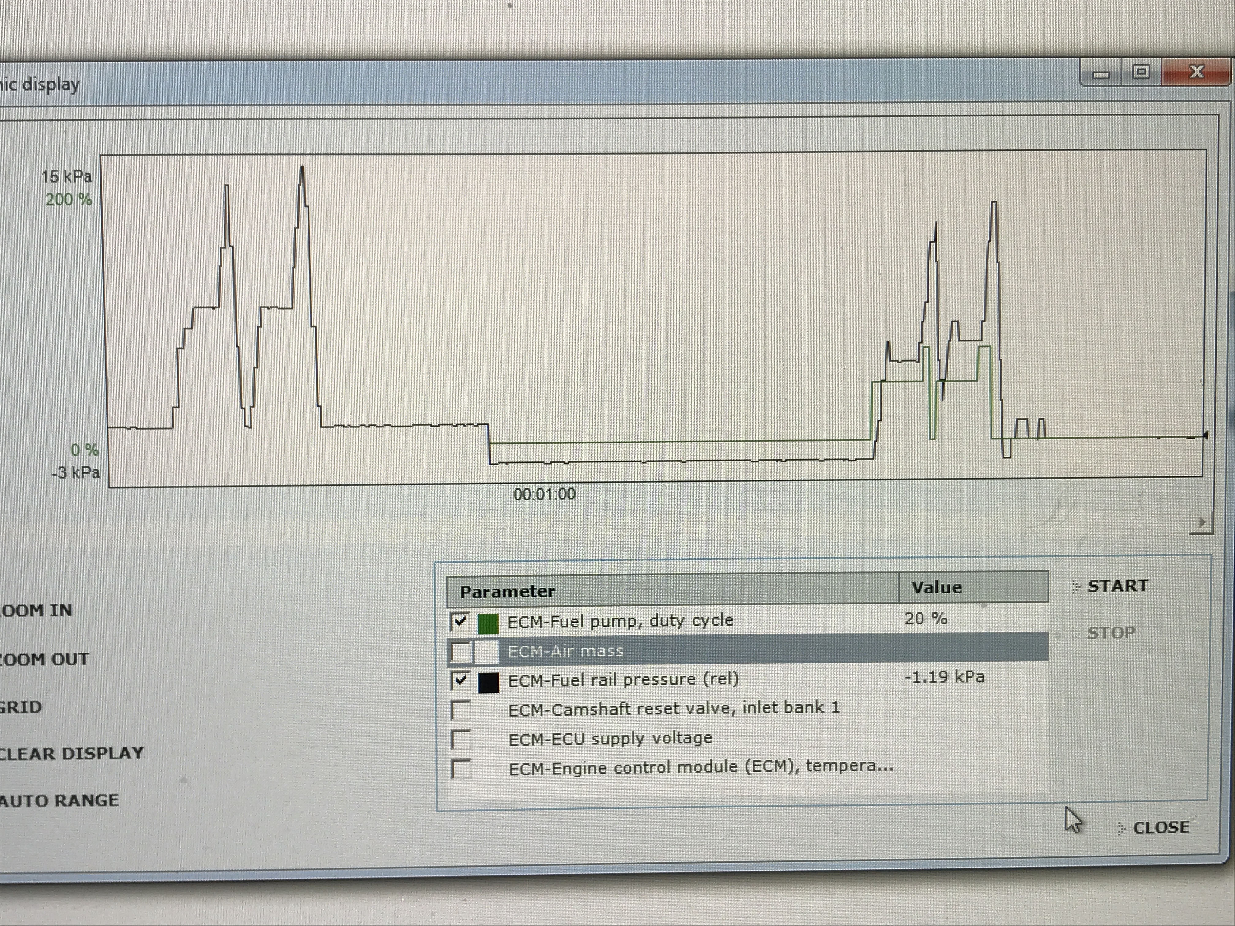

back out here again this afternoon, I tried to find anywhere in vida to test the coils. Still not getting DTCs when I try to start the car in vida. it did give me that first DTC again, RPM too low, I tried to start the fuel pump test in vida but my car needs an update that is preventing me from running the test. I did unscrew the valve on the fuel rail after I put the key in position II, NO fuel came out, just a pfft of air. I did attempt to start it with failure.

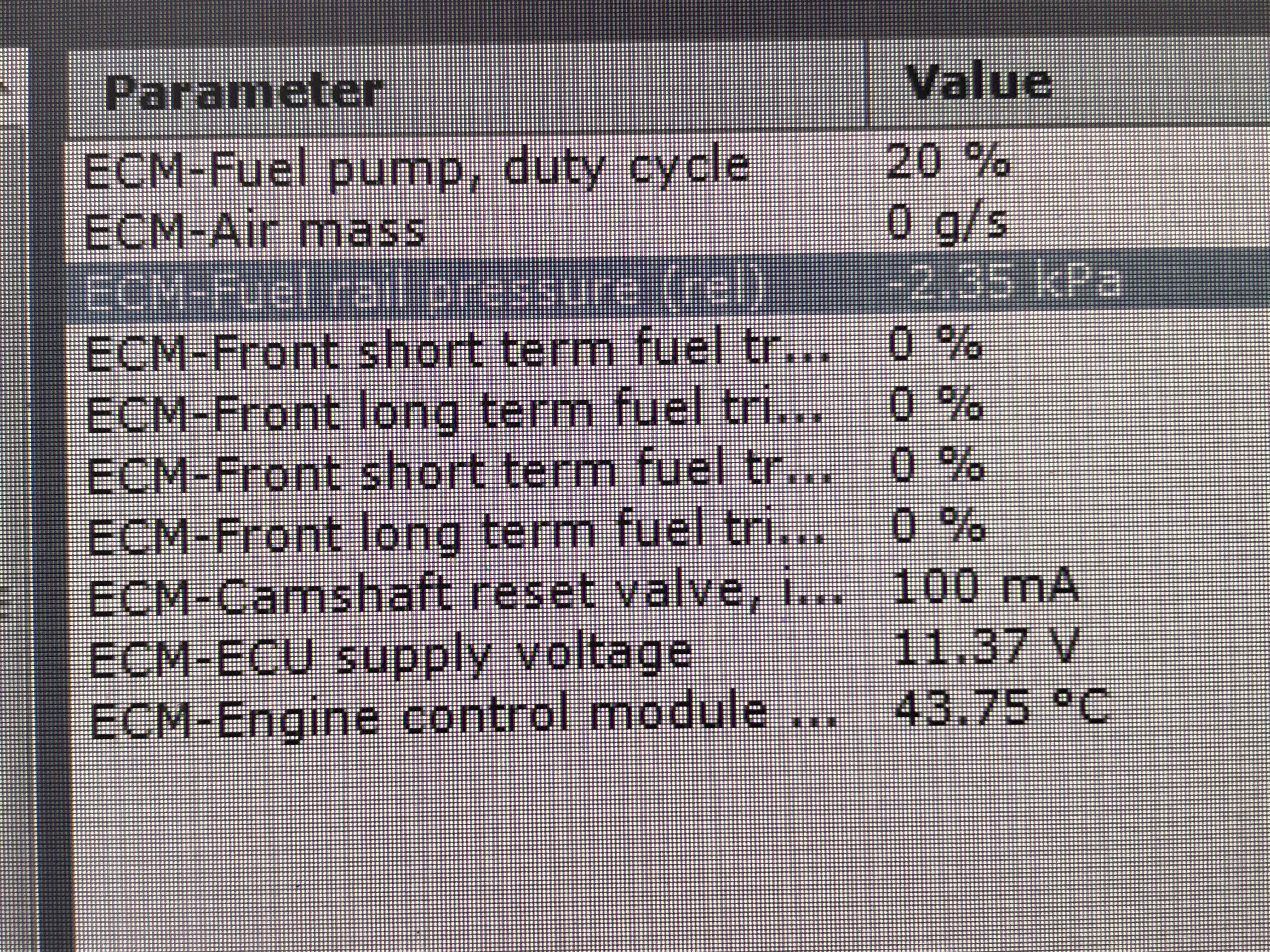

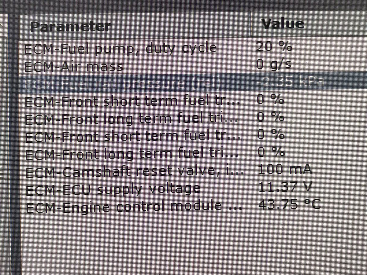

I got it to run today, but there is still a problem. Got a generic ODB code P0087 Fuel Rail/ System Pressure - Too Low Bank 1.
Didn't have Vida hooked up. Will do that tomorrow.

I finally got it turned around in my driveway but had junk blocking the garage, cleared the garage enough to fit it in and now it wont start again. so its still stuck outside. My driveway is fairly steep, the fuel pump does pump fuel but i'm not sure of the pressure. I just need the car in the garage so I can comfortably hook my dice unit to it. I have access to the garage and have the USB wire through the wall into my office connected directly to my PC. If i use any kind of USB extenders vida can't read the dice unit. It reads it most of the time but it has crashed in the middle of connecting to the car computer and that scares me to death. But I also can't stand lugging my PC and monitor outside every time I have to run diagnostics. I might try and get an old laptop and try and find a win7 pro key, but the only way I get vida to work is on a virtual machine within win10. I found the installer somewhere online and bought a dice unit. I'm still trying to learn the features of vida, but I also don't want to brick my xc90. I will get this beast in the garage without destroying it and run diagnostics on it again.

So I finally got to changing out the fuel pressure sensor and it wont start, exact same symptoms. At least I can rule that out. Now I'm not sure if the pump will engage while the fuel pressure sensor is removed, but I turned the key to position II and not a drop came out of the rail. I can't use that fuel pressure kit I bought from amazon unless I take off the engine mount to be able to use the gauge.
