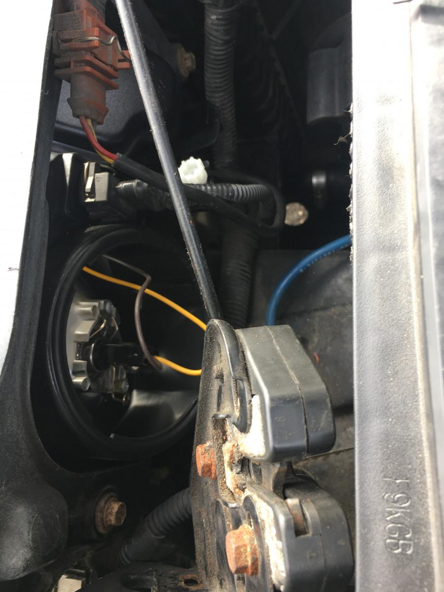

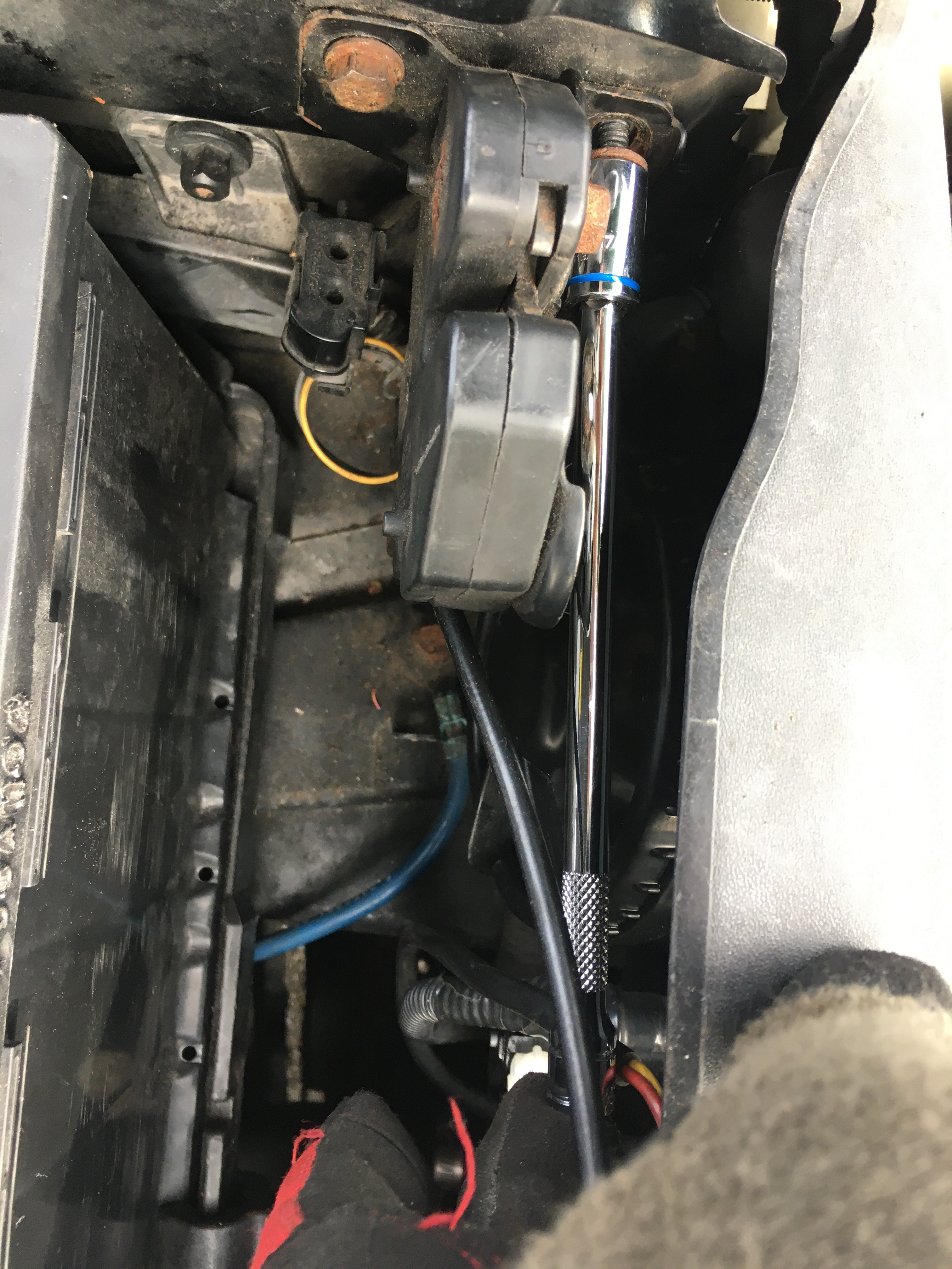

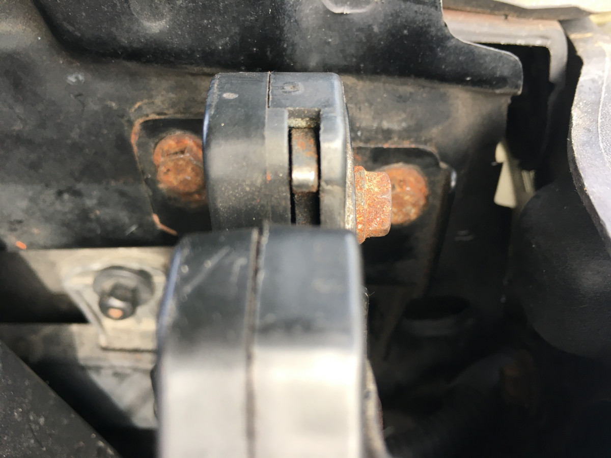

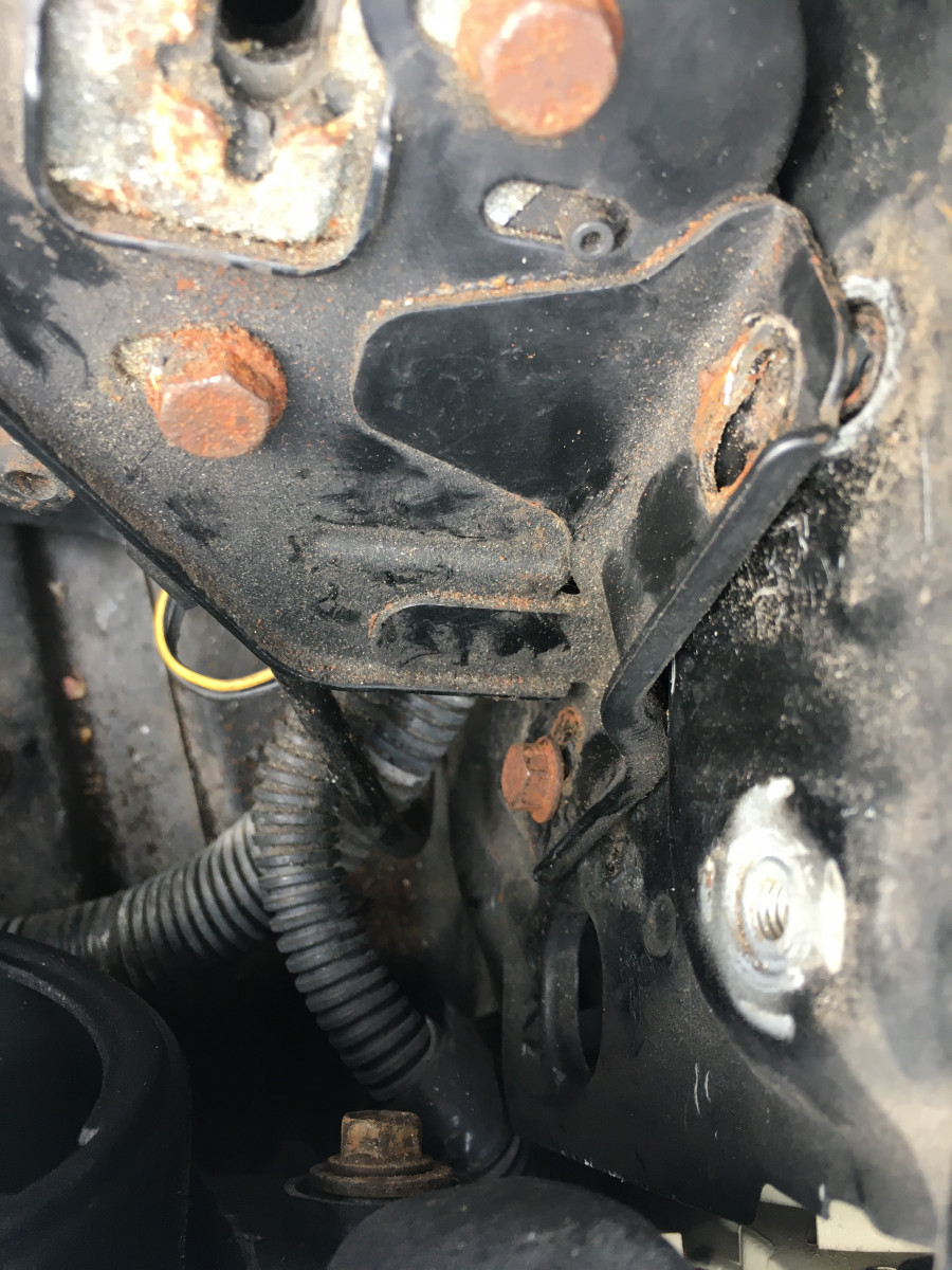

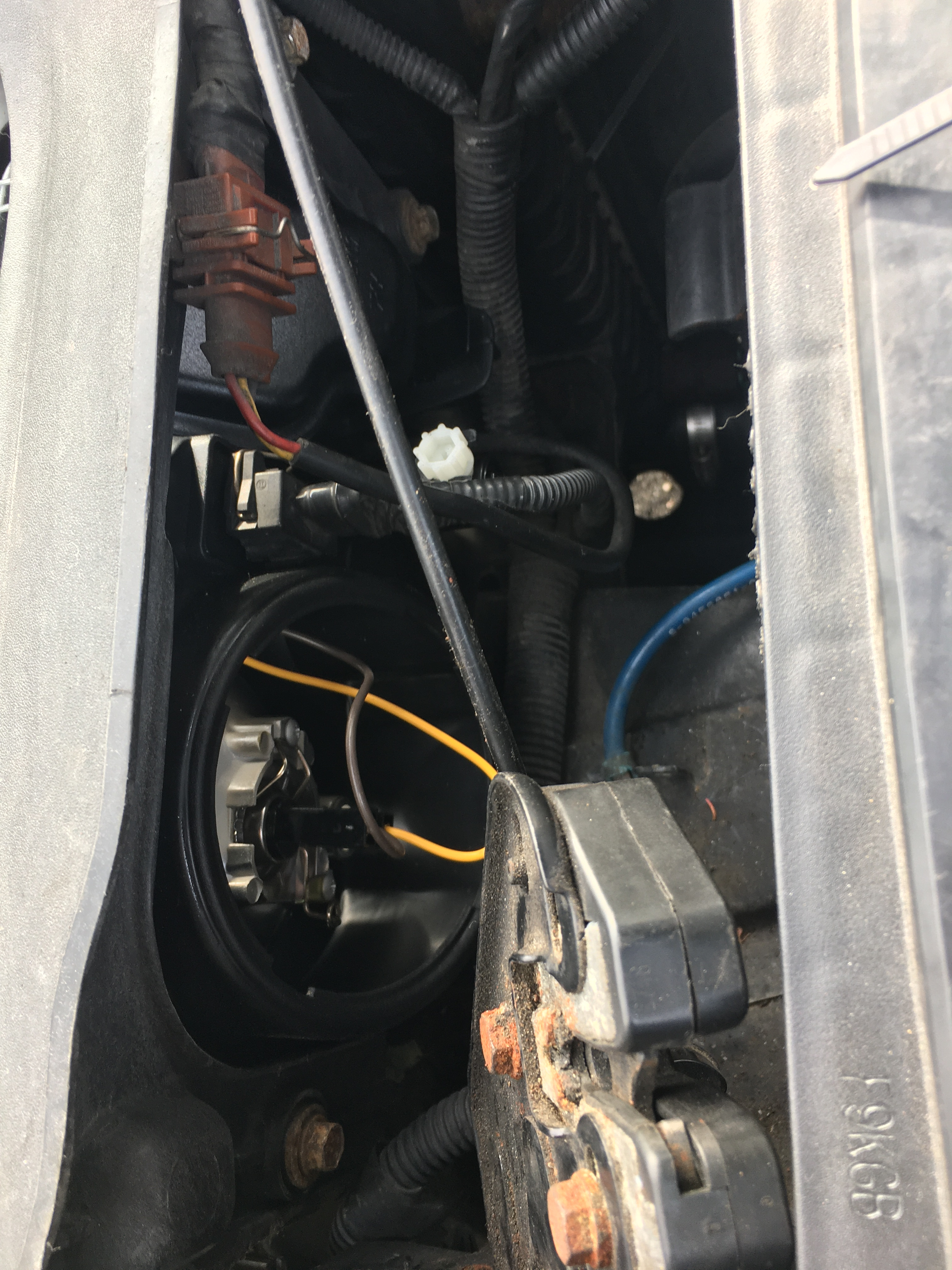

Why remove the hood latch? On my 2000 V70, I swapped the headlights without removing anything else (I'm pretty sure).

You don't have to remove the hood mounts. 3 x 10mm headed bolts having removed the sidelight carefully first (so as to not break the clip retainer). Headlight wiper arms turned perpendicular and out they come. 850 is a little more as you have to remove the little plastic plate below the headlight too.

I had only a few tools and couldn’t get my chunky 3/8 and 10mm socket onto those headlight bolts. I did come back in with 1/4 drive stuff and it was easier to access. A flex drive and a driver would be great for this job
