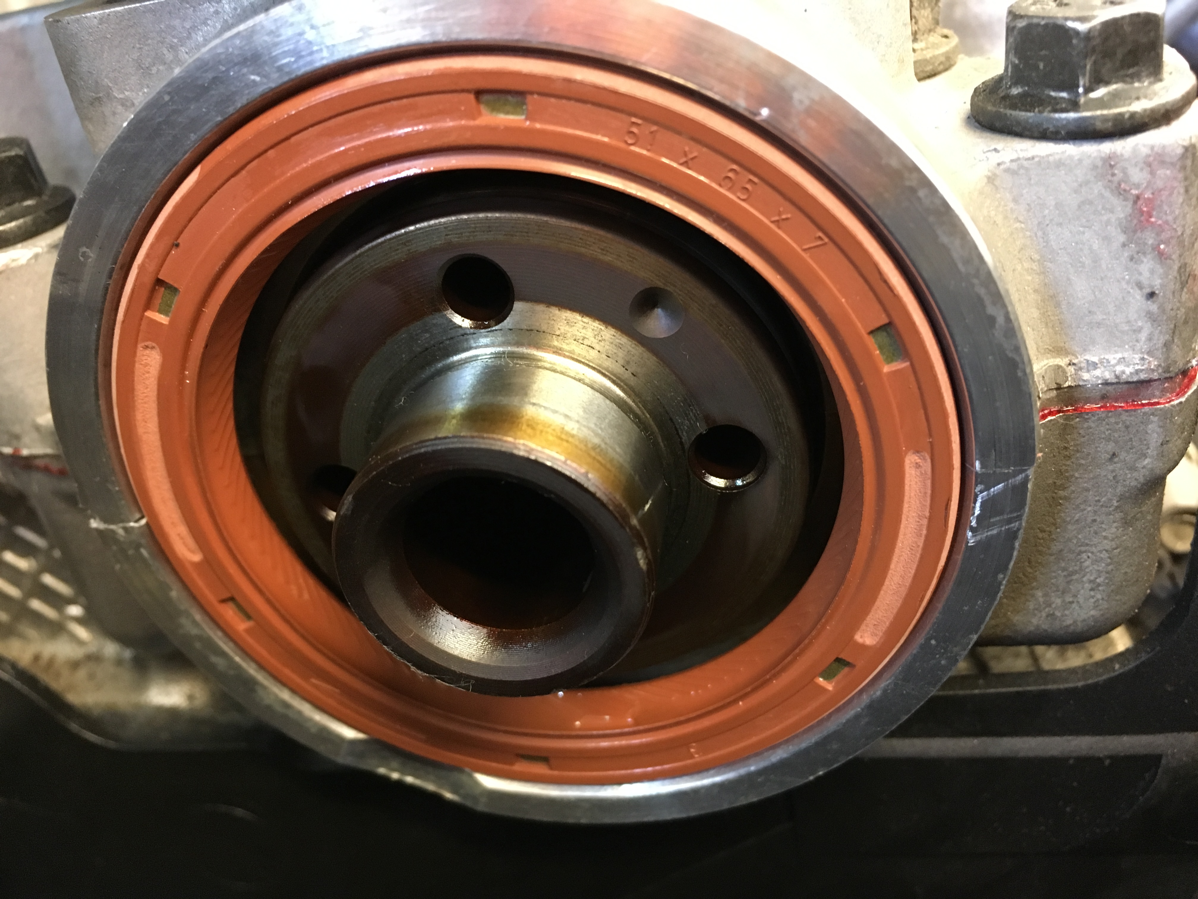

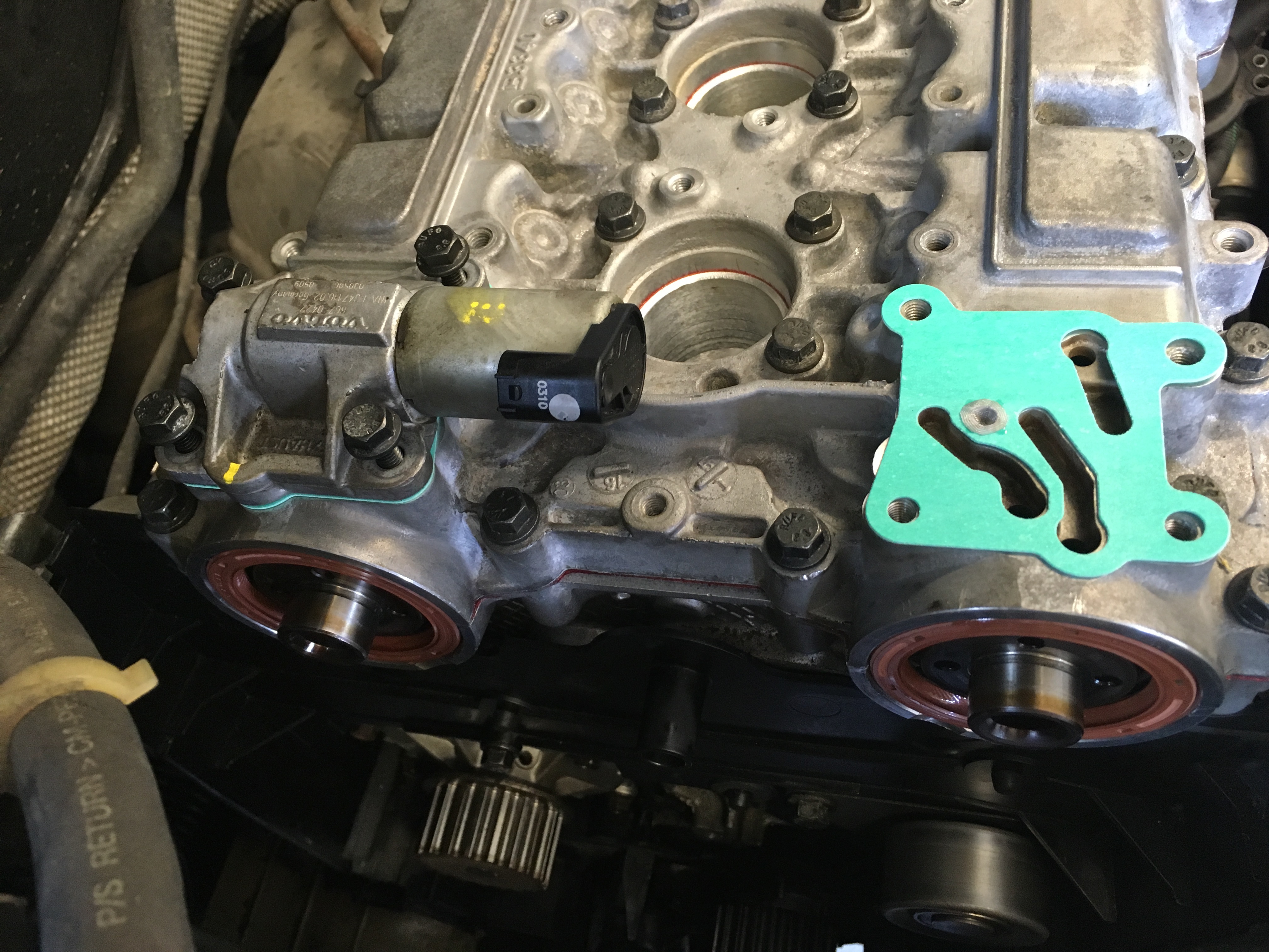

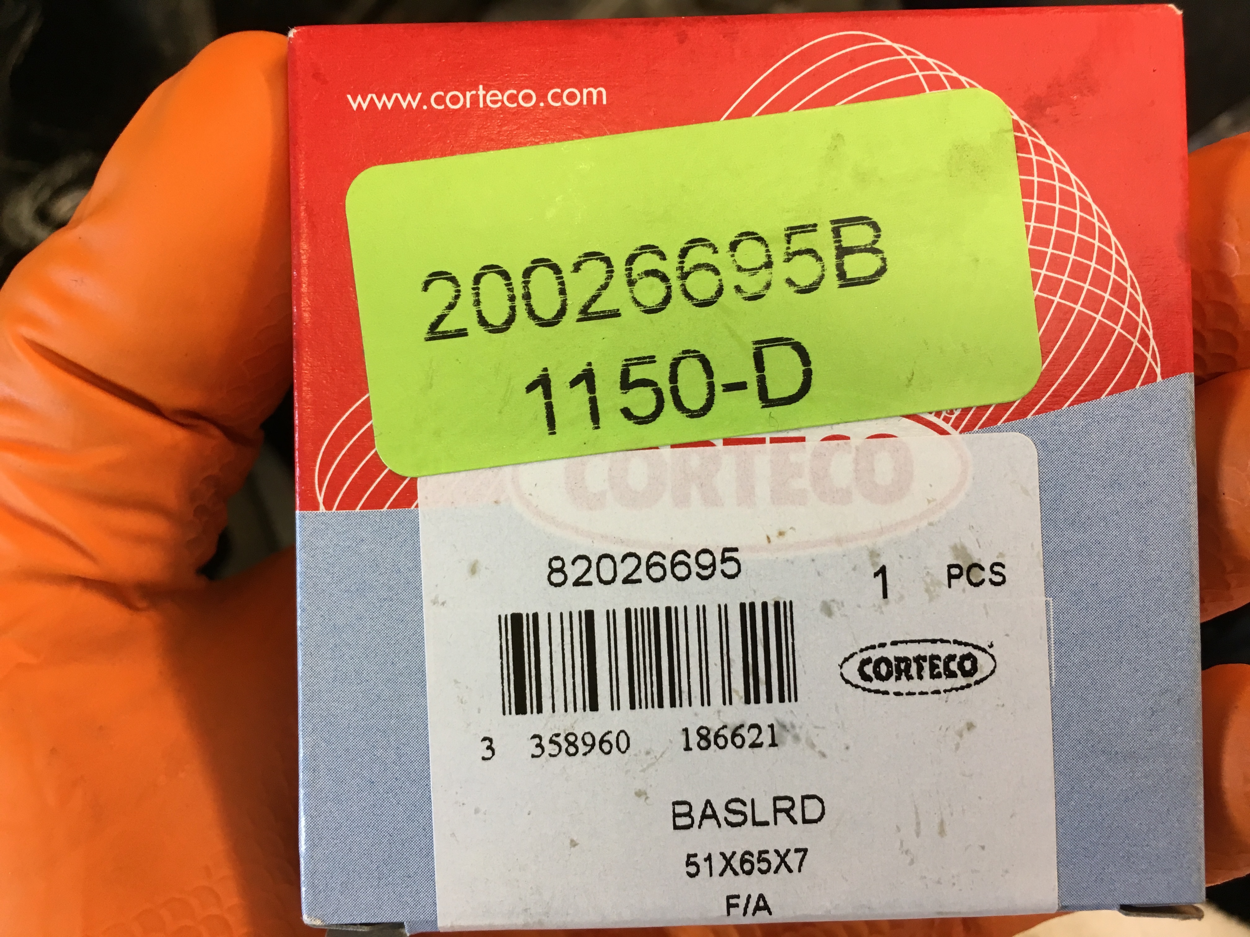

Also the VVT solenoid gasket(s) depending on the state of your solenoid(s).prwood wrote: ↑07 Sep 2018, 10:28You might also want to replace the camshaft oil seals since they're going to come out anyway. In my case I had done that recently as a separate job, so they were in pretty good shape when I went to reseal the cam cover, and I just kept the same ones.Cupojoe710 wrote: ↑07 Sep 2018, 10:21 I was expecting a lot more than just o rings lol. I appreciate all the help! As soon as my cam cover gets here I'll update on the process.

Nice job on the cam seals!
